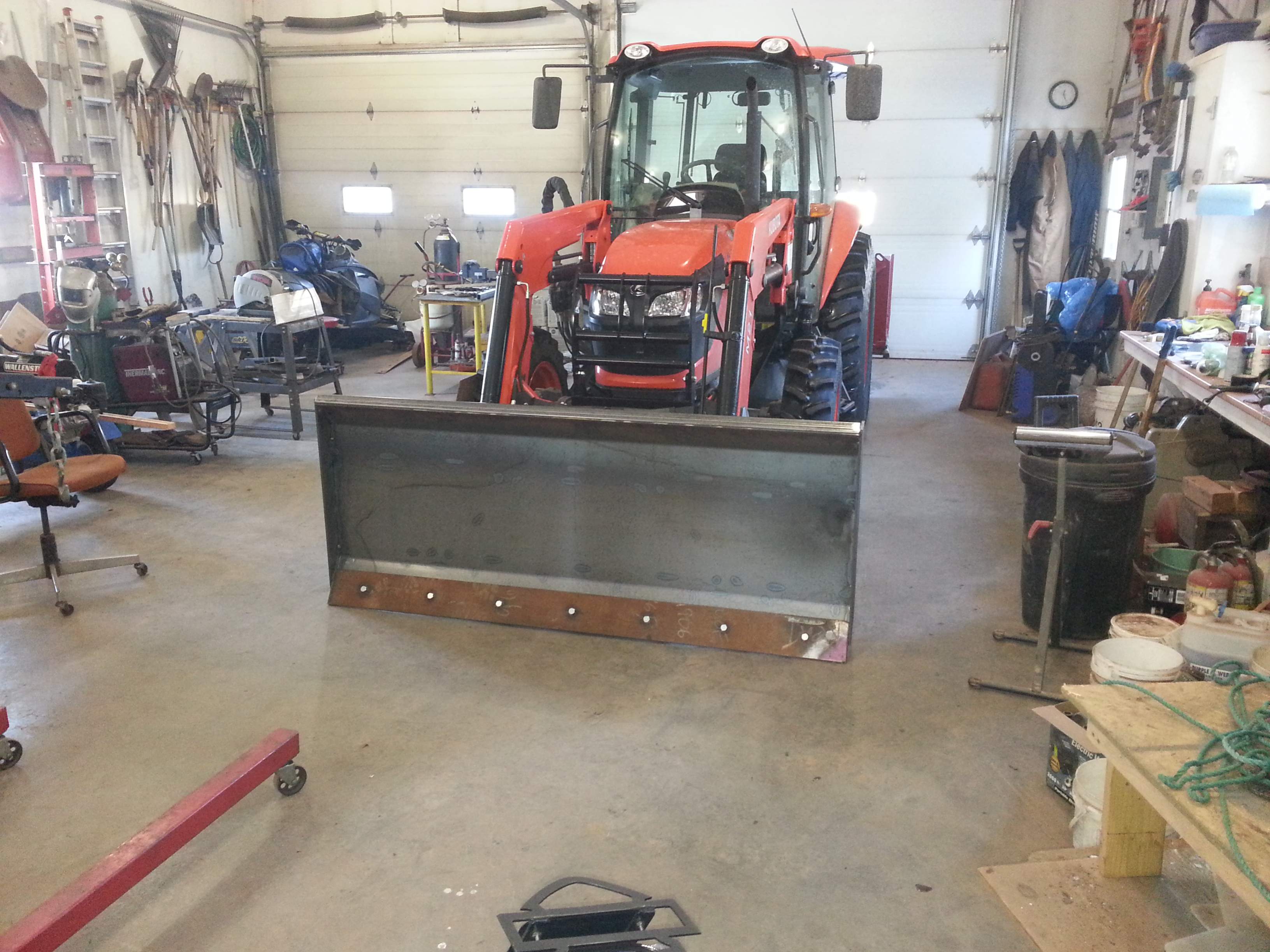

I've been wanting to build something like this for a while and after finally being able to use my new M7060 on Sunday moving snow I decided now was the time. I move snow commercially at 85 places ranging from small single car driveways to commercial parking lots of 1-2 acres and have been looking for something to speed up the process. As well as the new tractor worked it was pretty frustrating having so much traction and hp but only a 6 foot bucket to clear the large areas. So yesterday I started building a snow pusher. The main mold board is 34" high and 7 feet wide. Attached to each side is going to be 30" wings that are hydraulically adjusted 180 degrees. Hope to have this done in the next couple of days and i will post pics as work progresses.

Neither. Making it a fixed steel edge, Simple and effective as long as the operator is careful. I have used rubber edge pushers before and was very disappointed with there performance so it was never even considered. I have always just used buckets for snow removal which obviously don't have any trip mechanism so that is my reasoning for make the blade that way.

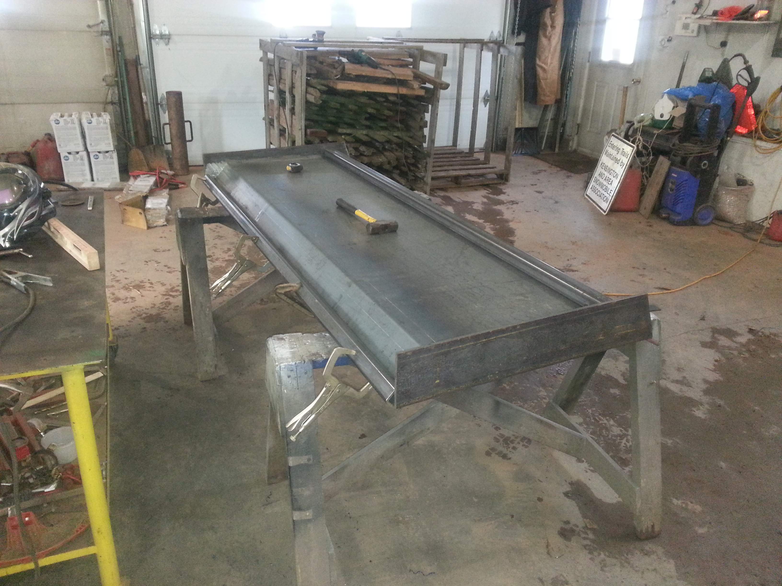

Bit more progress this afternoon until I ran out of .030 wire in my mig so I called it a day. Hopefully get the wings attached tomorrow.

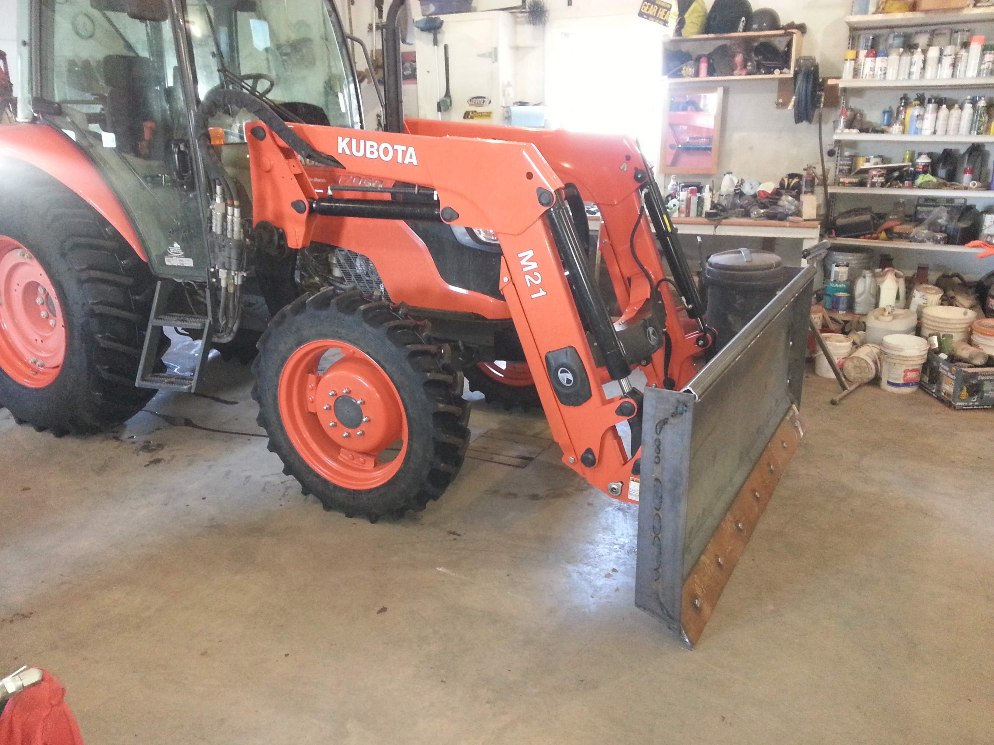

Side view. I was trying to keep it as close to the tractor as possible. 20150107_122612.jpg

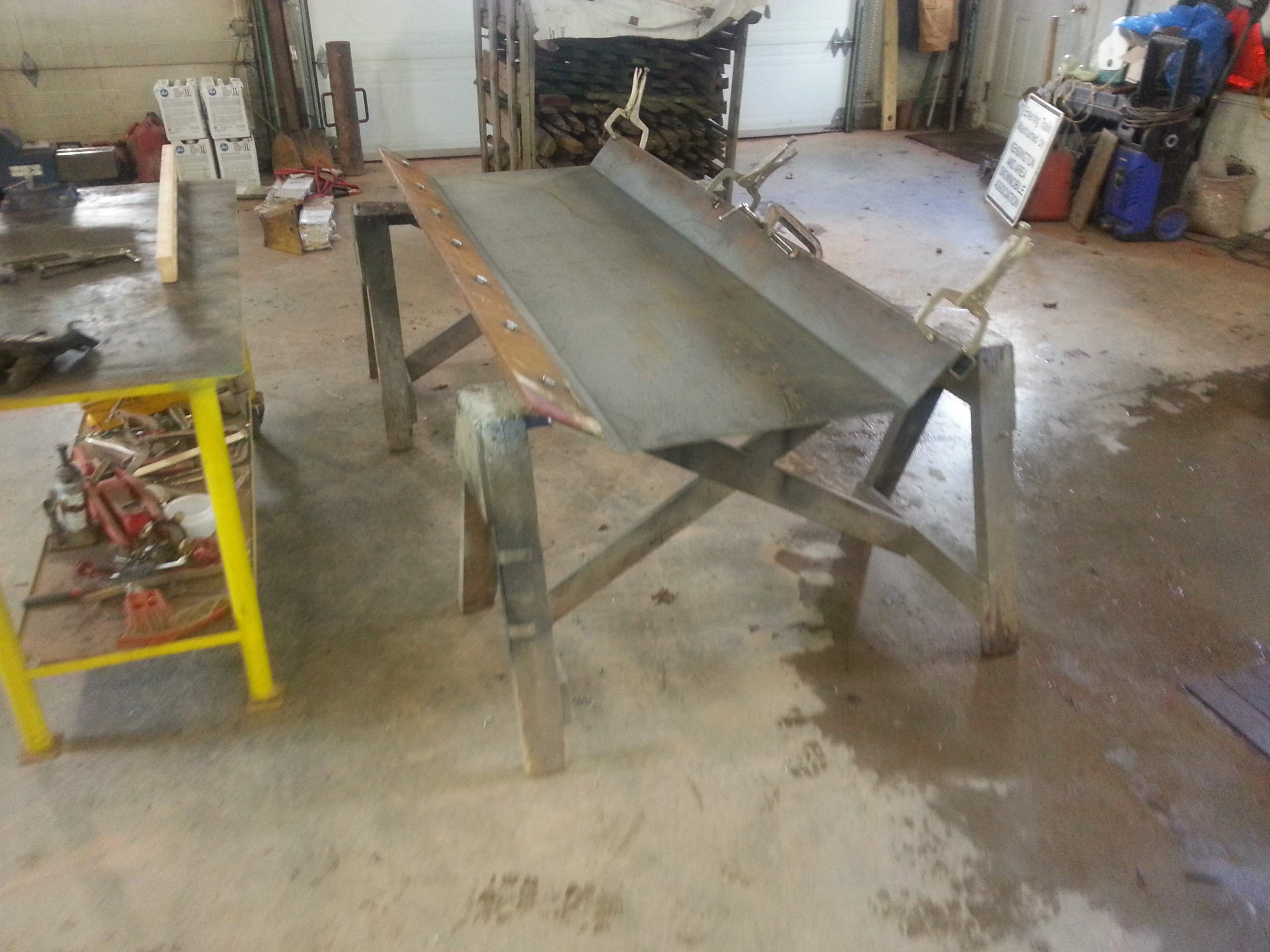

Finally got the rest of the material I need for this project. Had to wait a few days for the 400F Cutting edge to come in is why I've been held up. So I got to work this afternoon and got one side wing attached. The other side should be a cinch now so I'll get it on in the morning then get to work making them swing hydraulically.

The sides a way overkill but that's better than too weak i guess. 32" high by 30" deep 3/8 steel plate and the cutting edge is 6" ラ1/2 hardened steel. The hinge is 3/4" rod inside 3/8" wall tubing.

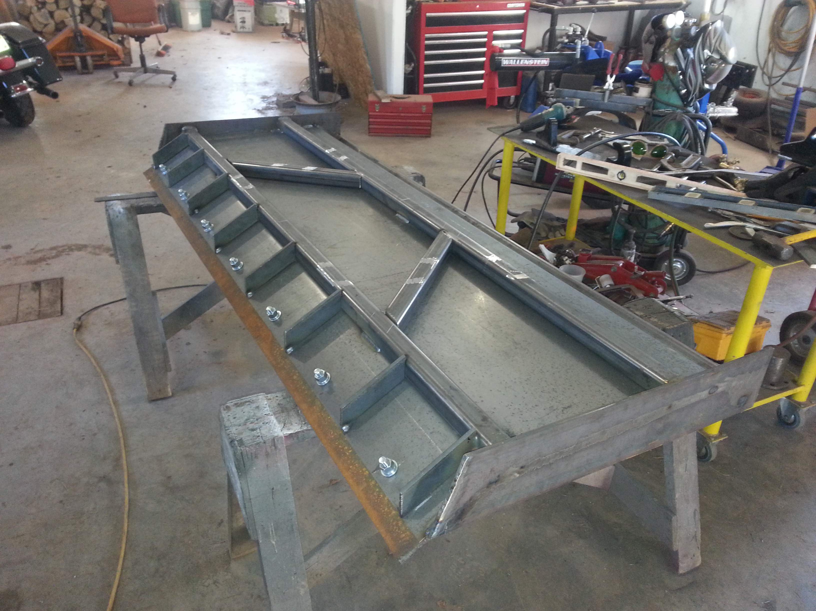

Been busy lately but managed make a bit of progress yesterday. Pretty much have one side buttoned up. Other side should be a snap now that i have a template.

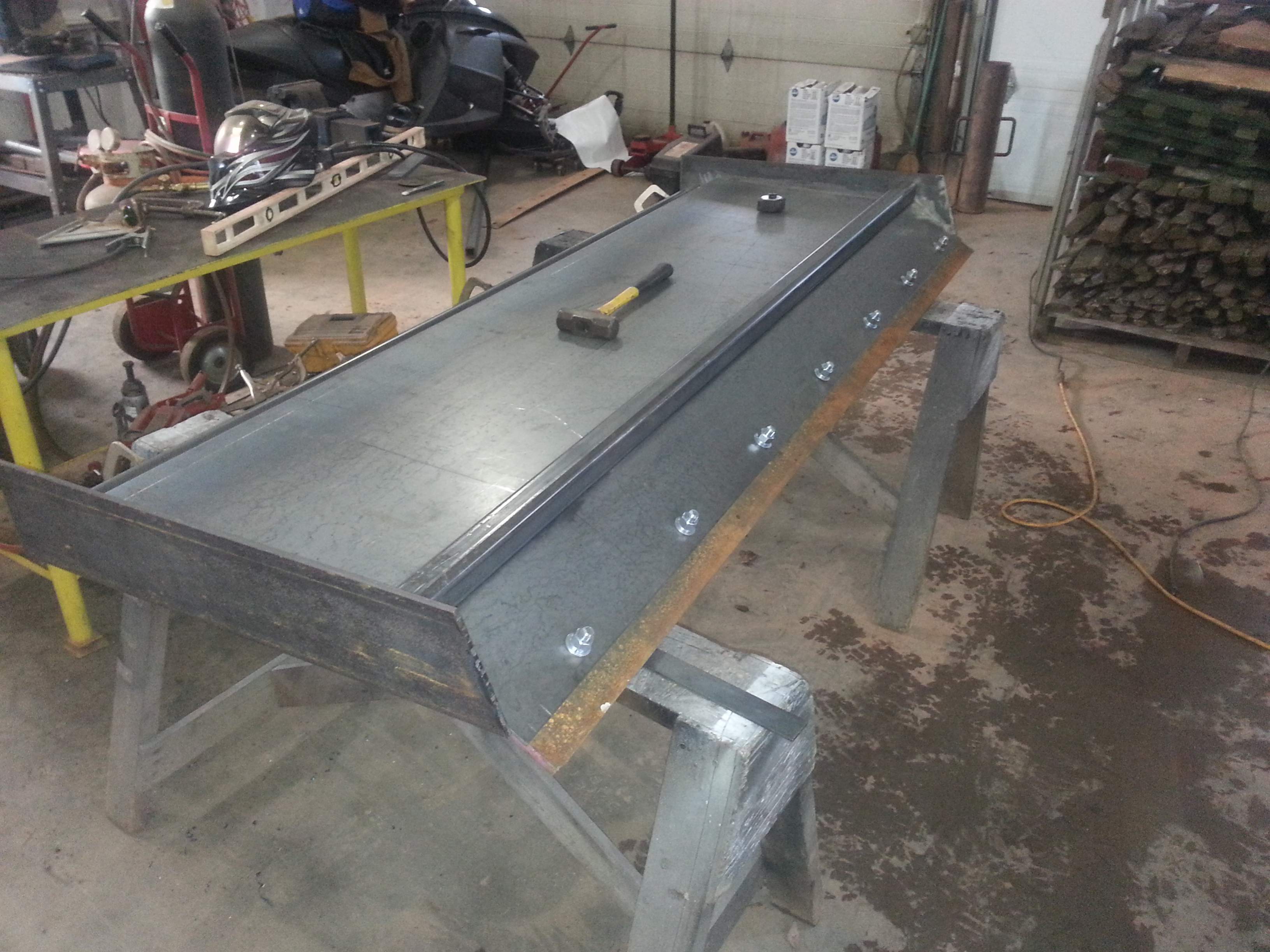

Bit more progress this afternoon. Got the hinges done on both sides. All that's left is to add some gussets and finish welding everything. Hopefully it'll see primer tomorrow afternoon.
