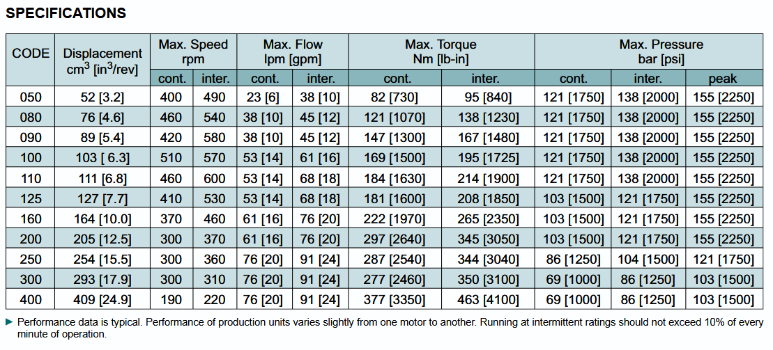

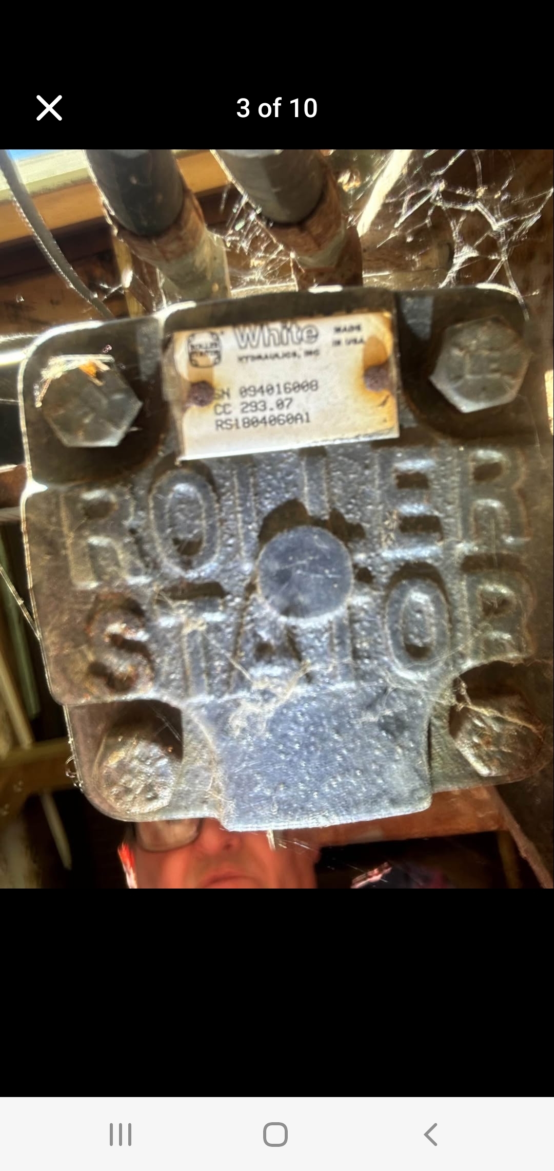

Here's a pic of the hydraulic motor. Does the cc293.07 mean that's the displacement? If so there's no way this will work. That's 17.9cubic inch. With 4.3gpm that would only be like 55rpm BEFORE reduction.

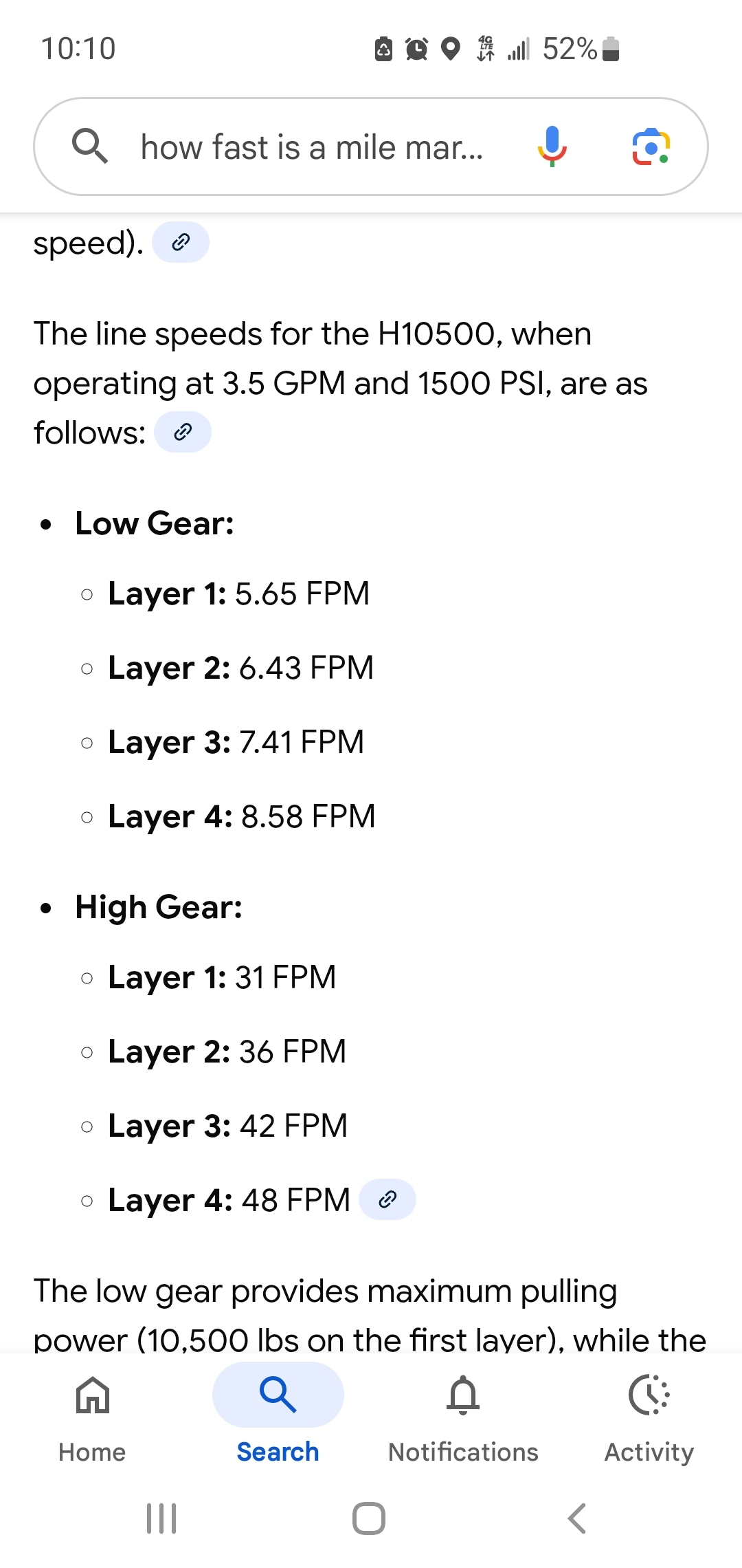

These specs are from the current H10,500. My tractors gpm is 4.3 so it should be slightly faster (at rated 540 PTO speed).

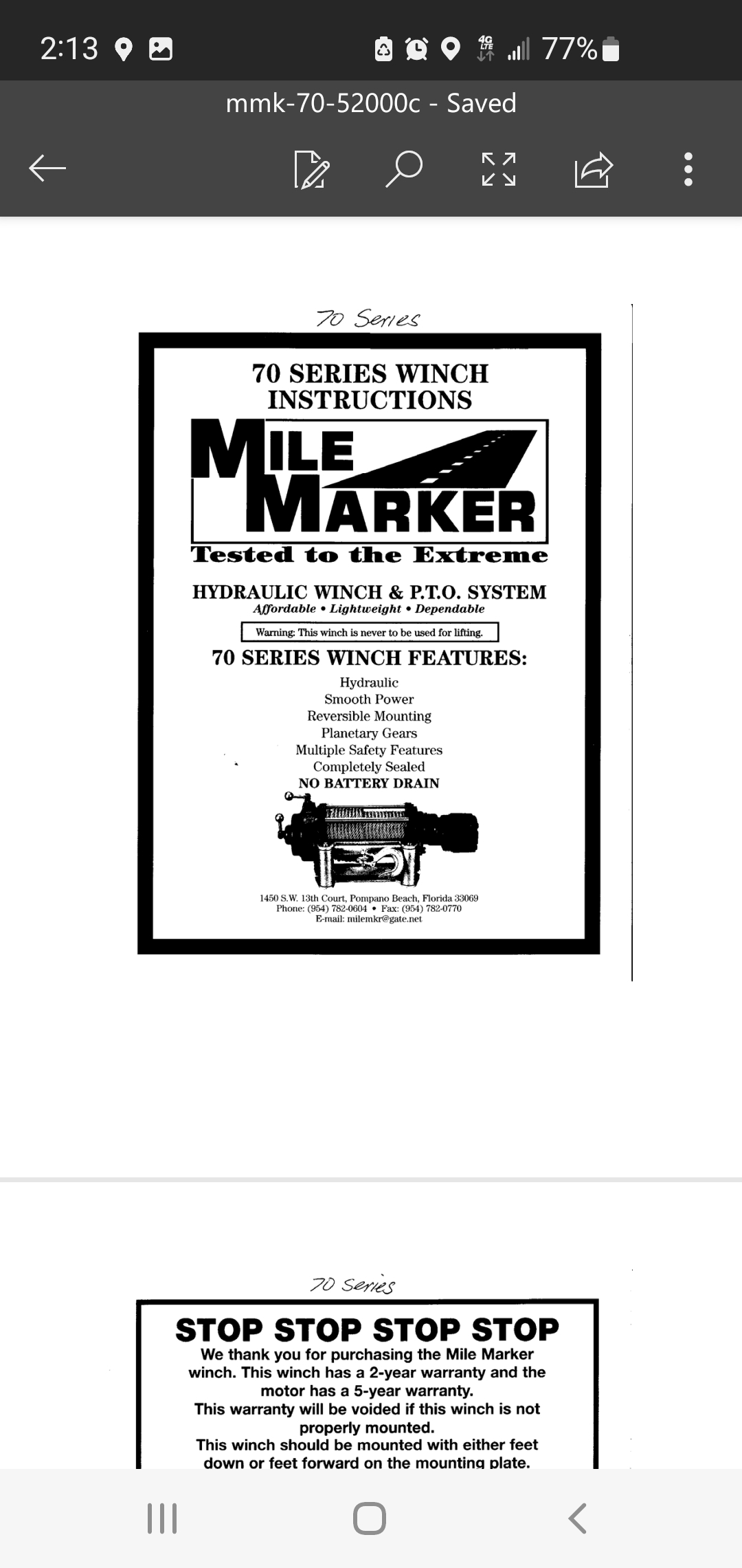

Well I bought the winch. Pretty good deal for $95 I think. Cable looks very good. I removed the hydraulic lines and blew some dirt our with compressed air. Reattached the lines and was able to scrounge some fittings to hook it up to my 3rd function. I left one line off and flushed the motor into a jug until it looked like clean fluid. Then attached both hoses and voila! It works! The gear shift lever for high speed moves a little stiff, but a couple taps with a wrench made it engage. 20251226_132020.jpg20251226_134624.jpg
I'm almost certain it's a Mile Marker 70 series based on the pics from this manual I found online. Screenshot_20251226-141351_Office Mobile.jpg
If so, based on the motor size (17.9³ inch) it's probably a 10,000 lb.
I believe the RS series White motors are considered their light duty line.
At 293.07cc that would make it one of their 300 series motors.
I believe your flow rate is going to be a struggle utilizing that motor.
