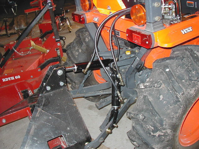

Can someone post a picture of a hydraulic top link? I used a boxblade for the first time yesterday and was humbled. Need lots of practice and from what you guys say the hydraulic top link will make it a lot easier to master. Also, what will one of those bad boys cost? I don't have any rear outlets. Will one do the job?
/ Hydraulic top link #2
Whew, Fullthrottle, there have been lots of pictures posted in the past, but I'll put one of mine on here again. Of course you have to have a valve, hoses, fittings, etc. I don't know what just the top link set up would cost, but for top link and one side link, I think you can expect to spend $800-$1,000.

The hydraulic top link will certainly make it a lot easier to adjust the top link without stopping and getting off the tractor to adjust it (or reaching over the seat). However, your comment that it will make it easier to master the boxblade, it may not happen. If you don't understand what you need to do to get out of the boxblade what you want, the hydraulic top link may just be more confusing and frustrating, thus more humbling, not less. Guess what I am trying to say, is that the hydraulic top link will not, by itself, fix a problem with the performance of the boxblade. Now when you say you need lots of practice, THAT will likely be the most rewarding to you and to your projects.
