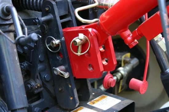

Any problem with using the top one for a snowblower?
Make sure that the blower can still float to follow the ground when using that hole. I found that my bush hog would actually lift one rear wheel of the tractor off the ground when backing through a low spot when using the upper hole on an 830 Case tractor.[/QUOTE]
Thanks! I'll check that.
Yep:
View attachment 524018View attachment 524019
You could make one to leave on the snowblower.
Looks good! Must have been a lot of work to make that.
