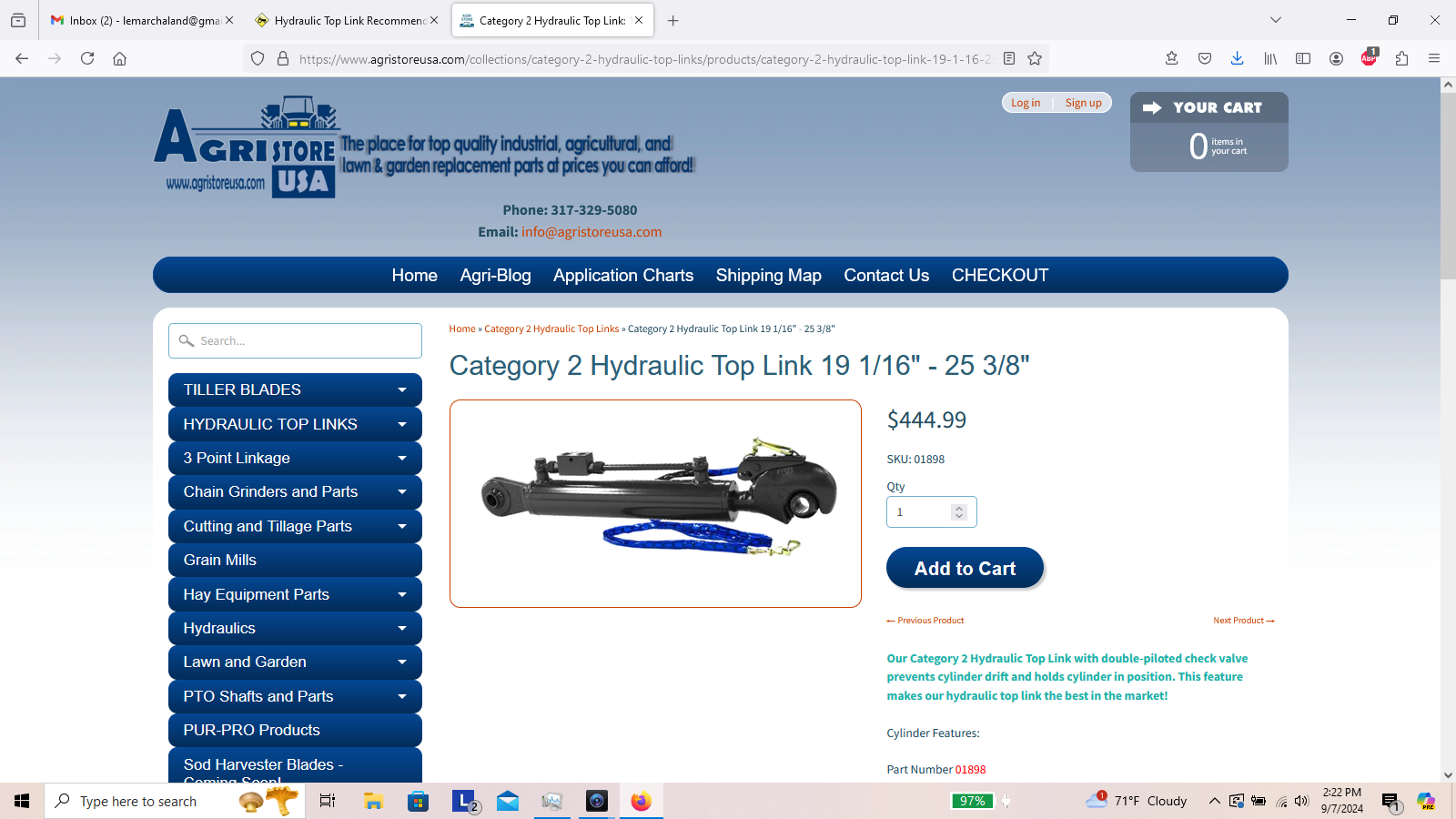

Are you looking for a cat 1 or cat 2?
What ever you end up with it should have the locking valves on it.
Then you have to decide what length you want, the following page has cat 1 ones,
Category 1 Hydraulic Top Links
Mine is a cat 2 and this is the style that I use;

Look at the following link. Get the asked-for dimension. That should be what your mid-stroke dimension would be, plus or minus.
I normally recommend a 3" dia cylinder with a 1 1/2" dia rod having a working length of 19 1/4"- 27 1/4". This seems to work well for this application.
Typically the 5000 series JD tractors do not have poor-quality control valves for the rear remotes (SCV in JD lingo), so a check valve is most likely not needed, but can be provided if requested. ;)

Hey LouNY. I was just looking at the same website and saw another model for about half the price. What size tractor are you using this on? I need something for a 50hp compact tractor
/ Hydraulic Top Link Recommendations Wanted #13
I'm using it on the Branson 8050, so engine 80 hp/ pto 65 hp and on heavy cat 2 implements.
If you are looking for cat 1 they should be a bit less.
Also you may like to look here;

Thanks. Looks like I’ll be fine with the smaller cat2 they sell. Did yours come with hoses or are those purchased separately?
/ Hydraulic Top Link Recommendations Wanted #15
I believe they came with it, but it's been a few years.

I have one from Agristore on my 4820 Branson. Great unit... I think $200 and some change with hoses. Great quality and fitment, made in Italy.
