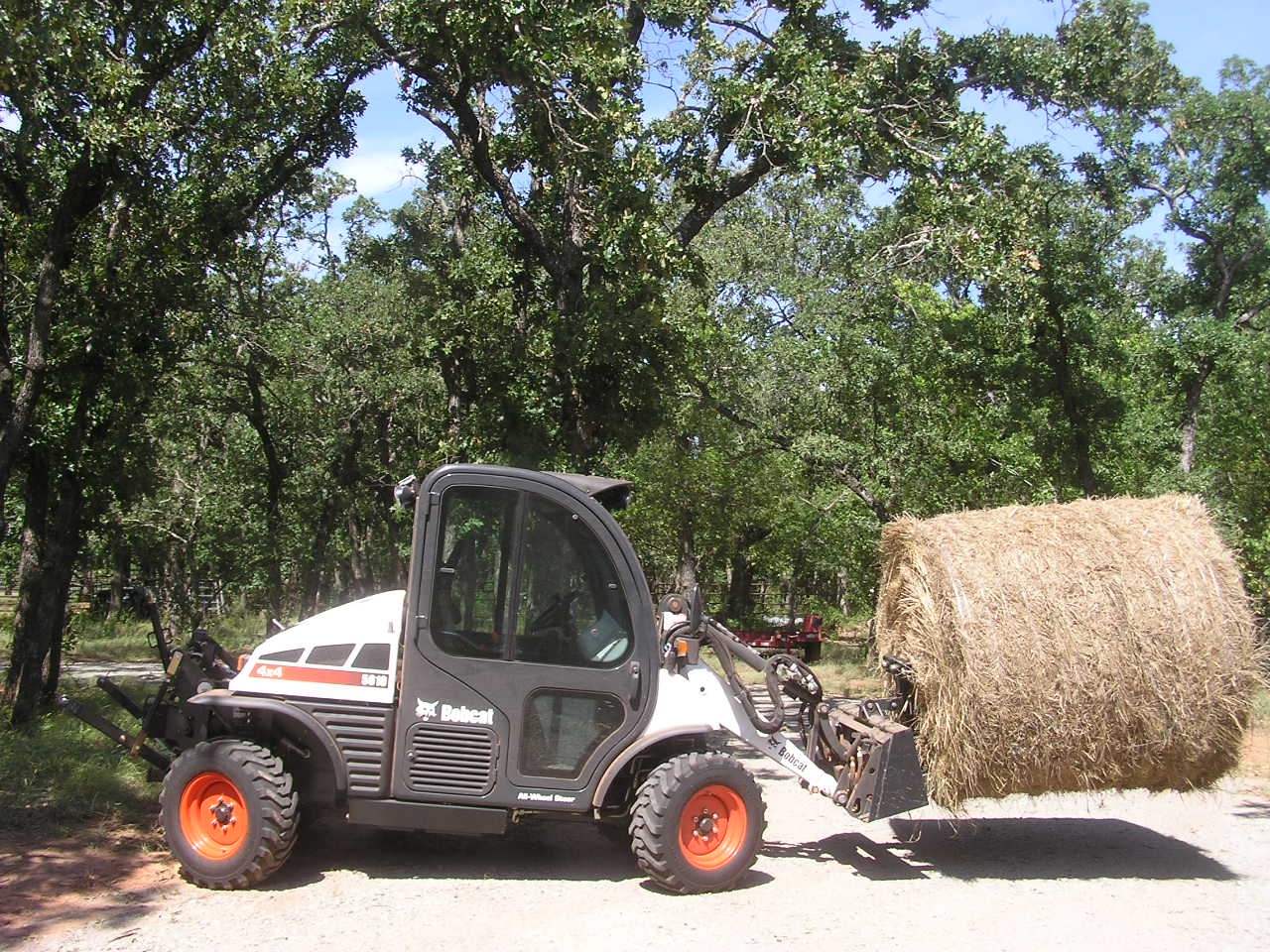

I've been cussing CNH products for years for not making a 3 point hitch system that comes up high enough to move hay bales reliably. 🤬
The issue is I can't adjust the top link to lift the bale high enough if the bale isn't really firm, or had a somewhat wallowed out center from being moved.
Here's an example. This is as much lift as I can get without cranking on the manual toplink after I've speared the bale...
If I leave the manual top link adjusted to lift higher, the angle of the spear is too severe to run into the bale.
A hydraulic top link ought to solve this, shouldn't it?
Have any of you used a hydraulic top link to get the 3 pt hitch load higher?
Just seeking input before I order a new hydraulic top link. Preferred manufacturer?
Thanks!

Sure you have the right lower links ? If they were longer, the rate of change of angle as you lift would be less. But from the looks of it, your top link is way too long. Plus the top link hole position isn't shown, but that also affects the rate of angle change. It's just a simple 4-bar linkage....
I'm pretty sure I have everything set up to get maximum lift. ;)
Aside from the 3pt hitch itself, there's a knob that allows some adjustment on hydraulic lift with the lifting arms which link to the lower arms.
Yeah, you are right, The toplink is extended because when I retract it, the point of the spear is tilted WAY upward, and won't stick into the bale right.

It\s hard to see on your picture but if the bale fork has a hole above what you are using now use it. Usually there are three holes for the top link on the tractor. Make sure the top link is in the bottom hole. Setting up the top link like that will tip the bale fork forward as you lift which might be enough to solve your problem.
/ Hydraulic Top Link? Moving Hay~UPDATE! Problem Solved!
Toplink mount has 3 hole settings. I'm in the bottom one.
The bale spear itself is for Cat 1 or Cat 2 either one. The pins are on top of each other where the top of the toplink mounts. I can use either, but either one doesn't make a perceptible difference in lift height.
For some reason, in my experience, anyway... CHN tractors keep the implement level when raising. My old Mahindra would tilt upward when lifted, but CNH 3 point hitches maintain the same pitch throughout the lift. (That's probably desirable in the world of ground engaging implements, but the only thing I use a 3pt hitch for is hay moving and occasionally my gopher machine and rarely a post hole auger.)

As has been mentioned, use the top pin location on the spear and the lowest pin location on the tractor side.
I would think that that would get you at least another foot of height at the end of the bail.
Looks like a longer bale spear would help.
Mine is 48 inches long:
A 5x6 bale:

My rear spear has a 48" spike and two shorter ones. But my short ones are underneath the main spike.
I just think I can get as much lift as I need with the hydraulic top link. Should solve the issue.
I don't have trouble with the front loader spear because it has 2 48" spears and as much lift as I wanna give it.

Got a hydraulic top link and installed it today on my PS120...
It lifted up just as it should and solved the issue! (y)
I swear, tractors ought to come with these as a standard top link!
Think I'm going to get another one for my PS75 so I won't have to swap them out.
Before:
After:

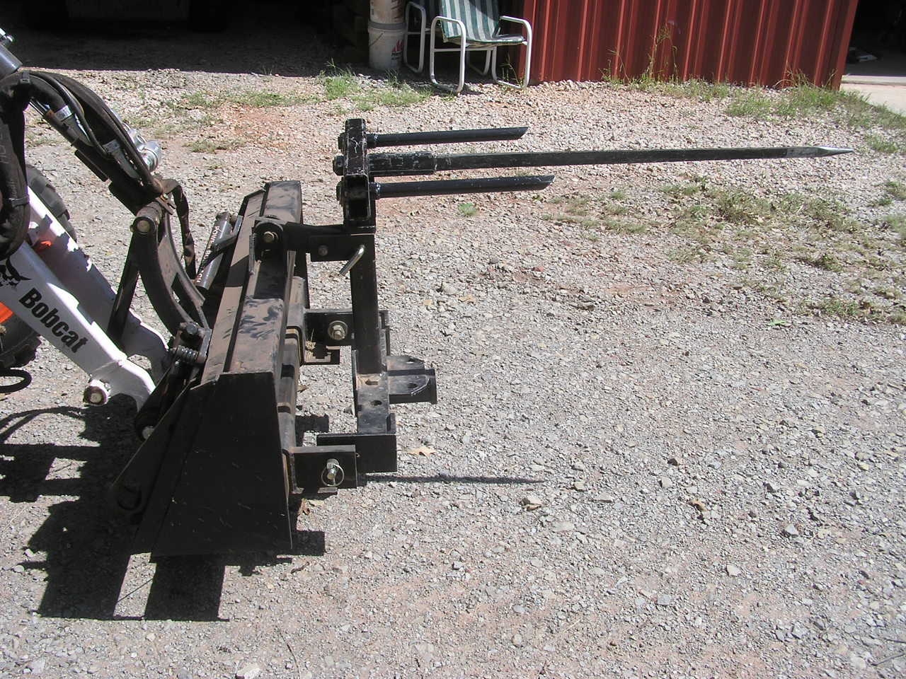

I am late to this party but will offer another solution that I used. I cut the 3X# tubing on the hay spear above the spear and added a 6" extention that increased the distance between the top link and lower link pins. This will make the spear angle up as it is lifted. Might be a cheaper option than a hydraulic top link especially for those only needing HL for one application. And yes, one can buy a short piece of precut metal on Amazon!
