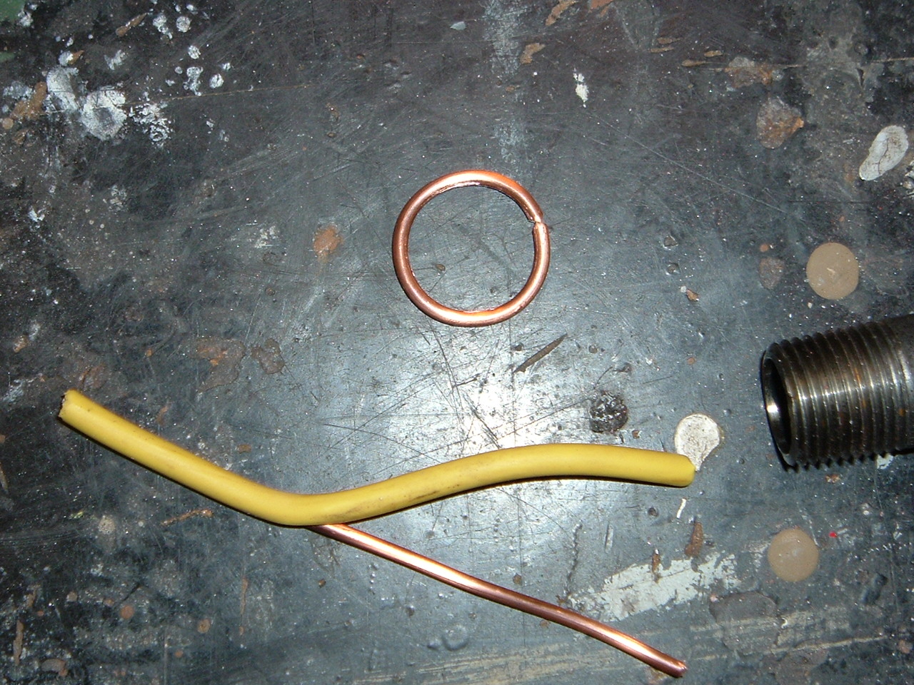

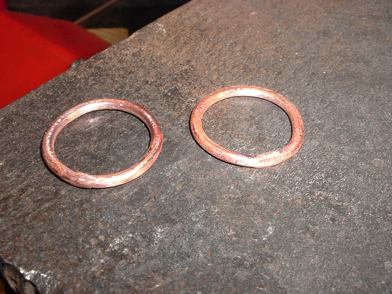

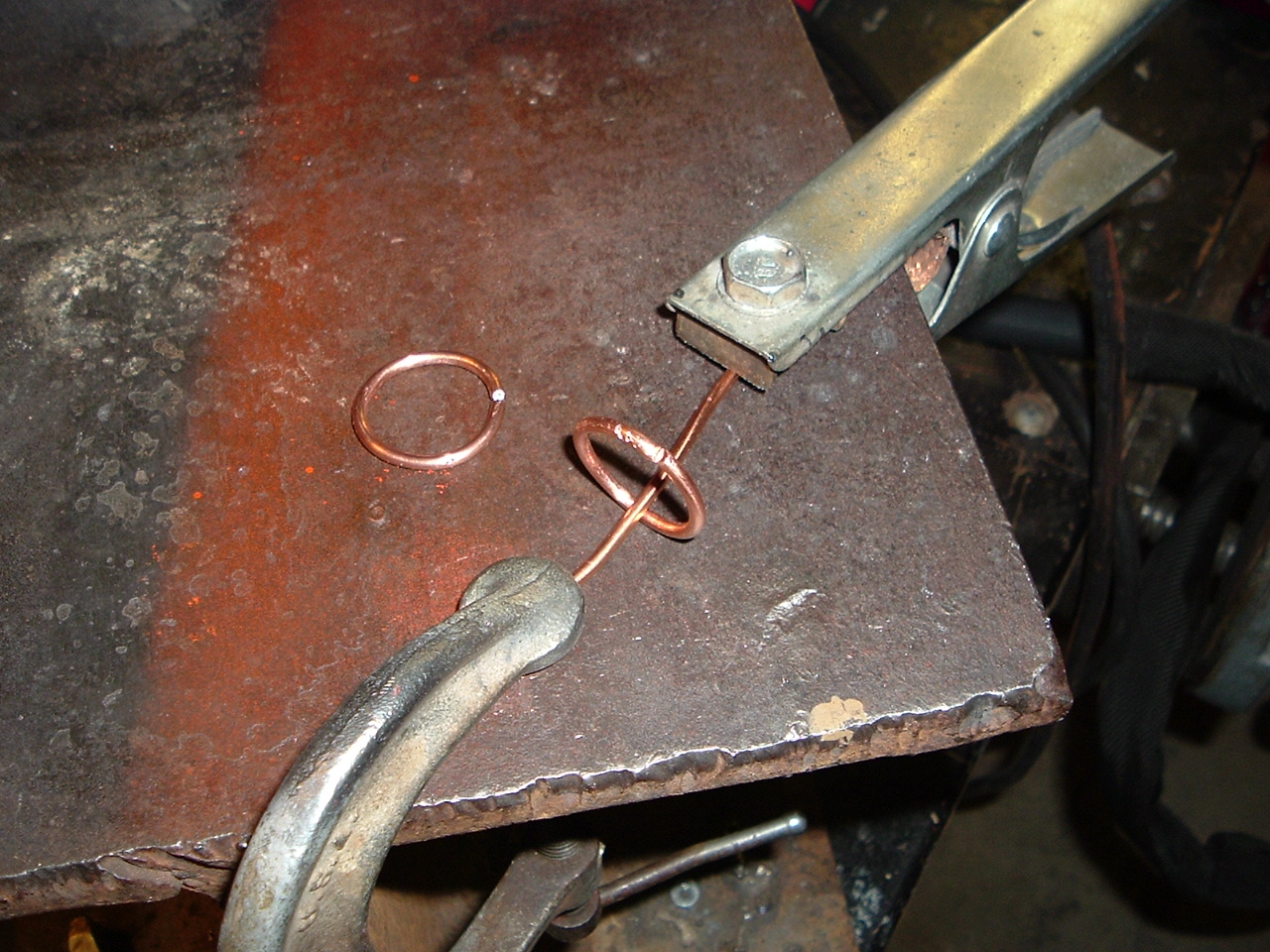

You could make one pretty quick if you can TIG weld. I have made them before out of copper wire formed over and appropriate mandrel like a piece of pipe or the original fitting. Once the ends meet you can TIG weld the ends together using smaller copper wire as filler rod and then file the ring smooth.
