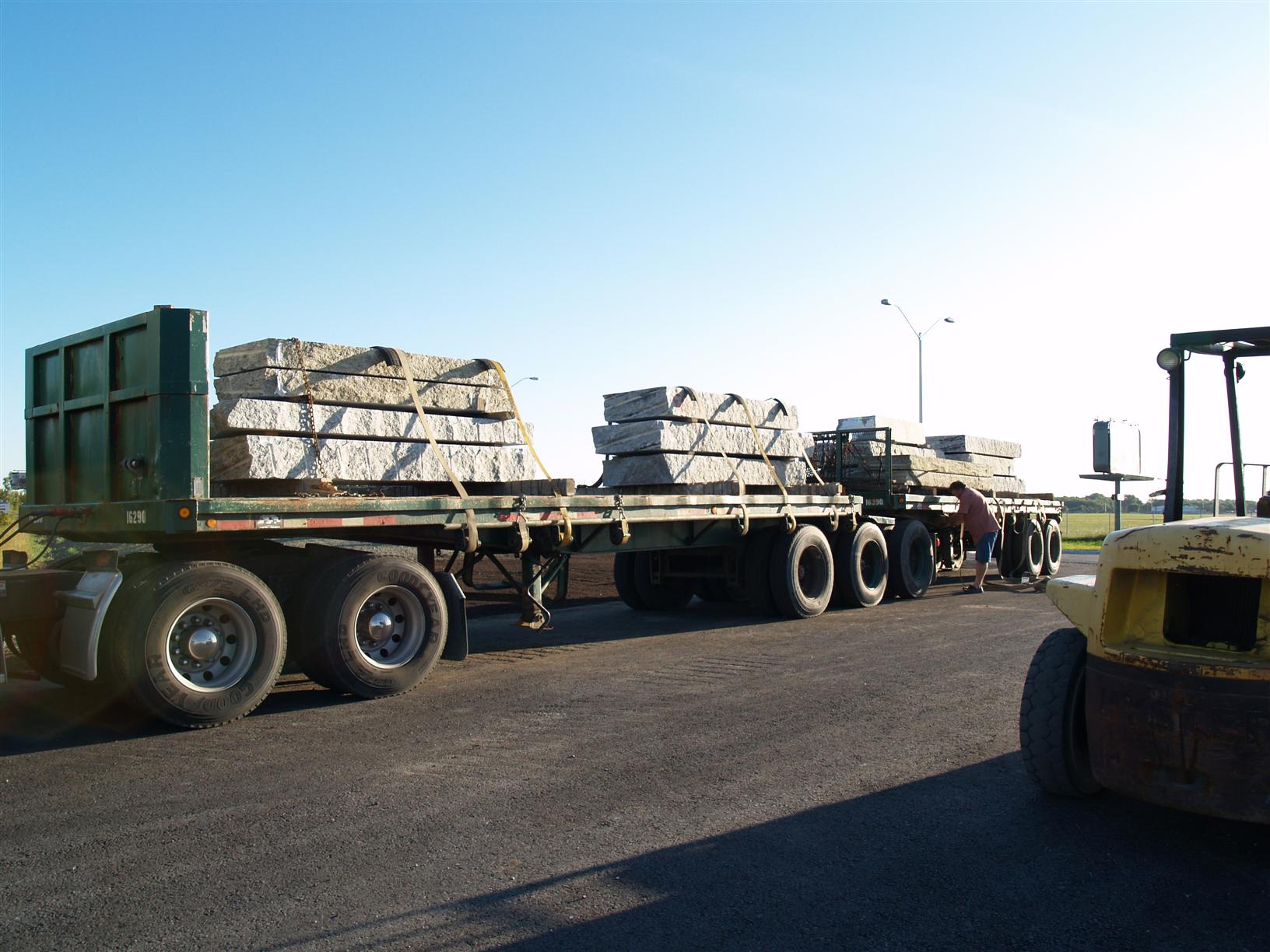

I wish I had my own quarry. No I have to pay for it. It comes from a quarry in Stanstead Quebec (I'm in Ottawa). Cost (in sawn slab form) ranges from $17.50 to $22 per square foot for 8" to 12" slabs. Yes you buy it per square foot even though you are buying a volume. They quote based on the square feet of ONE sawn side.
This was the day I was questioning my sanity (see attached pic)

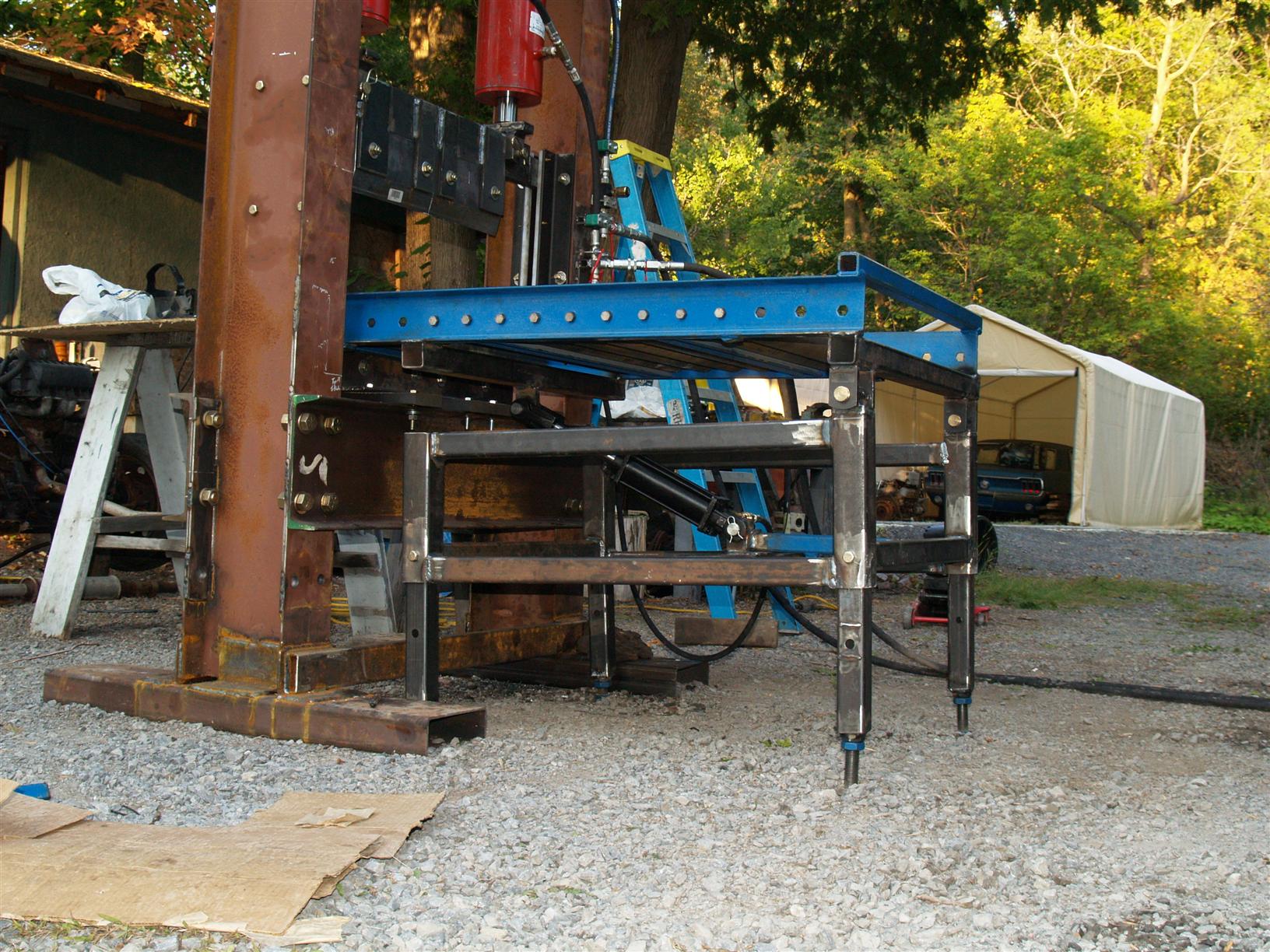

I took one look at the NICE machine, and wondered about that roller bed. Those two HUGE cylinders have got to produce more energy than the 5/8 or 3/4 inch rod that supports the rollers is going to be able to stand for very long. Short term fix might be to set all of your slabs on a piece of flat steel to spread the weight/energy around to prevent bending the ones right there at the impact point. Long term might be to install bearings/bushings around a solid piece of round stock the same size as the rollers themselves. I watched the video and saw the roller bed move. Was it supposed to do that? I wanted to read the whole post before putting in my two cents worth.

The rollers don't take any of the force from the cylinders. There are two blades, an upper (what the hydraulic cylinders are attached to) and a lower blade. The lower blade is stationary. The table pivots at the rear and moves down (by gravity) to expose the lower blade. When the main cylinders are moving up, a cylinder under the table moves up to return it so the surface is just above the bottom blade. Look at the video which has the night time shot, there you can see it return to level position after the split. I've attached a photo showing the underside of the table.
