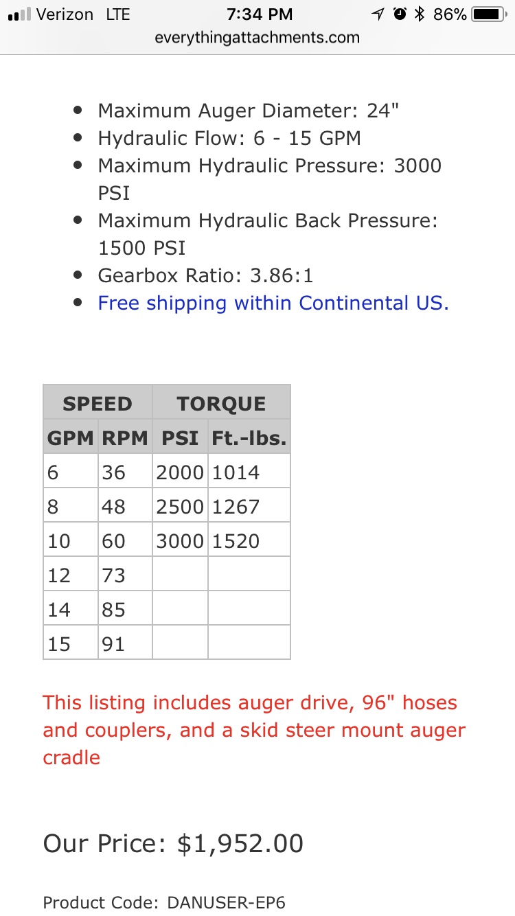

Yeah, I have 3rd function. Just seems the tractors loader is much weaker than a skid steer....
this is the Danuser I found in everythingattachments

That's the one I just bought, with a 9" and a 15" bit. Not saying you couldn't tweak a loader frame but I haven't heard of someone doing it with a auger drive.
Just look at the single tube on a 3pt PHD, then compare it to 2 loader arms. Then factor in you can crank double the HP through a PTO shaft that you can the hydraulics on a CUT. Granted the PHad is mounted off center on a tractor, but I don't see generating any more forces with a PHD than you can with a bucket.
I only have a 12" for my new hydraulic PHD. May get a 9" if any jobs want smaller holes. A 15" would be pushing the capabilities of the the hydraulics on a CUT I think.
