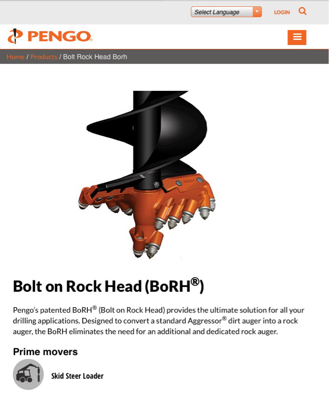

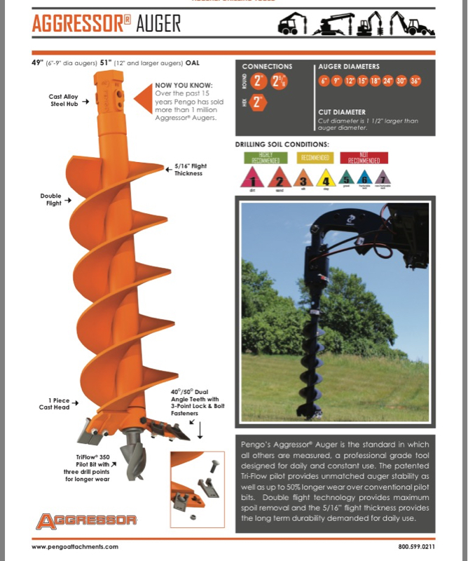

For me by the time I bought a new or even nice used 3pt pto digger then added a down pressure kit and all I would have been in it for about as much as the Hydraulic unit I bought. A few guys that have these on there tractors around here really like them, so guess I will find out for myself when it warms back up a bit. I did get my pengo 15" auger and rock head in the other day, very nice quality for sure. Your tractor would handle a low flow unit if that's what your asking, also as Fallon said the higher flow and pressures will allow for more torque to spin the augers, it's not really the speed as much as the power to keep the auger spinning when it gets into hard ground or rocks.

That's the one I just bought, with a 9" and a 15" bit. Not saying you couldn't tweak a loader frame but I haven't heard of someone doing it with a auger drive.

Just look at the single tube on a 3pt PHD, then compare it to 2 loader arms. Then factor in you can crank double the HP through a PTO shaft that you can the hydraulics on a CUT. Granted the PHad is mounted off center on a tractor, but I don't see generating any more forces with a PHD than you can with a bucket.
I only have a 12" for my new hydraulic PHD. May get a 9" if any jobs want smaller holes. A 15" would be pushing the capabilities of the the hydraulics on a CUT I think.

I agree, plus a hydraulic is more controllable. I hope the 15 will work out for me, a 12 was pushing it for some of the utility poles I use, and that was the only choice I had from 12 was going with a 15 in a quality auger. I probably wasted money on the rock head but guess until I try it will I know. I thought about waiting on the large bit until I used the 9" a few times to see how well it does, I could of rented a larger bit from a few local renters if need be.
