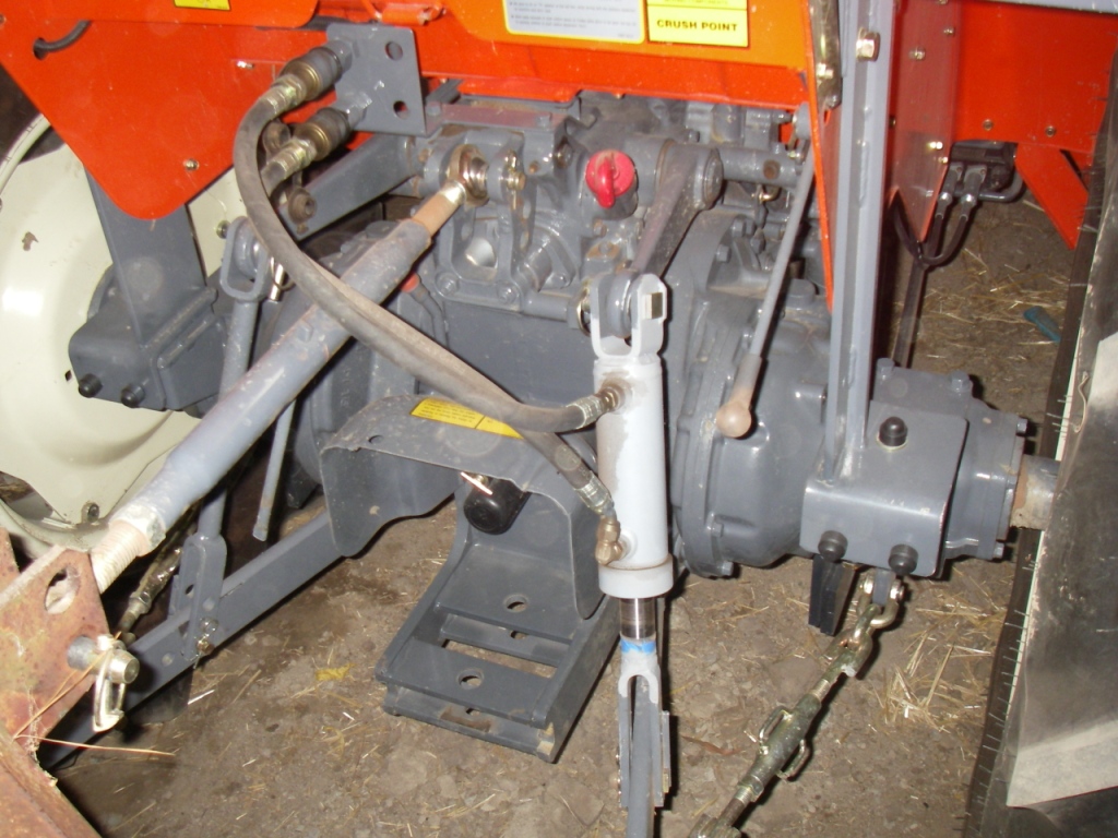

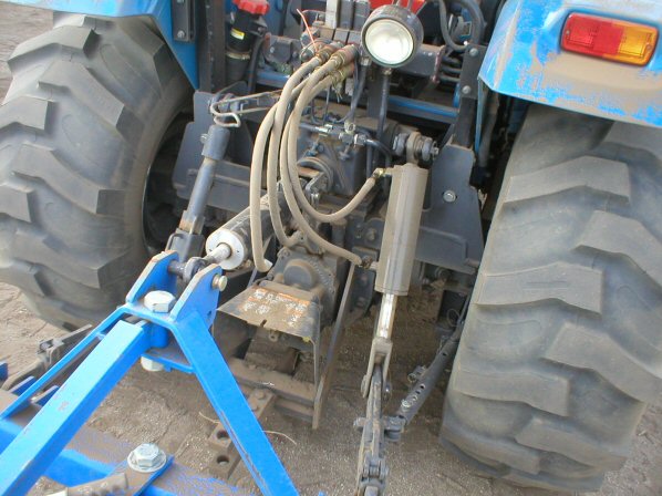

Gerry,
I have just finished a tilt cylinder mod on my new Daedong EX50, we live on a hill and it is a real pain in the *** readjusting the angle of grader blade etc.
A manually adjusted link will give a greater adjustment range over hydraulic because of the dead area in a hyd cylinder. I spent a lot of time working out the required length and stroke needed to give the amount of angle change needed for what I want the tractor to do. (Dont forget the pivot point is the end of opposite 3PL lower end)
I used a factory link, cut the ends off and re welded the ends back on the good thing about this is it has three different holes in the lower end, so I can change position easily at any time I want more up or down travel.
It is hooked up to the rear remote and at a push of the lever it moves ! I works great !
Maybe the people who are not happy with thier hyd tilt got an off the shelf one fit all cylinder that may not work well in the range they require .
check out the photo - just needs paint now !
Cheers
xcat

xcat, in your photo it looks like you have little or no tilt to the left. Usually when one hydraulic side link is used the hydraulic ram is centered to be level. That way an equal amount of tilt can be had on either side. I like that you used the factory ends on your hydraulic, that is the wright way to do it. On my cat 2 side link I have 8" of travel and if I remember correctly my stock factory one had 6". The same holds true for my top link, I have more adjustment with my hydraulic than I did with my manual one.
Now I am not sure if this is possible on the cat 1 hitches or not, size might play a factor here. Here's a picture of my setup.

Brian,
We had issues trying to fit a longer ram in the area we had, 4 stroke was the best to allow enough up travel. If I used say a 8 stroke ram I would not be able to lift the rh arm higher than the left due to dead area of the cylinder. And my main aim was to be able to lift each end of out grader blade the same amount off the ground from horizontal position and I can do that as the blade pivots from the left arm. Secondly when grading drains I tend to always dig on the rh side so this is why I only have limited up travel on the rod, but it gives me lots of down travel to get deep drain / channel. I also have three positions I can set the lower fork on so if any time I require a different task I can change the amount of up or down. But again our main problem was getting a cylinder to fit within the limits of this machine, a point I should have said in my earlier post. Hope this helps.
Cheers

xcat, I was thinking that you might of had a 6" stroke and it seemed odd to have 1 and 1/2" -- 2" of ram out when level, that's all. But even that would have made sense now knowing more what your main usage is. Hey, one other question, you don't have dpocvs, does your hydraulic side link wonder? Or have you not been able to use it enough yet to tell?
