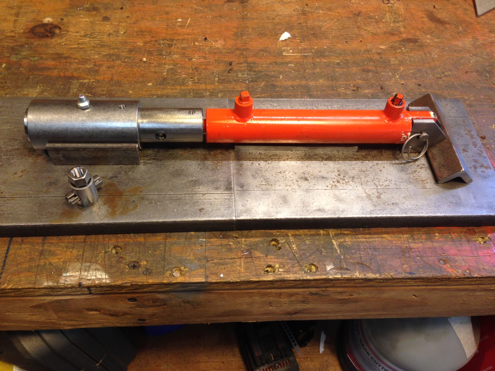

This is the cylinder:
0.875x3x0.5 DA HYDRAULIC CYLINDER
On cost, I put hydraulics out to the loader for a grapple. The additional cost for the qa was:
Diverter (I see MountainViewRanch has them for $112 shipped)
Cylinders ($70 ea)
Plus hoses, fittings, electrical hookup

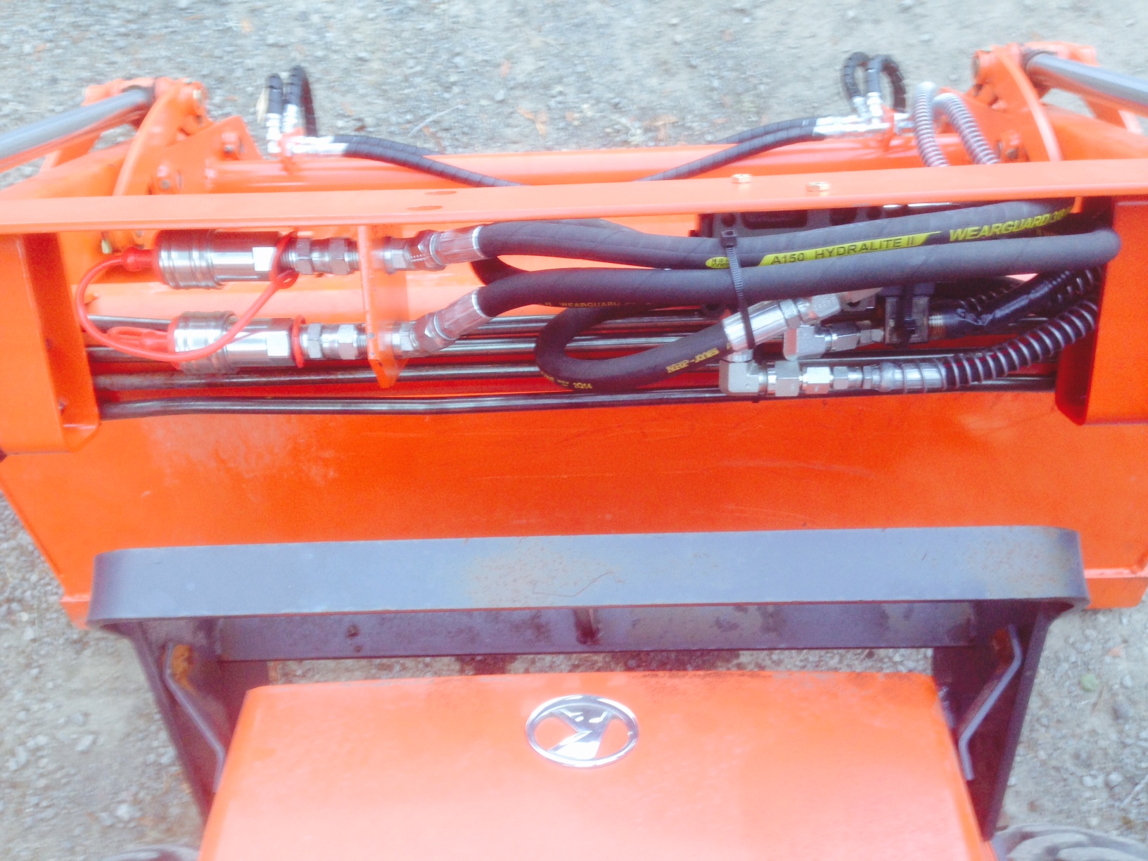

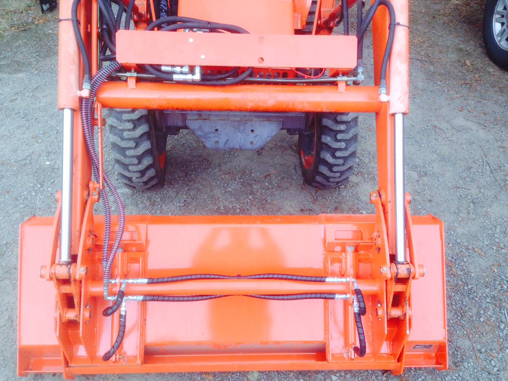

The longer qa cylinder hoses arrived and are now installed. Everything works as planned. I will update on any operational issues after a few weeks.

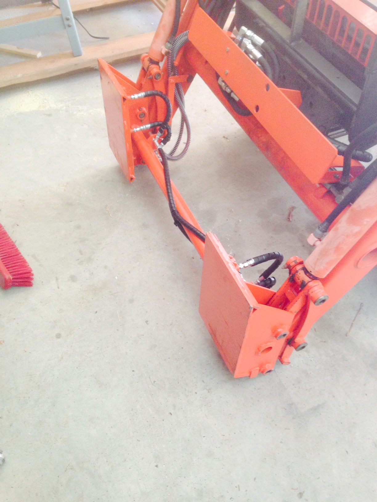

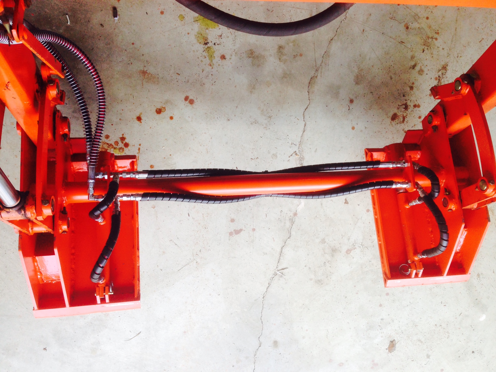

Costs came out higher than I would have liked.
Metal plate, angle, bar, etc - 51 lbs @ $1/lb at surplus yard = $51
Torque tube 48" DOM 2"x.25" = $41
Mount pin bushings DOM 1.5" x .25" = $12
Pin tubes 7" DOM 1.75"x.25" = $7
Cylinders 2 ea @ $70 = $140
Diverter valve = $160 (could have saved $50 if bought from Mountainviewranch)
Hoses (8 ea various lengths) = $140
Fittings = $36
Wiring (fuseblock, wire, loom, switch) = $55
Total $642 materials.

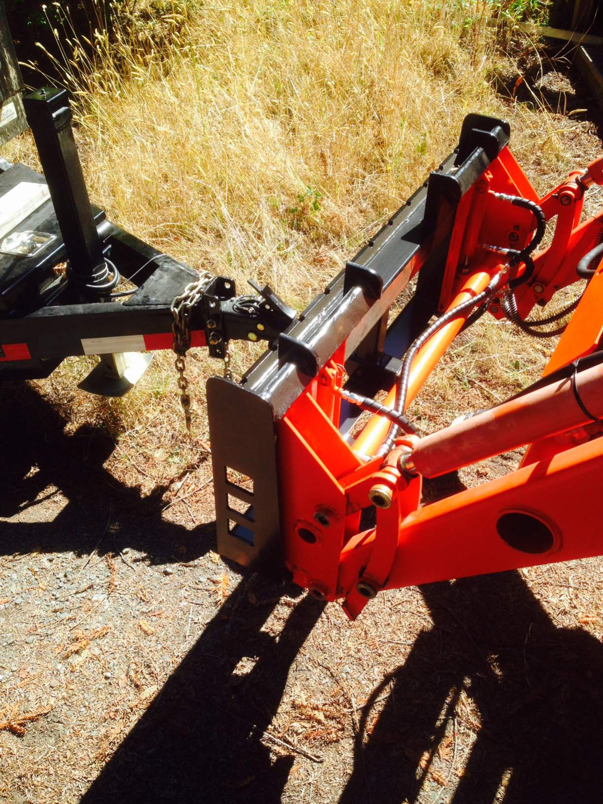

Satisfaction is also huge, for sure! After just a few days of using it, I realize I should have installed a QA long ago. So having the QA is a huge plus. Then, the second thing is how to actuate. With over-center crank arms, with a linear actuator, or hydraulic. Making the hydraulic option work is very satisfying.
Making it to the SSQA standard is also part of the satisfaction. The first thing I did was buy a set of forks. Extremely handy. I still think the Euro-Global design is easier to fabricate and also better suited to hydraulic actuation. But the widespread availability of SSQA attachments is hard to beat.
