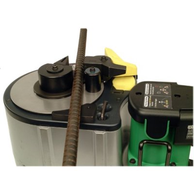

I think a weedeater engine has plenty of horsepower - many times what that battery unit has. This can even be done with hand power. The OP's idea can certainly be made to work and it certainly lacks novely. It will be expensive compared to a single acting piston-powered-spring return deal. I imagine the 10,000psi gear pump will be as expensive as everything else combined. I actually have one on my junk shelf - too bad the OP doesn't deserve it.

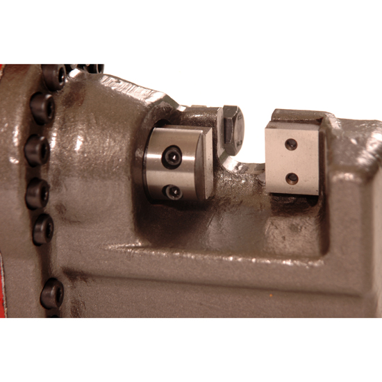

How large do you think that rebar cutter is from HF. It uses 10,000 psi, and that can be obtained from just about any hand pump, or one of the air motor driven hydraulic pumps. That is probably a carbide head on there, and cutter is rated at 12 mm, or.47 in, a little smaller than 1/2 in. If this were mounted on a solid line capable of 10,000 psi he could reach to whatever distance he wanted. If he is dead set on a weed eater engine, I just don't know. Probably the nitrogen would work. We still don't know the full extent of what he is trying to do. The rebar may be inside a pile of cement/rebar rubble. I have something that would cut just about anything, and that is the jet rods, or Exothermic/Slice rods. just need oxygen.

In the manual for the HF cutter the stated capacity is actually 3/16 to 1/2" so it meets the OP requirement.
The HF unit can produce a maximum force of 8 tons at 14,500psi indicating a cylinder area of 1.1 square inches. Probably a good baseline for calculating power requirements. To go 1/2" in 1 second pushing 16,000lb requires about 1.21 horsepower. Let's say a total of 2HP is required due to friction. That number can be divided by the number of seconds allowed to accomplish the task. A typical weedeater is about 1hp so it should be able to make the cut in 2 seconds. If you allow 10 seconds, it only takes 0.2hp or 150 watts - pretty close to what a cordless tool can do.
