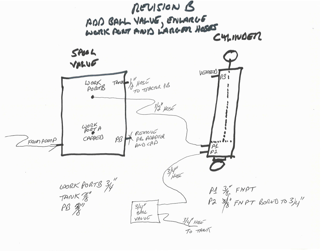

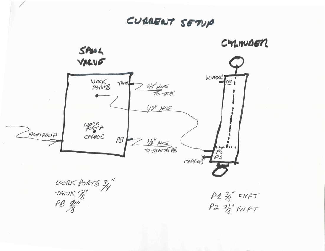

I'd like to address the four hoses that you questioned. Here's the current setup:
Firstly, I don't have rear remotes on this tractor but I do have a Front End Loader and associated spool bank.
So. I tapped into Power Beyond (PB) port on the FEL spool bank. I got the idea reading the installation instructions from those guys that put out after-market remotes kits. It's a poor man's way to tap into the hydraulics.
Looking at the valve spool in my diagram. The "From Pump" line originates from the PB port on the FEL. The PB outgoing line on this valve spool connects to the other end of the line that I interrupted at the FEL.
The "WorkPortB" line is obvious. The "Tank" line goes to the hydraulic fluid filler cap on the tractor - unrestricted. That's four lines.
Why did I do it this way? Trial and error.
Originally I didn't have a PB "adapter" on this spool valve. So I plugged it. I left the Tank port line going straight to the tank on the tractor. Result: same slow up/down but my 3pt stopped working. Well thats a problem because I use the 3pt to adjust the pitch of the PP.
Then I thought about plugging the Tank port and sending all the fluid to the PB port. I caught myself before doing it. No way that line can handle all that dumped fluid.
Okay, so then I thought about plugging the Tank port, remove the PB adapter and pipe all the fluid to the Tank. Internally on the spool valve the Tank and PB port are connected if you remove the PB adapter. Well that resulted in the 3pt not working again -- there way no line returning to the FEL spool bank.
Why do I have four lines? The short answer is I need hydraulic power after this hydraulic tap, in my case the 3pt.
Whew! Remember you asked :)

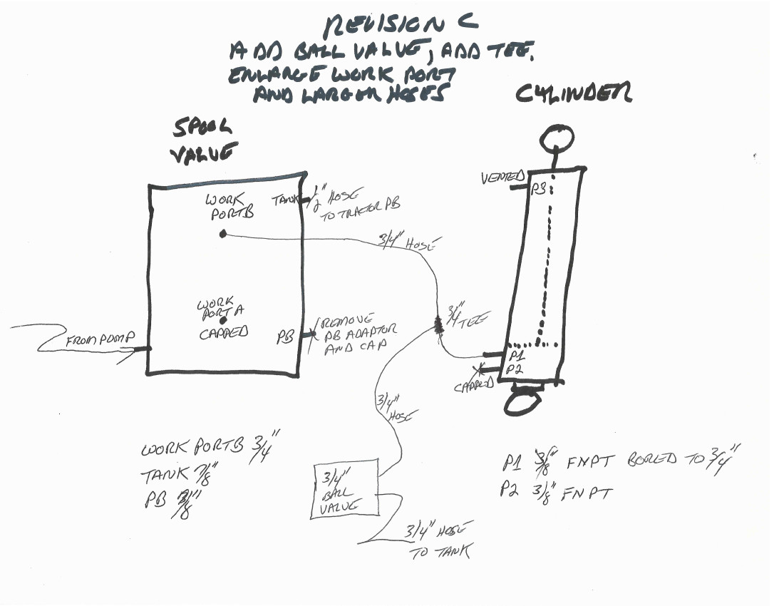

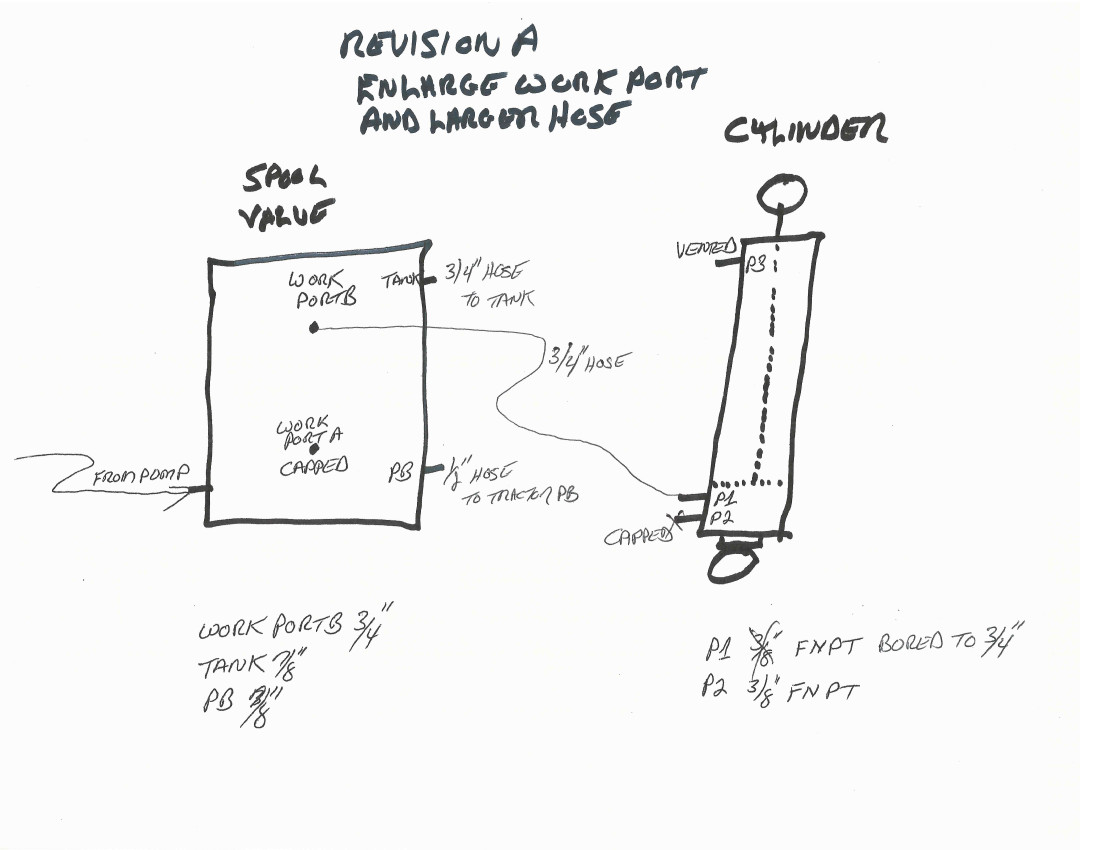

Yepper. Back in post #14 I said:
"Several contributors have suggested that the problem is that the hydraulic fluid flow is being unduly restricted. The spool valve has a 3/4" work port. I'm currently reducing that down to 1/2" hose, then finally the port on the cylinder is only 3/8"."
In that post I outlined 3 possible ways of addressing that restriction via "plumbing" changes. I'm was looking forward to getting feedback on those approaches. Sorry for being so wordy it. No hydraulics suppliers out here so trial and error costs me about a week for each pass.
Yeah, I'm still looking to resolve this with a 100% hydraulics solution.

Ok, spool port size, hose size, cylinder port size.
My background isn’t in hydraulics, but will a 3/8” diameter (3/8” thick?) “port” have more or less resistance than (say) 10’ of 1/2” hose?
Same with spool valve: What relationship does the port size have to the internal passages?
Where do you think the major restriction is that stopping it from working? Or do you think it’s all of them adding up?
Doesn’t your second option (using 2 cylinder ports without the tee) mean less fittings?

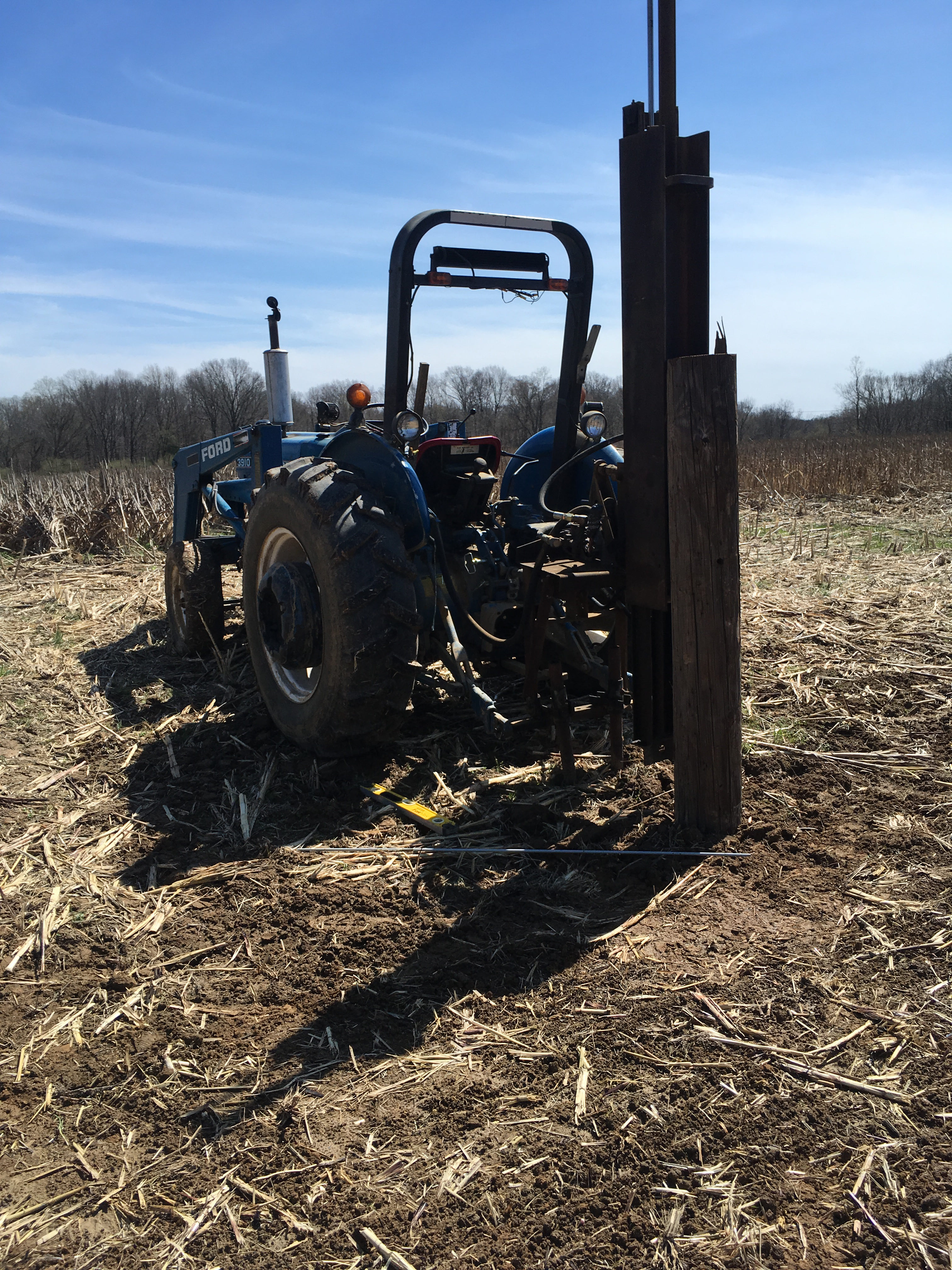

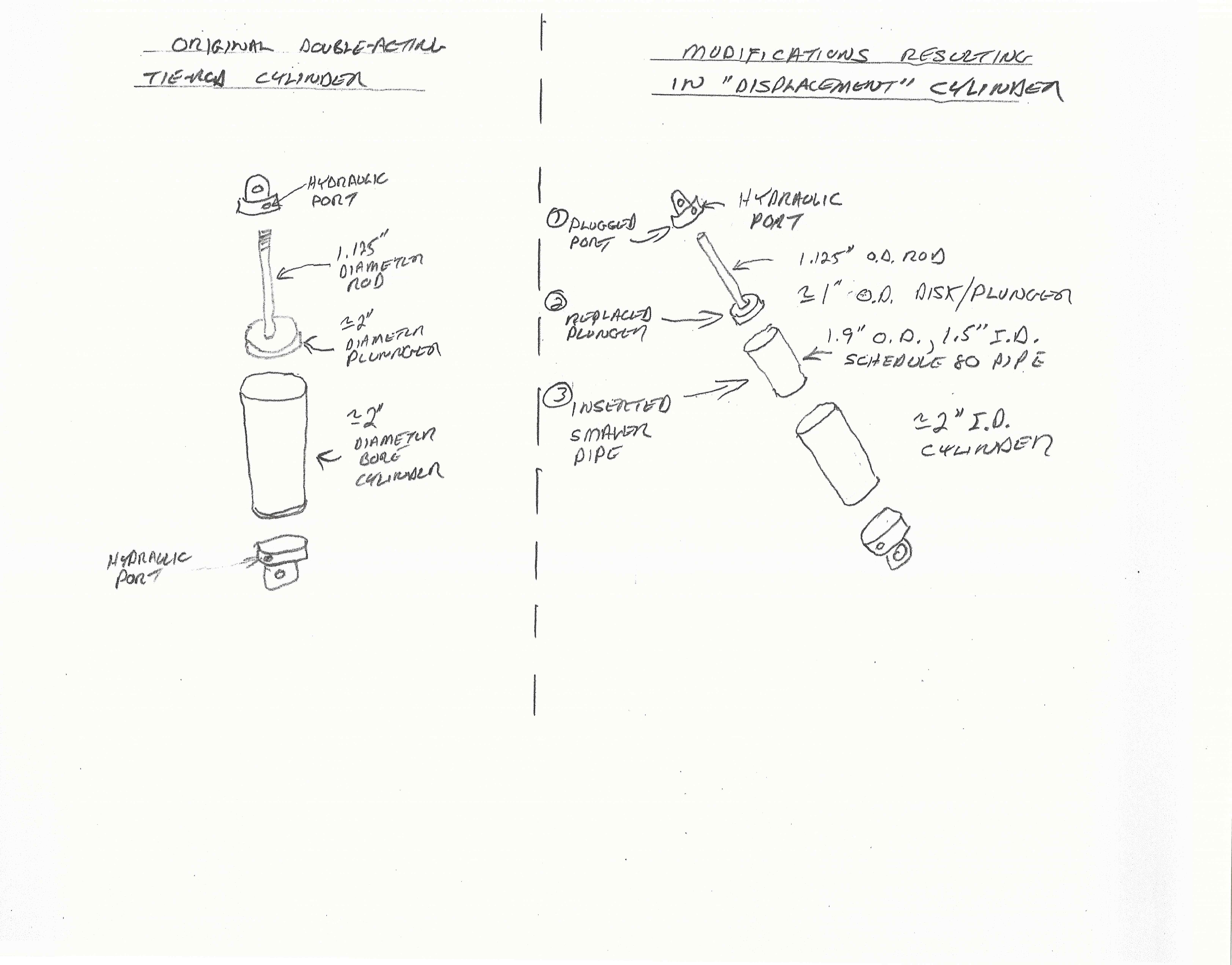

In the last episode of this saga I was stumped by the problem of not being able to get the weight to drop with enough force to actually drive a fence post. After several trial and error attempts I've got it fine tuned and doing what I want.
The problem boiled down to simply not being able to evacuate the hydraulic fluid in the cylinder on the down stroke fast enough. Doing the math, I would have to evacuate something like 64 ounces of fluid in under a second for this to work. It just wasn't doable with the cylinder, spool valve and plumbing I had on hand.
The solution was a simple set of mods to the hydraulic cylinder (see attached image) and converting the spool valve. Originally I started out with an off-the-shelf double-acting tie-rod cylinder. Since it's a tie-rod cylinder it was easy to take apart and reassemble. The modifications were:
1) Plug the hydraulic port on the rod-end of the cylinder, plug the B port on the spool valve and remove the hydraulic hose. My spool valve came as a 4-way with a kit to make it a 3-way. This mod effectively converts the cylinder into a single-acting cylinder.
2) Remove the plunger at the end of the rod. It's held on with a big nut so that was easy. Replace the 2" plunger with a 1"-ish O.D. disk/plunger. This replacement disk is smaller in diameter than the modified cylinder bore (see step 3) but it doesn't act as a plunger in a double-acting cylinder does. In fact, fluid passes by it easily. The purpose of the disk/plunger is two-fold:
a) prevents the rod from shooting out the end of the cylinder when the rod is fully extended
b) centers the rod in the modified cylinder on the up and down strokes
Functionally, I could have stopped here. After the first two mods I was able to get the the weight to free-fall unencumbered. But I wanted to do a little more tinkering and see if I could speed up how fast the rod extended (lifted the weight.) After trial and error, came up with mod 3.
3) Insert a smaller diameter pipe into the cylinder. This effectively reduced the bore of the cylinder and the amount of fluid needed to fill it. Wow what a difference it made.
So how and why does this work? On the up stroke, fluid is pumped into the closed cylinder. The cylinder fills to the point where pressure is finally exerted on the rod and disk/plunger equally. Fluid washes right on by the disk/plunger. Somethings got to give so the rod extends lifting the weight. On the down stroke the valve is opened and the weight pushes the fluid out. In this setup the down stroke is displacing only the equivalent volume of the rod and disk/plunger, not the whole volume of the entire cylinder bore as in the original setup. So instead of evacuating 64 ounces of fluid, it's displacing something like 14-16 ounces.
Thinking about it now. Since the fluid washes right on by the disk/plunger, I can send fluid to either the top or the bottom of the cylinder -- it doesn't matter. I'll need to take another look at that and see if I can further simplify the plumbing.
So what's next is coming up with some scheme to adjust the driver left-right and in-out. I could d it with hydraulics but think maybe first cut will be with simple turn-buckles.
Cheers!
