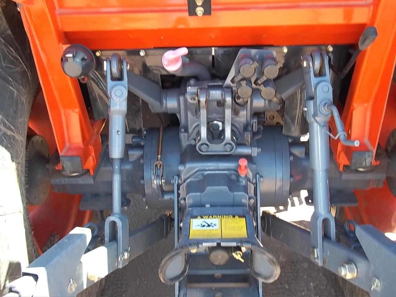

I have a DK40 and have had no issue with the it in fact i consider it a step up from the mechanical pto. So now its time i was considering adding a second Kioti to my pack and was looking at the DK55 because of its larger size and comes standard with 2 sets of rear hydro remotes but then is see it uses a mechanical engaged PTO so whats up with this?? Im stepping up to a better,stronger more expensive Kioti but it leave out the Hydrauic PTO? why?
this is not a deal breaker but i does raise questions on which is the best set up for larger tractors. anyone know why KIoti did this with the DK55
you can clearly see the mechanical linkage for engaging the PTO in this pict. and the very usefull 2 sets of remotes

The "hydraulic" PTO on Kioti and most other tractors is simply an electro/hydraulic clutch to start and stop the shaft which is directly driven by the tractor flywheel (other than the gears used to match PTO speed on the engine to 540 on the PTO shaft. It is not turned hydraulically.

I guess i am wrong about the 55s PTO.
Bellcon, what is the linkage on the left side of the PTO? the one in the picture

OK the DK 55 does have electric over hydraulic clutch in the PTO and im now guessing that the lever linkage on the left side of the PTO must be the switch between 540 rpms and 1000rpms. Im likeing this tractor better now
/ Hydraulic PTO vs Mechanical #9
I think you are right. I believe it's the linkage that switched the pto speed but I would have to look to be sure.

I have a dk55, and that is a push button pto engagement. it can be harsh on shredder engagement. but has worked well for me. The connection would be to the 2 speed pto, as it has a 540 and a 1000 rpm position under the left foot in the cab. i use the 1000 on light mowing at reduced rpms sometimes.
