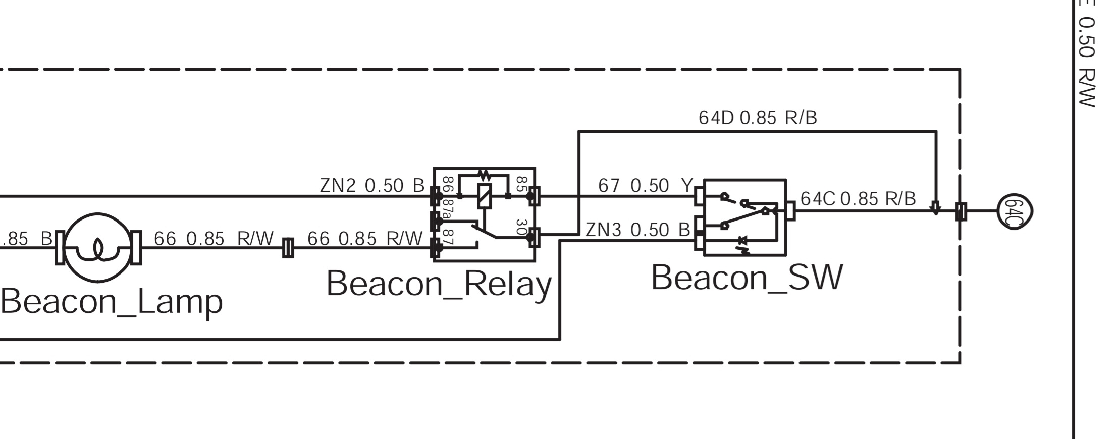

Oh? What is the Oreilly part number? I am looking at using the existing beacon light wiring for adding side working lights. I just need a switch and the relay that plugs into the fuse block under the hood.
So looking at the wiring diagram, it appears the beacon relay is different than the PTO relay, but here is the PTO relay part number from O'reilly:
RY1522

Good info, I'm thinking of doing the same to add side work lights after seeing the beacon harness connector when I was looking at the PTO wiring harness.

IMO, It was worth it
Lighting upgrade?
Just ordered the beacon wiring kit and a couple of pod flood lights. I don't have a need for the beacon, so not ordering the light and post, but looking forward to the side-lights.
