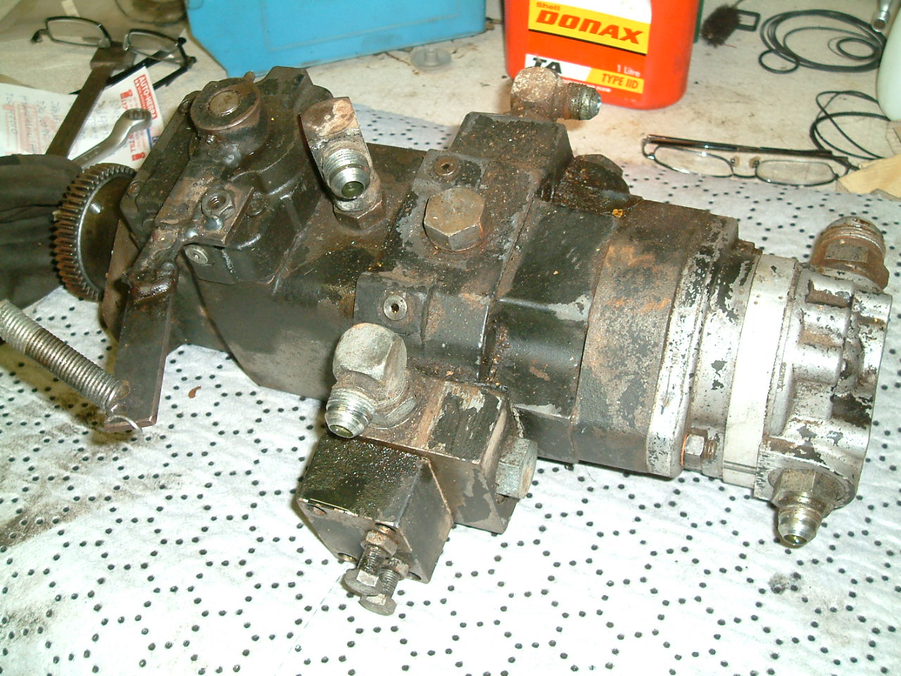

Hi, Thanks for help all of you. wdchyd is right it is Hydura I now find an exact same at Surplus center : .86 CU.IN./ .20 Cu.IN. | Piston & Hydrostatic Pumps - Quadra Trading Corp . this will make it a little easier I guess. I hope I can find the assembly drawing somewhere. My forward / back is controlled by solenoids, but the speed is manual lever from the pump. The Hydura pump at Surplus center is it used? Some warranty? You think.
PowerT 1850
Based on the displacement, the GPM's would be about 9 GPM, at 3000 psi, using about 18 HP from the engine
Do you know what the pump on the side of the engine attached to the flywheel is used for.
One of the gear pumps is for the PTO, and the other gear pump is for steering and lift.

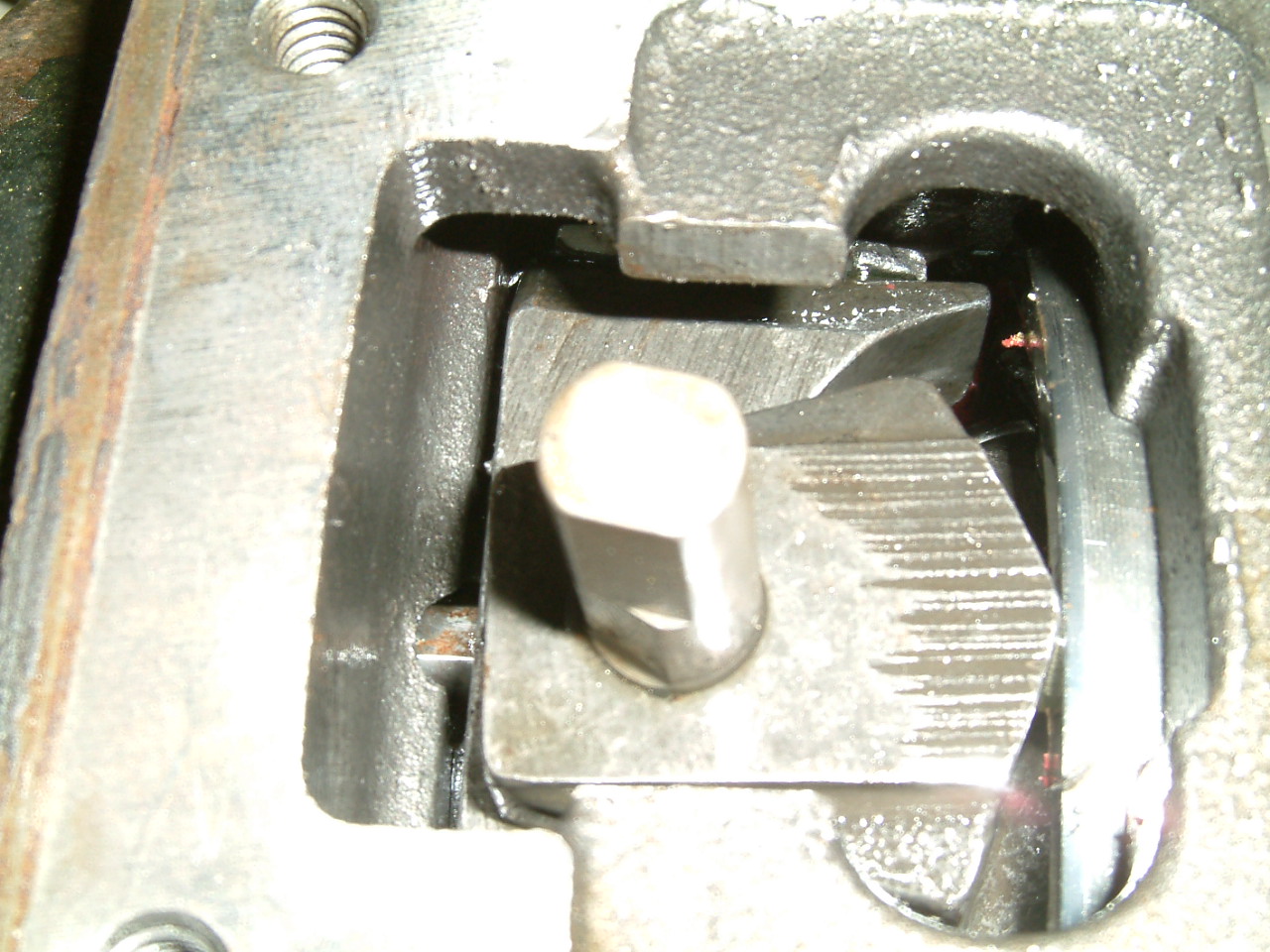

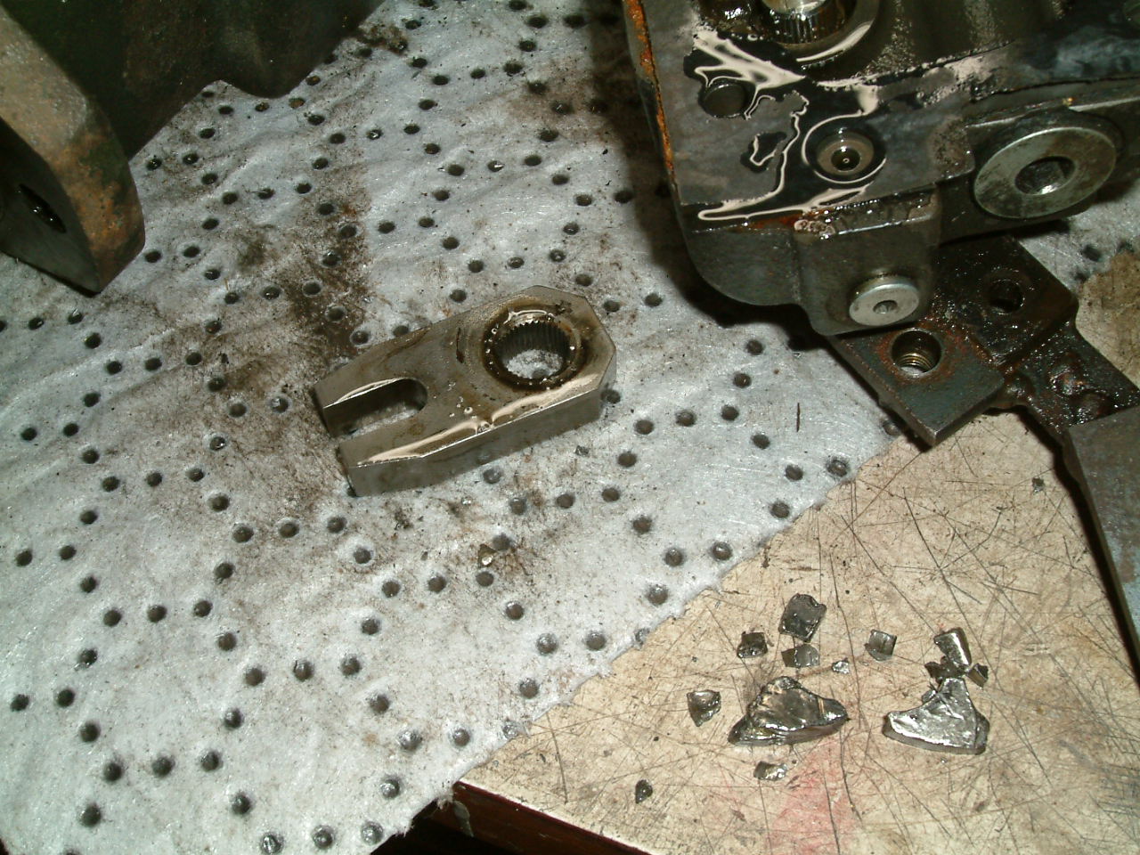

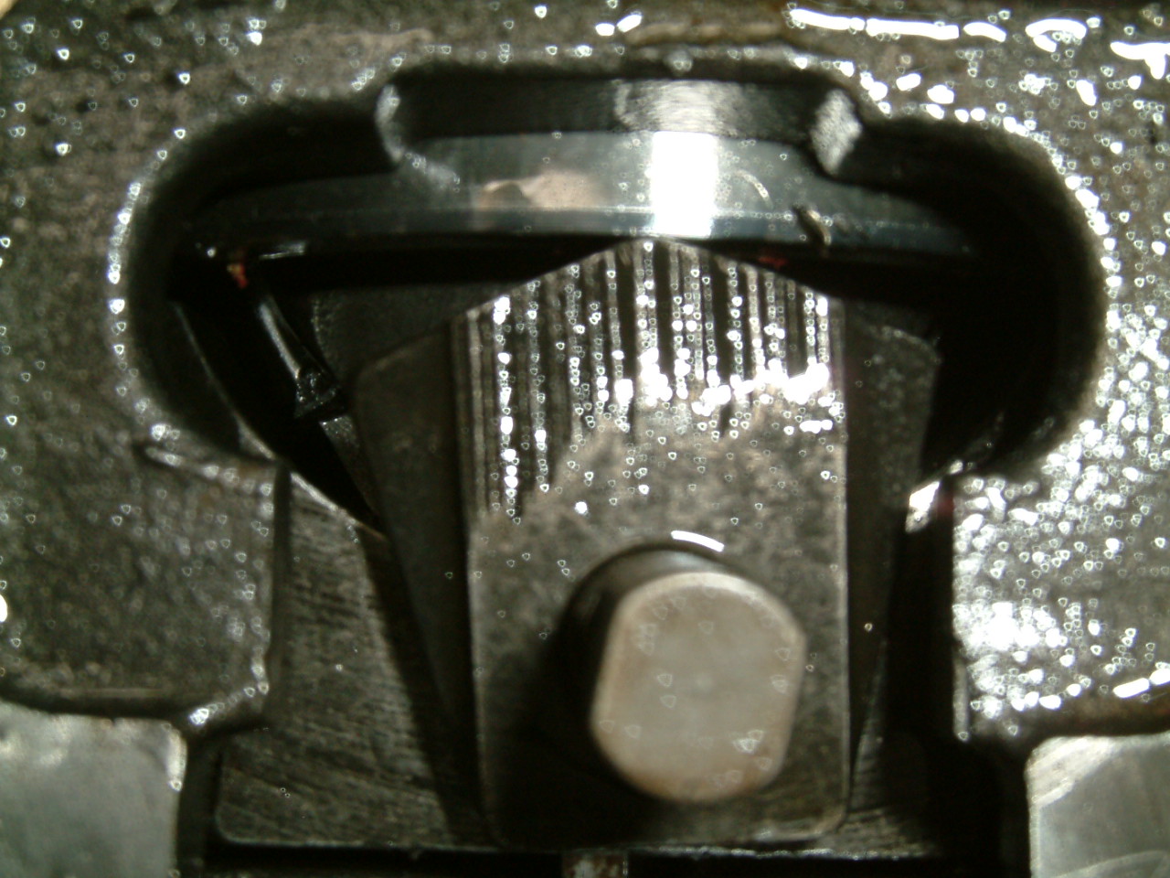

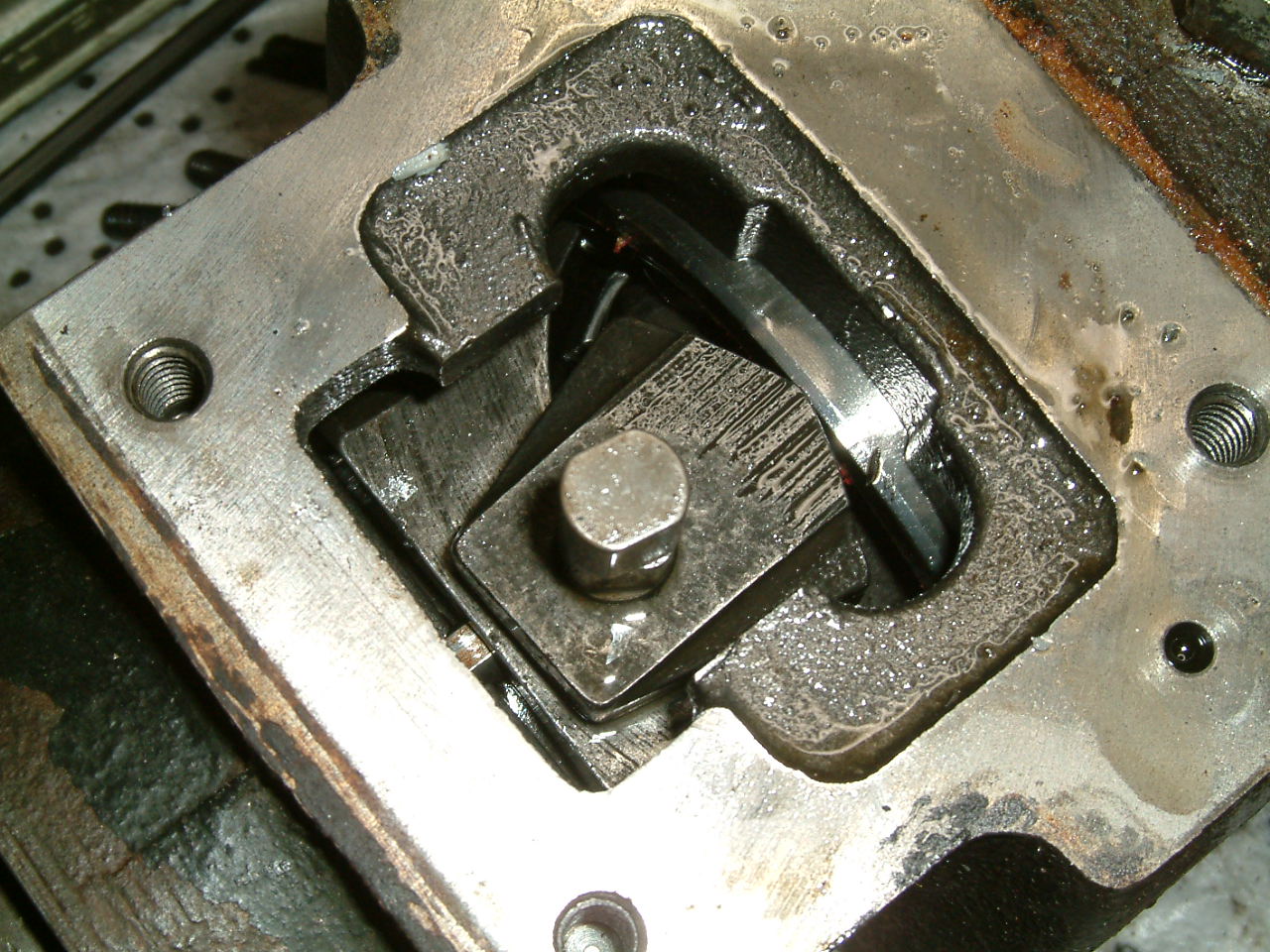

I have tried, but with no id plate and ( in Sweden rare) /old Hydura pump with all the piston shoes in very ,very small pieces.Se earlier in this thread...
