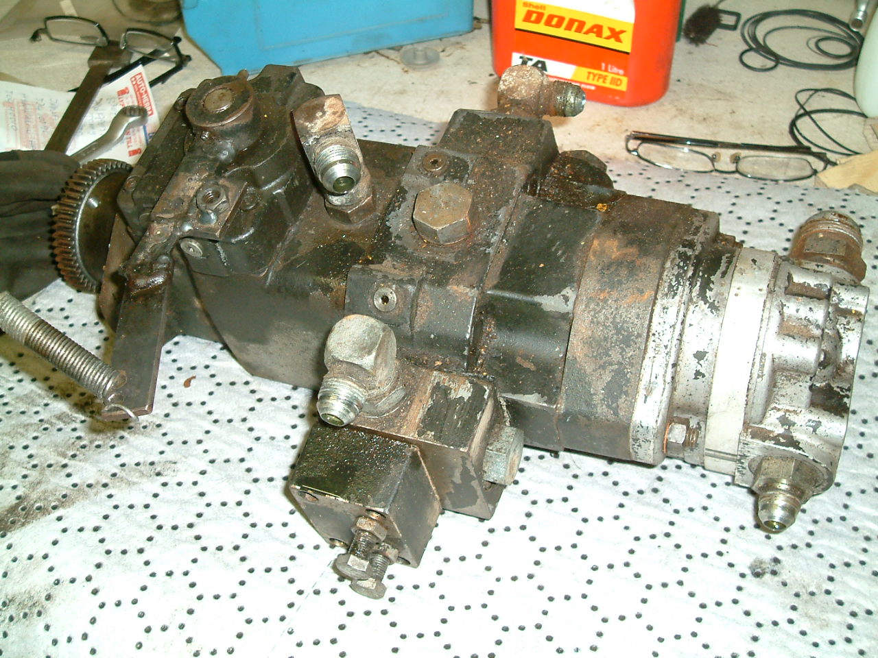

I have removed the pump. It was just the manual overrides that was stuck on solenoids, the electrical function is ok. I really need to know the brand of this pump ( Se picture ). Is it a good idea to have a look myself inside this or let a profesionall gay handle it?.View attachment 292398
Did you say that your drive was controlled by solenoids?
The lever on the pump in the last picture looks like a manual lever to move the squash plate.

Hi, Thanks for help all of you. wdchyd is right it is Hydura I now find an exact same at Surplus center : .86 CU.IN./ .20 Cu.IN. | Piston & Hydrostatic Pumps - Quadra Trading Corp . this will make it a little easier I guess. I hope I can find the assembly drawing somewhere. My forward / back is controlled by solenoids, but the speed is manual lever from the pump. The Hydura pump at Surplus center is it used? Some warranty? You think.
PowerT 1850

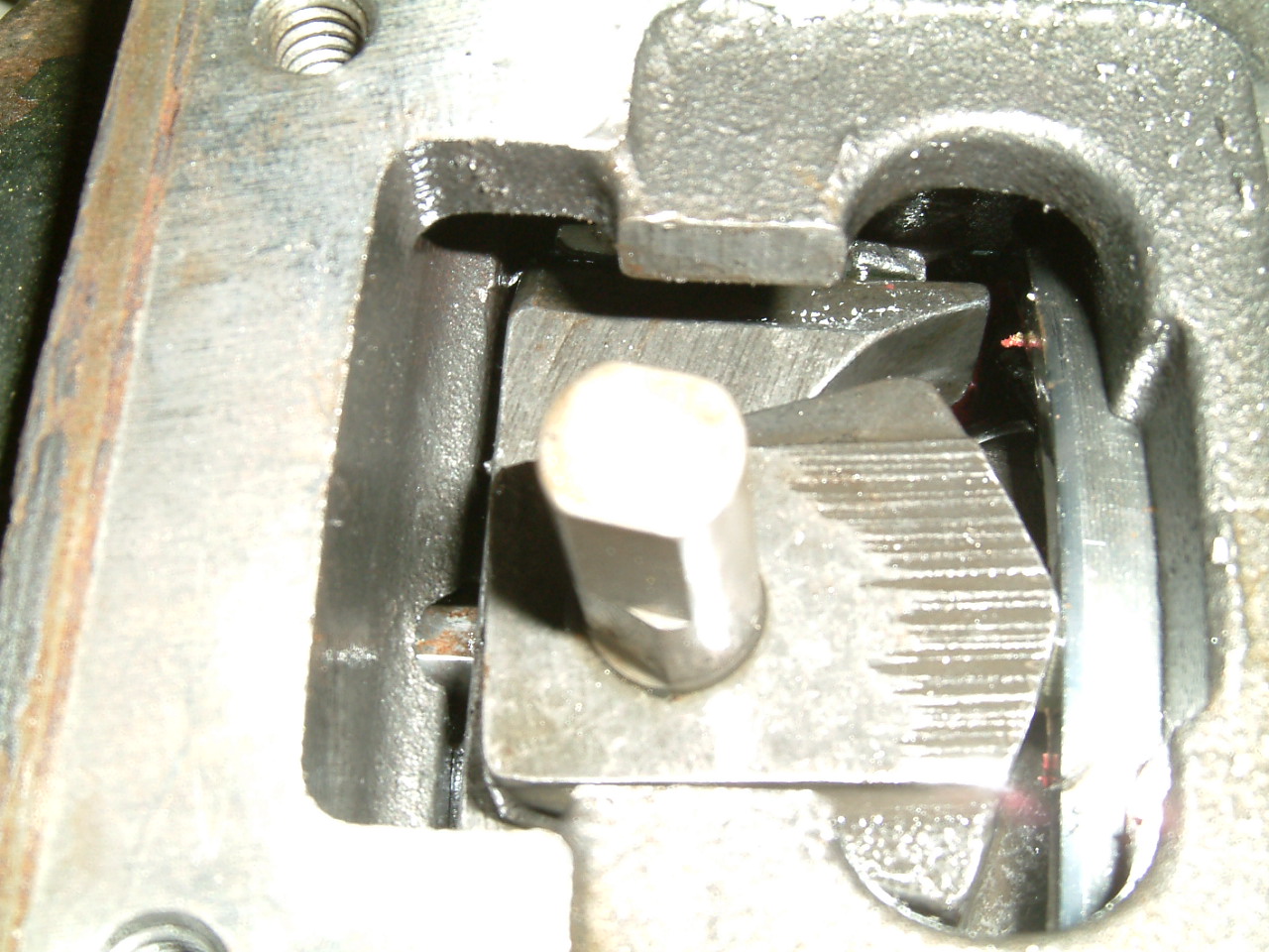

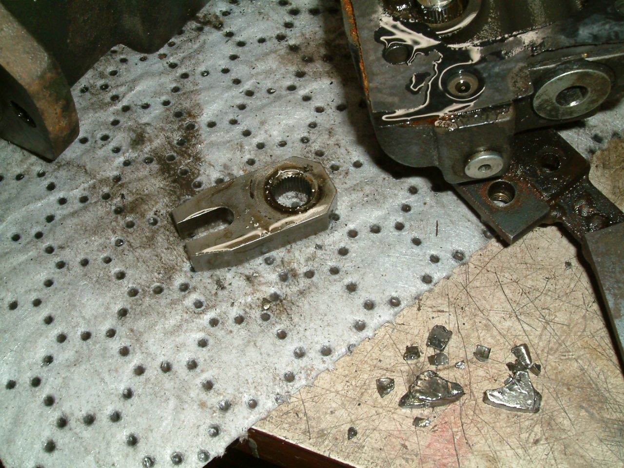

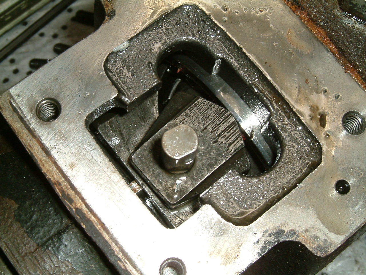

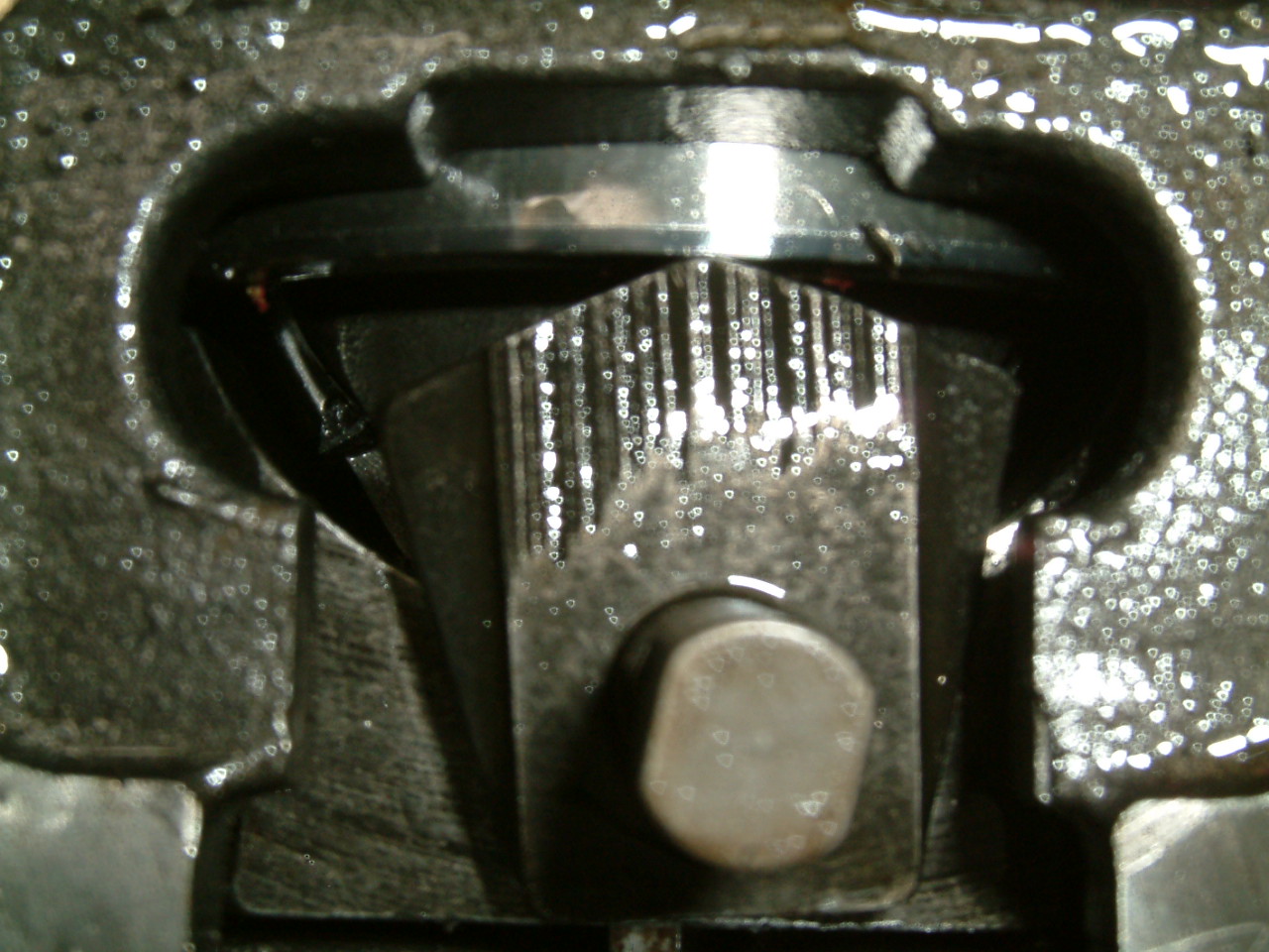

Took a peek under the lid. Found pieces of metal, is the same as the entire oil system is packed with pieces of metal? Well no turning back I guess. Dismantle the rest. Any concerns? Do I have too clean the hole hydraulic system? Buy a new pump? See attached photos. WDCHYD , is this the overcenter contruction that can also make forward/back. 2012-12-15 001.JPG2012-12-15 002.JPG2012-12-15 003.JPG2012-12-15 004.JPG

the best is to tear down the pump completely......assess the damage, look carefully at the mating parts on that rotating barrel (you'll see where the valve plate meets the barrel) those surfaces need to be not scored......
Look at the pistons.....the shoes on the end should not be flopping loose
Please take a bunch of closeup pix of more damage......
Those parts are avail but depends on just how much is needed to repair
Even after you rebuild or replace pump, the components connected to this pump need tearing down and rinsing (including the hyd motors), if not the debris that is floating around between the pump and motors WILL do more damage if not flushed out
It's entirely possible the hyd motor damage from the original repair was was the pump coming apart and throwing debris into the hyd motor

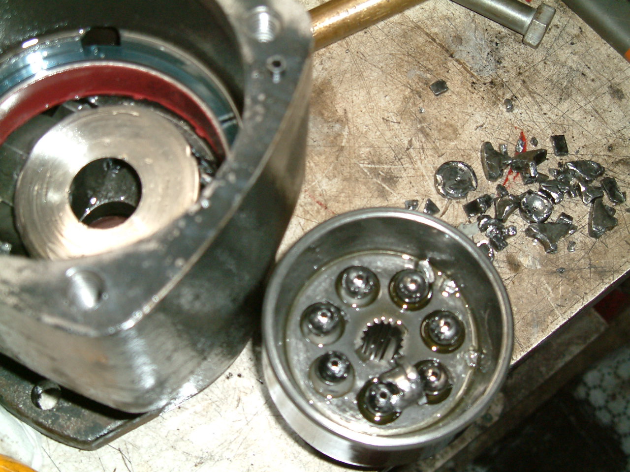

/ Hydraulic problems Power Trac 1850 #34
That doesn't look good, needing a new rotation group at the very minimum, pricing out a new pump may be wise
Was there any original pump ID number on your old pump......the new pump you have a link at Surplus Center looks like the rear aux pump has the wrong mount and a different gear pump (smaller)
Don't forget these pumps are put together using different displacements, mounts, shafts and ports......sometimes you'r just as well not getting from a place like Surplus Center cuz they offer "surplus" excesses from other companies that cannot sell them, that way the price is cheaper but the model codes are different
