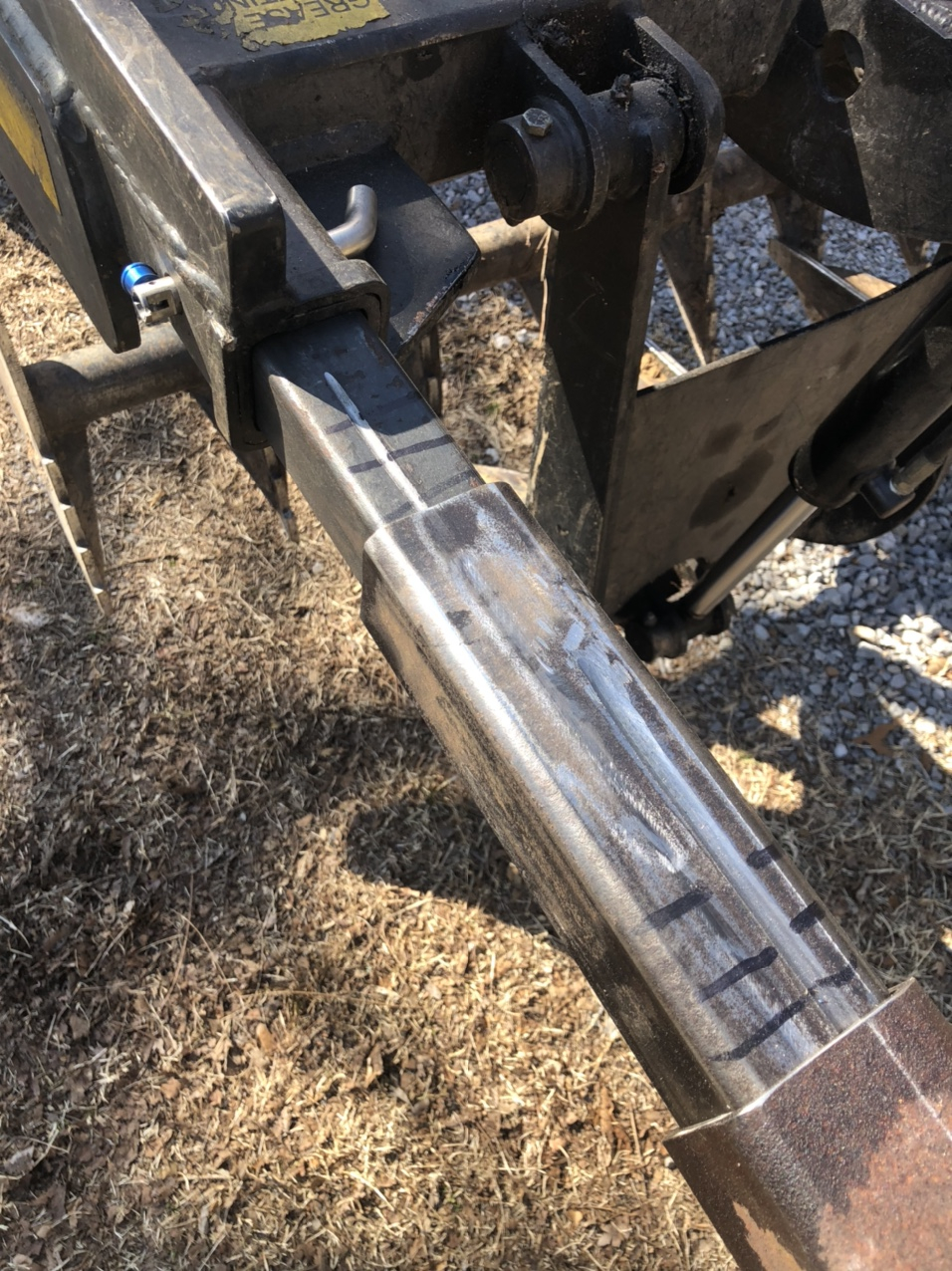

Smokey, I noticed that your construction utilizes square tubing telescoping into square tubing. I'm curious how you deal with the weld seam inside the tubes.
Used different methods from band file to broaching. Depends on how long and how much slip fit you want. On this saw boom simply ground a groove on the inner pieces to clear most of the weld seams. Still had to press the pieces together. Not elegant or skillful, used the tractor bumping a rock wall to push together for the right engagement before welding. Also plug welded and added a strong back to tie the three pieces together.

Also if you want to slip 2" square inside 2- 1/2" you can get 2- 1/2" X .238 with a flattened seam at most steel suppliers. Some times called trailer hitch tubing. At a slight premium of course but not much.

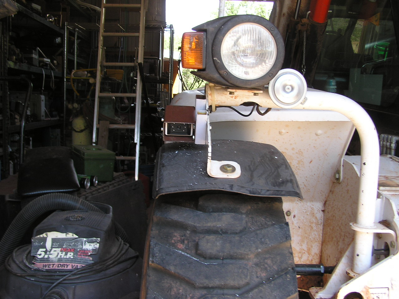

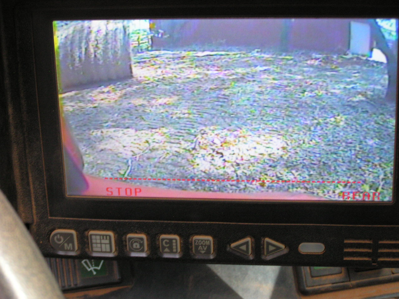

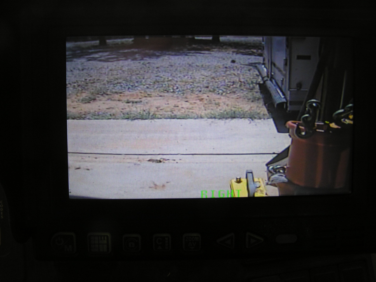

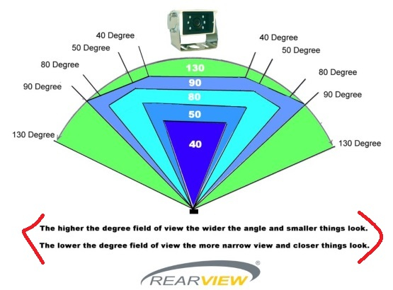

A well placed camera in the motor armor cover option needs explored. Going to have to revisit some tractor camera articles.
For your saw you would need a camera with a narrow field of view, not a "backup" camera.
My front view camera is 50°:

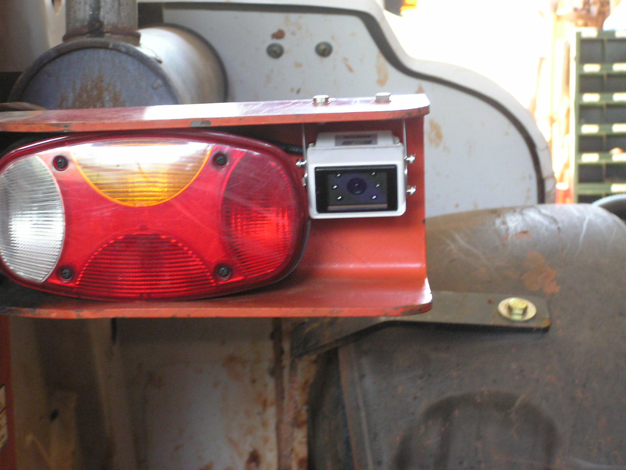

   / Hydraulic limb saw project. #73
Got mine from https://www.rearviewsystems.com/ back in September of 2012:
Mounted on right front fender:
The rear wide angle camera is mounted next to the right tail light:

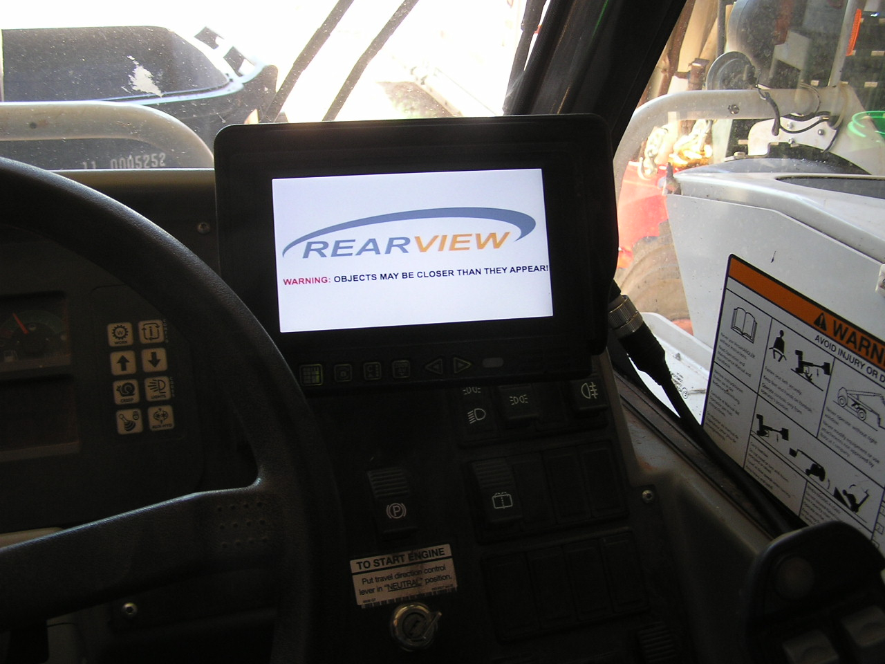

View attachment 740266View attachment 740267
View attachment 740277View attachment 740278

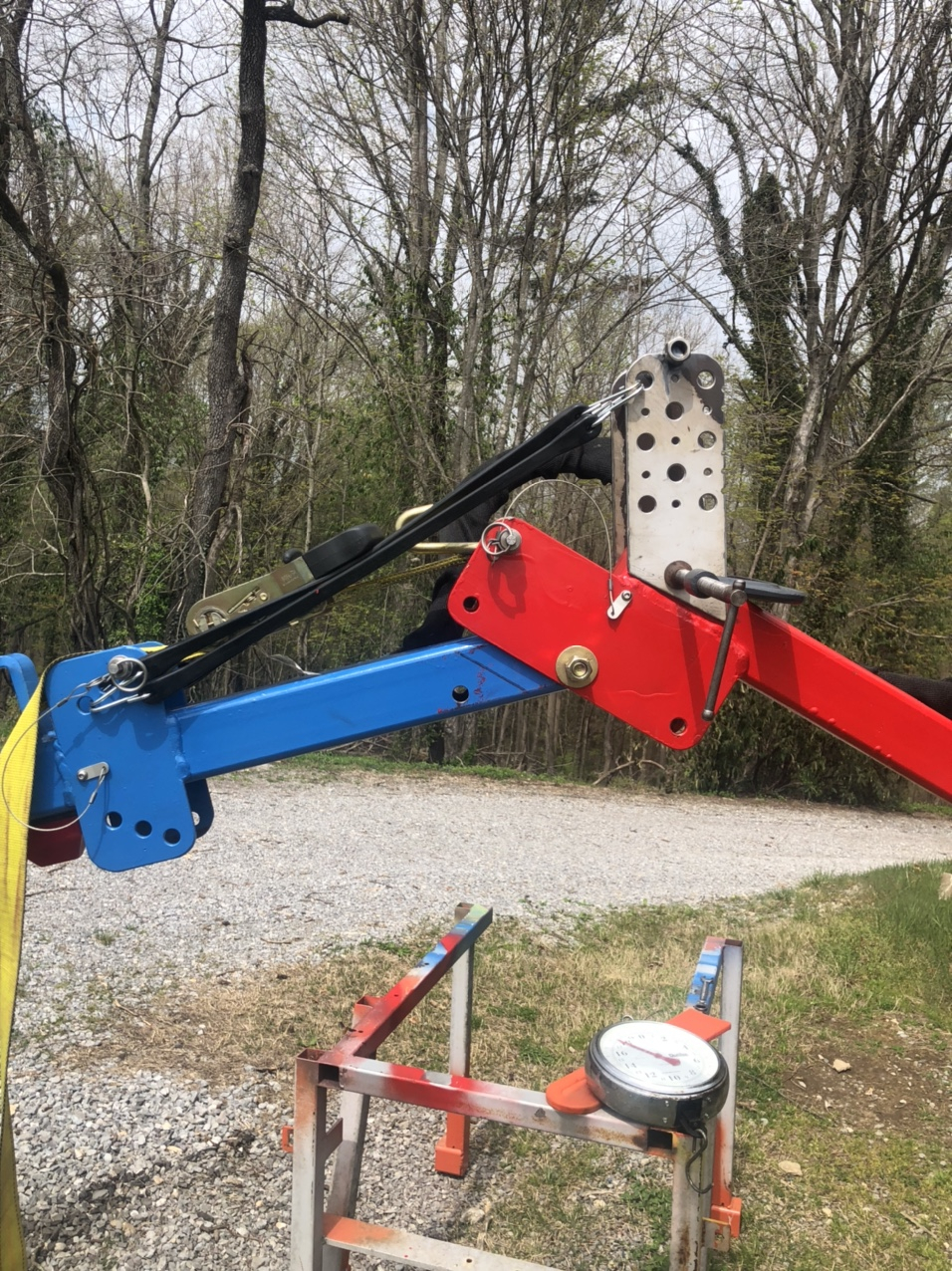

Made it a little bigger, longer and heavier structural steel.
Measured saw bar hinge weight with a produce scale. 36#.
Removed motor cover (18#) and reduced saw bar weight to 28#.
I could either skeletonize or remake the cover. 1/8” steel would be half the weight but only lose 4# on the bar. I’m a little MadMax medieval so I like my armor when fighting with tree creatures.
To use bungees to counter balance need better lever arm.
Four bungees gave 22#. About right.
Six bungees gave 17# and temporary clamp starting to slip.
Prepared and ready to weld later after one more eyeball test.
Do see where I could give some spring load to either side of bar for possible undercut.

Thanks for your reply. Not sure I fully understand the leaf spring patent for the saw application. The blue boom and red saw arm are not in the best position if parallel. 45* with some adjustability depending on the cut.
All bungees are not created equal. Ones used are 1.8X stretch, 15-27” range gives easy 15” travel to the blade. Gravity still pushes the blade thru the cut. The truck ratchet strap still holds the low position.
Reducing the bar weight should help with long term component wear. The hydraulic motor is very powerful and chips fly. That part of the build works perfect. Sharp saws require little weight to cut thru.
