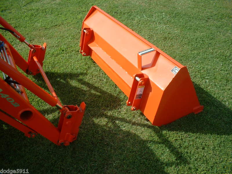

4) I converted my LA403 to a SkidSteer style quick attach. I recommend you try ATI ( ATI Corporation - Tach-All(tm) Quick Attach ) for a SSQA. There are others that make them, but there are plenty of LA403s with an ATI tach-all and I have yet to hear anyone unhappy with one. Seems I recall other members here paying in the 7 to 8 hundred range for the ATI..... plus a hundred and some change for the bucket side QA plate brings the parts to convert at about a grand (plus labor). Any 'quick attach' style bucket for a B series from Kubota is a proprietary system, and does NOT accept common SSQA style buckets, forks,etc.
I bought a set of forks by BRADCO ........ see a pic of them in this thread. http://www.tractorbynet.com/forums/attachments/185648-bradco-forks.html Without looking at the manual, I think they are rated for about 2300lbs........ double what your loader will lift. Purchasing forks with a heavier rating will just make for heavier forks.... reducing the amount you can lift with them
Yes, the SSQA makes changing between front attachgments incredibly easy, and I HIGHLY recommend it. I'd say the absolute best single improvement I made to my B3030. Check out my conversion process here. http://www.tractorbynet.com/forums/customization/140902-adapting-skidsteer-qa-my-kubota.html I bought my QA off of CraigsList, and it needed some modification to fit my LA403. I also converted my factory bucket myself, and made an attachment for lifting things and moving trailers.

/ B2630 TLB--Worth It? #3

"4. What's Involved to Make the LA403 Have a "Quick Attach" Bucket?
My main use (near term) will be moving stuff I can't lift alone any longer. Therefore, I want real (solid steel) forks, on a frame (like a "headache rack" so the items don't fall back on the tractor?) that has the notches, so you can easily vary their width, just like on a real forklift. I would like the ability to "Quick Attach" either the bucket or forks.
This is a big deal for me, because I want to be able to switch quickly between bucket and forks. If switching between forks and bucket (without Quick Attach) is a 45 min. process instead of a 5 min. process (with Quick Attach) I know myself, and I'd probably just leave the tractor parked rather than start driving out pins, etc....
So that's why the cost of this conversion is important to me--if I can convert this loader to a Quick Attach system for the projected $1,000. in parts, plus labor (see below) I want it. If it costs significantly MORE than that to do the conversion, then I guess I'll wait for a tractor that already has Quick Attach....
The dealer told me Kubota does NOT make a Quick Attach setup for the B series, but I found a link which implies that there IS a "Quick Hitch" kit available from Kubota. Comments?
I understand the ears will have to be cut off of the back of the bucket, and a quick attach assembly welded on--I know a fabricator that can do this. The dealer told me that:
a) the aftermarket hardware for a "Quick Attach" system exists that will PIN onto my loader arms, without modfication--is this true? Anyone have a link?
b) the above kit would cost only $400.-500., plus labor. Is this true?
c) a used set of solid-steel forks, with adjustable fork-width frame and "headache rack" would cost $400.-500. and are readily available. Is this true?
d) He said a set of solid steel forks of 2,000lb. capacity would be plenty--agreed?
e) If there's anything I'm overlooking, in order to convert this B2630 LA403 loader to a "quick attach" set up, with a set of forks, I would appreciate your opinions and feedback. Per his figures, I'm looking at $1,000. in parts, plus fabrication labor--does this sound right?"
A lower cost alternative to ATI that I have on order and awaiting arrival of: QA_8295_NEW
A lower cost fork that I am also considering after the SSQA arrives and is mounted: Skid Steer Attachments Pallet Forks Hay Spears Bobcat Cat John Deere Mount Plate
The plate that is on order to be welded to my current LA 403 bucket: https://ssl.zoovy.com/panrack/c=30Y...-steer-attachment-adapter-plate-Model-C1.html
As ductape states, a 2,000 lb. capcity fork is more than enough for a 403. Way more than enough. The lighter the fork setup you can find, the better.
