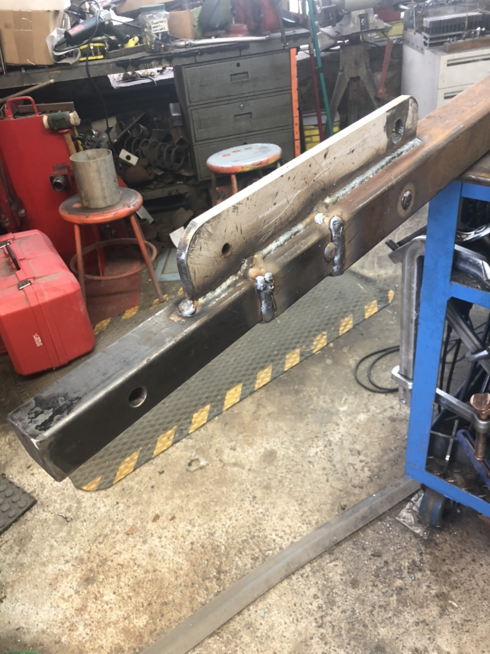

Working on saw arm bar clamp. Up sizing bar bolts and increasing bar slot width. Also tightly fitting the bar outer cover to the 8” channel motor mount to support the bar bolt attachment. While finesse and careful manipulation are going to be required, trees and extended loader work are unpredictable.
Going to tack pieces together then gang drill. 10 holes needed to line up closely.

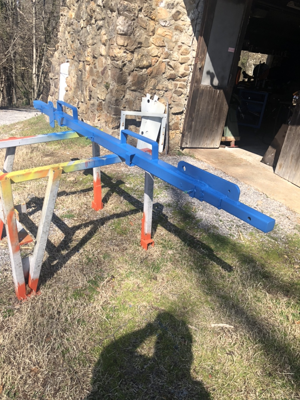

I'm thinking I will get a 2.5" or 3" receiver so that I can eliminate the step up and strong back. I think spending the money for that will trump the extra weight.
/ Hydraulic limb saw project.
#24
Great! Hope you can learn and improve from this experience. Please share your results.
Some of the design is material on hand. Mine is heavier given the wall thickness. May or may not be beneficial. Don’t have to worry about structural material cost or shipping. Without direct comparison with manufacturers versions may never know.
2” receivers already mounted on several attachments on different tractor platforms. The transition from 3”-2” gave an extra 1’2” boom length but also -25#s and more fabrication effort. Not the way to go into production. Only want one.
Would recommend a 3” tubing for strength.
Don’t see the heavier boom having issues. With the saw arm, it’s hinged weight is the force that pushes the saw thru the cut. My heavy, extra armor, robust construction may be a problem. Hoping the torque of the hydraulic motor to pull thru.
At some point want to experiment cutting vertically small limbs while driving slow down my 1/2 mile green tunnel driveway. Saw head supported with coil spring over shocks both ways to control dynamic loads. Don’t know if that will work but another reason for robust construction and boom bracket design.

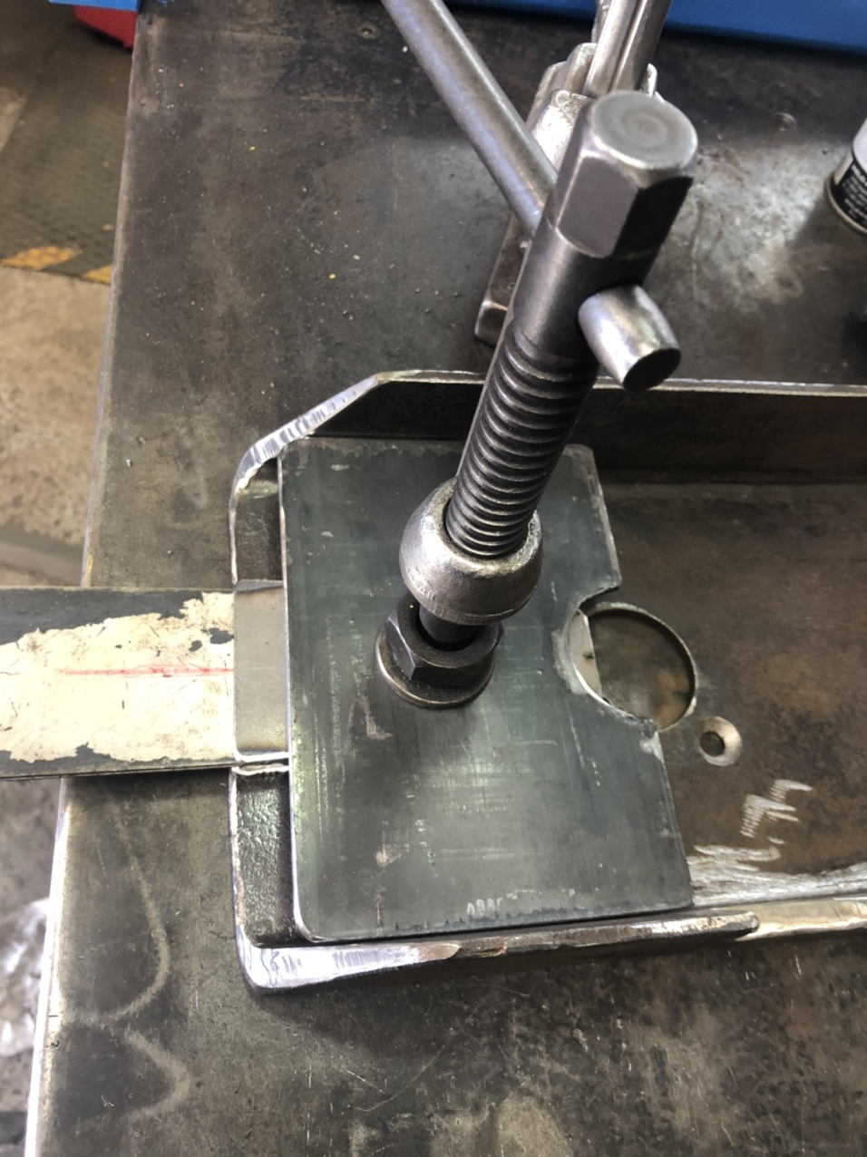

#28
12 saw bar bolt holes drilled and bar plates welded. Stores stock are scarce on specialty hardware and paint. Ordered online the type of sems grade 8 bolts.
Tack welding the bolt flanges to make one side stud fasteners.
Saw bar.
Was going to use my >40 years collection of 3/8” chains and 20” bars. May develop this option latter. LimbSaw uses I believe .325 chain? I’ve been blissfully ignorant for a long time only needing one type of chain and bar. Researching the difference may have found a reason. Many types of chains with different attributes. There are over a dozen chainsaw bar mounting options. D025 style has a 0.475” slot. This has a small drilled bar that bridges the two 3/8” mounting bolts. This creates a tab to fit the bar slot and better support the bar under heavy load. Common with some large .325 saws. Ordered .325, 063”, 81 drive links, full chisel chain and 20” D025 bar.
Automotive bump stop to cushion the saw arm when in folded transport position. Cushion the blow if the angle strap ever broke too.
Saw chain cover made it to the paint shop. While bending a flange, the 7.5” wide plate in the press, it cracked. Another surprise the salvaged plate material was cold rolled 1/4” steel. While twice as strong as hot rolled steel doesn’t bend well. Nothing a little extra welding couldn’t cure. Making the saw motor box cover amour from the same material.
Saw cover will have 4 bolts to pinch the saw bar.
Saw boom mounted on right side grapple. Saw blade mounted on left side of boom to maybe give better line of sight from operator seat?
