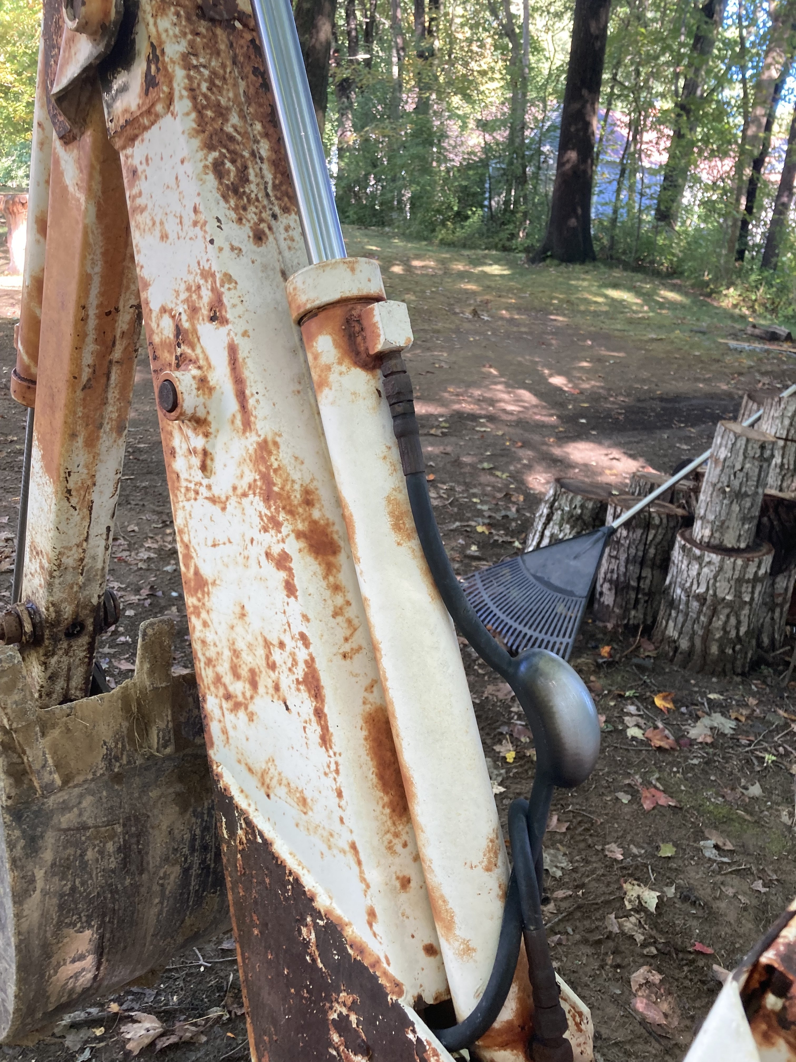

Got this old backhoe last year for pennies. First thing I did was new filter and fresh transdraulic fluid. Probably put on 20 hours last year and an hour this week. Today I just needed to dig a small hole to plant a tree. I was able to finish the hole, pack it up and put the tractor back in its home before I realized this huge bulge. What’s going on here? It amazes me that I was able to finish digging the hole.

Wow, it grew a kidney! Cycle the levers (engine off of course) and that should shrink back down. You have to relieve the pressure anyway before you take it apart. Good thing it didn't let go.
Easy fix: new hose. Shops all over, that can make a new one. Have them reuse the ends.

I wouldn’t reuse those. Small ends aren’t that expensive and those are pretty roached anyway.

I'm with 4570Man. NEW hose and NEW ends. You might want to take the old ends with you. So they get the correct new ones.

Wow quite a goiter. If that was mine and keeping with the small investment theme I’d probably pick up a pre made hose assembly at Blains, TSC or similar farm store. That is if that’s just a NPT thread going directly into cylinder port which it appears to be. Other end would have to be npt also. Get the assembly with swivel at one end for easy install.

Thanks for the replies. Gonna head to TS this week and see if I can’t find something to throw on there. Probably due for a fluid change anyways so I’m not too upset about it, especially being that she didn’t bust her guts all over the only pair of pants I have without holes in them.

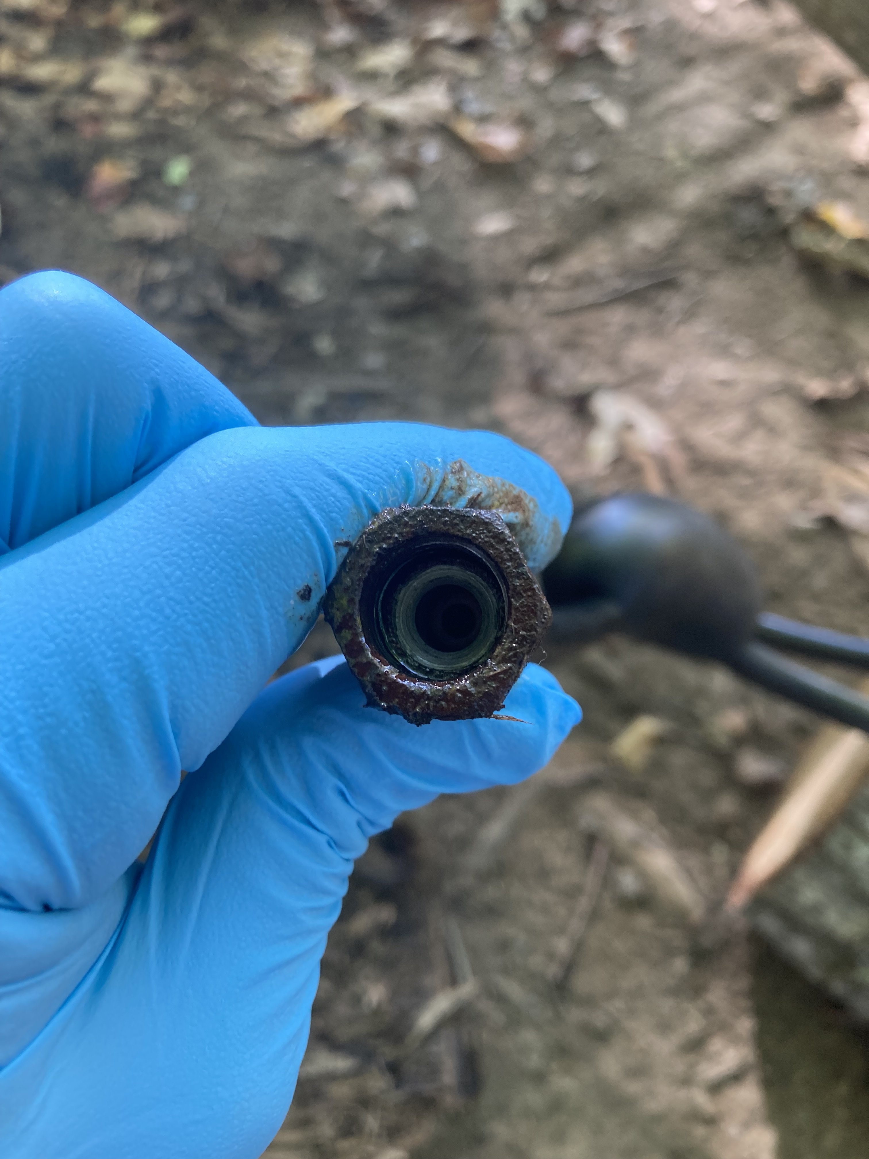

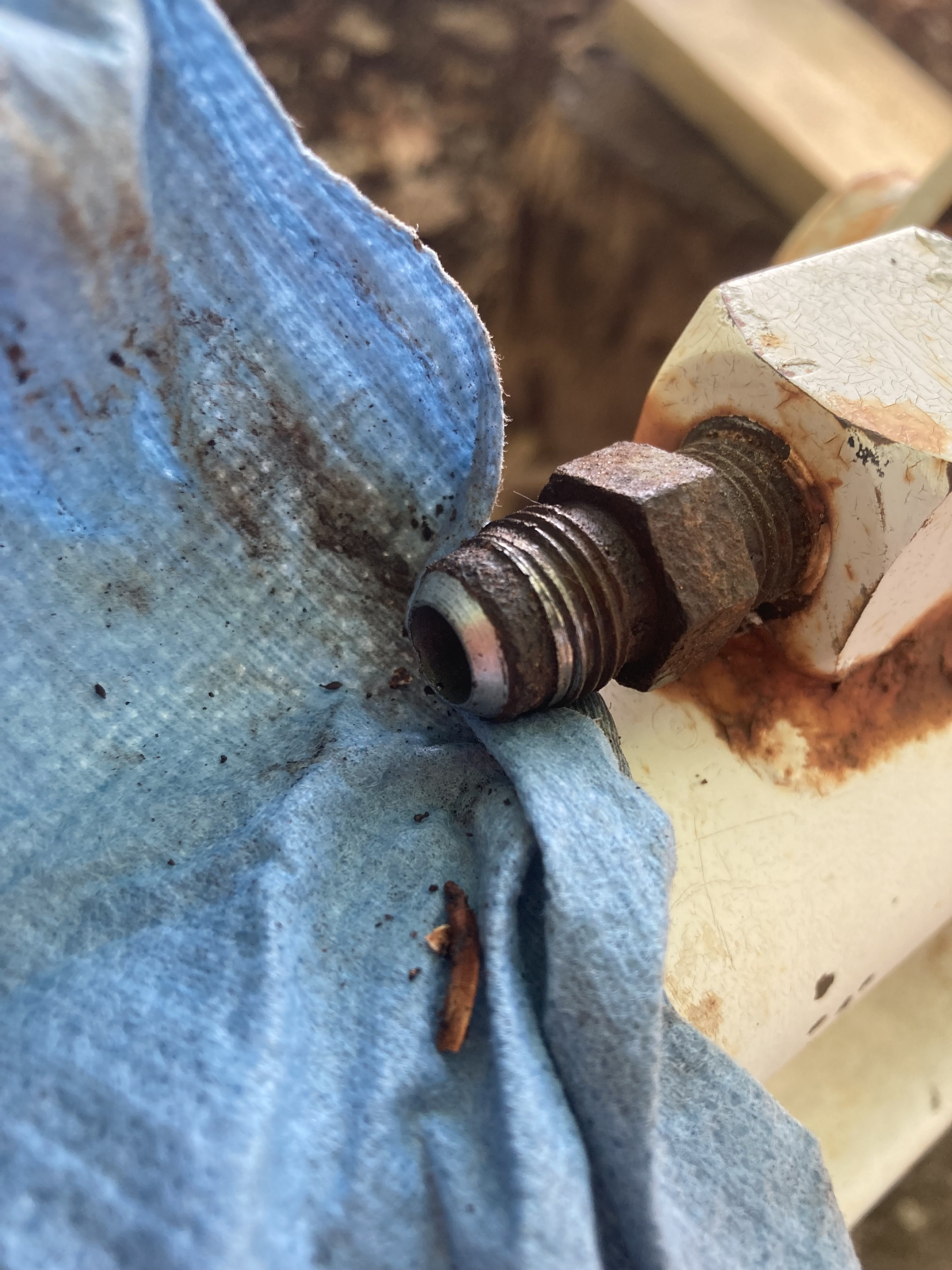

Couldn’t find one at TS. Seems they have mostly 1/2” and I need 1/4” so I’ll order one online tonight. What are these fittings called? Both ends of the hose are female and have a flared in shoulder.
