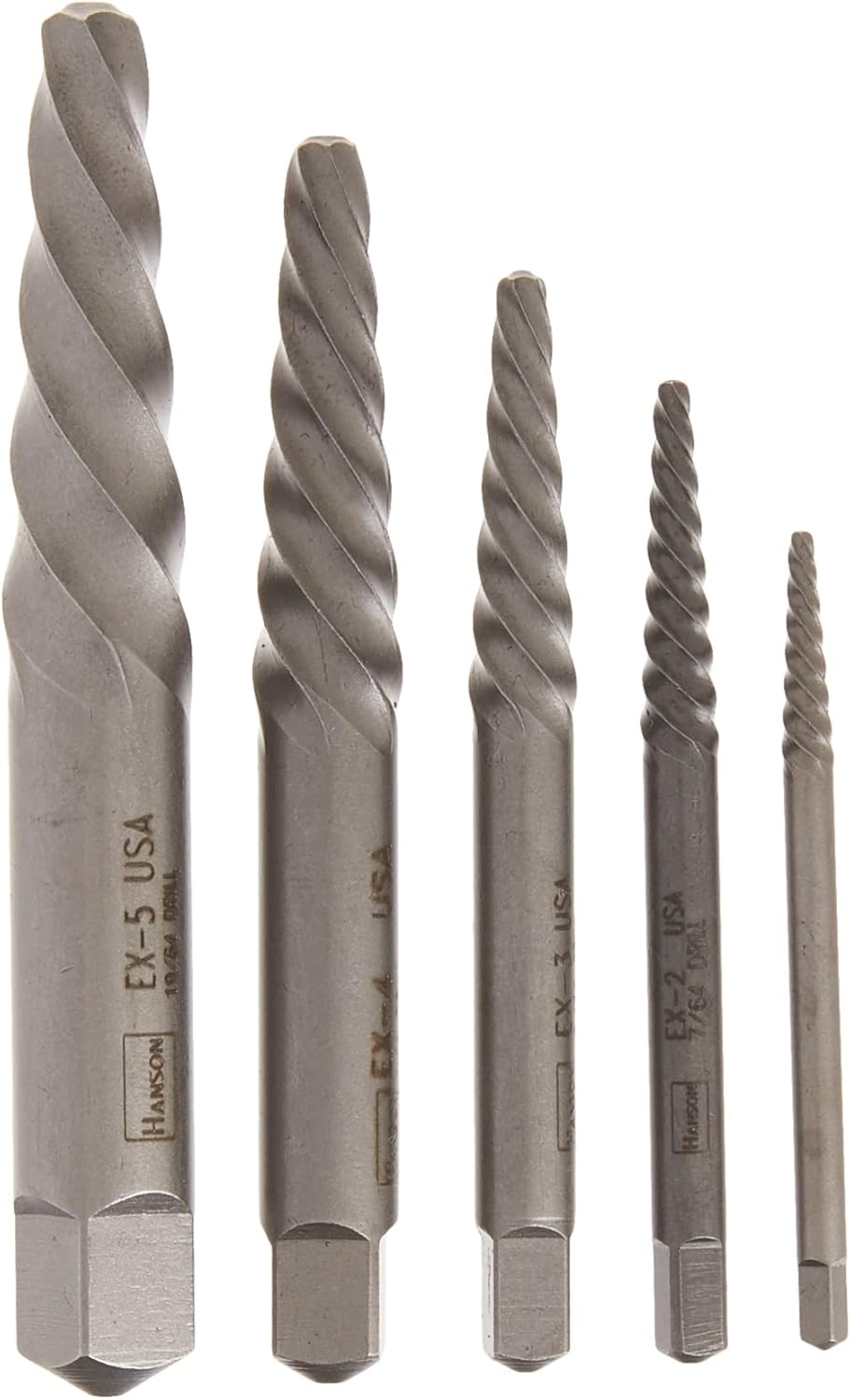

If you still can't get it out, use a screw extractor on the inside of the fitting:
Make sure you clean out all the metal chips to keep them out of the hyd. system.

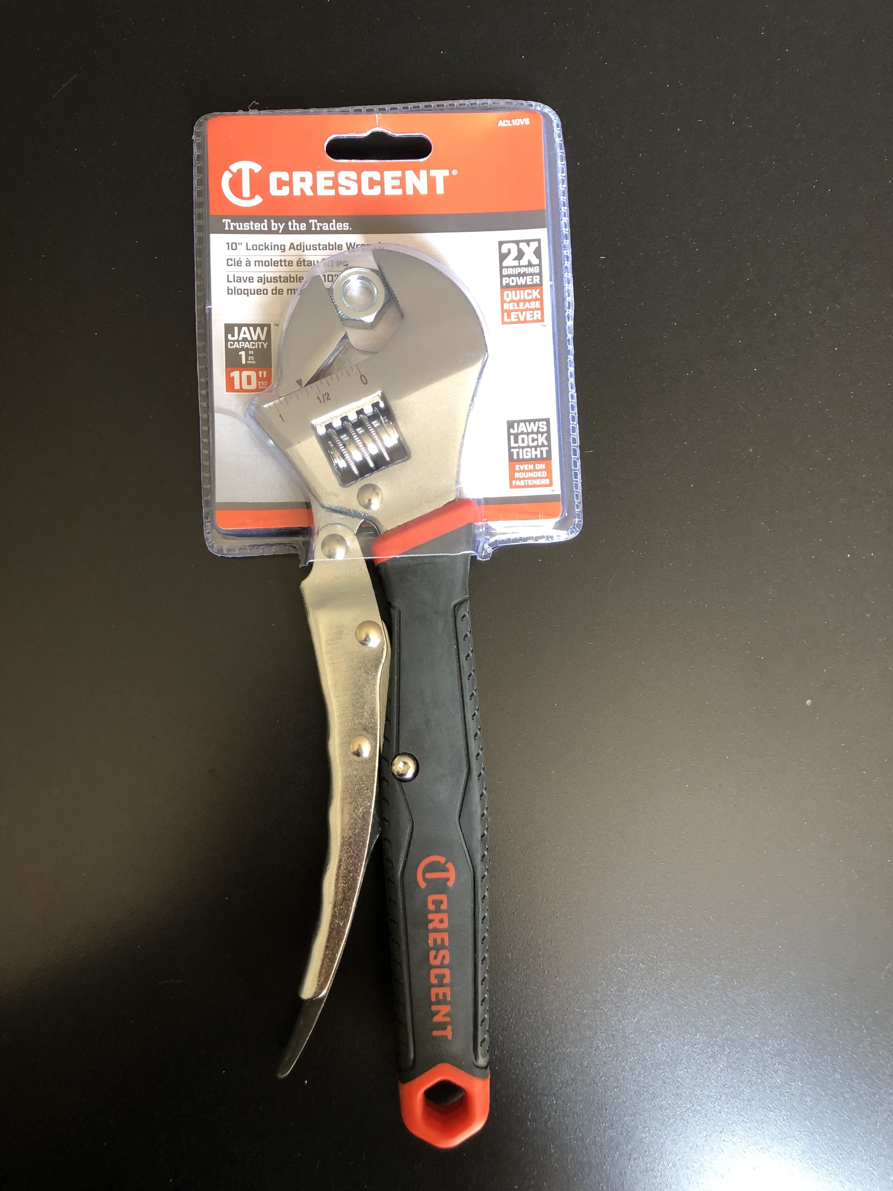

Tried vise grips, as well as this locking crescent wrench. No dice……. The metal nut is almost too soft.

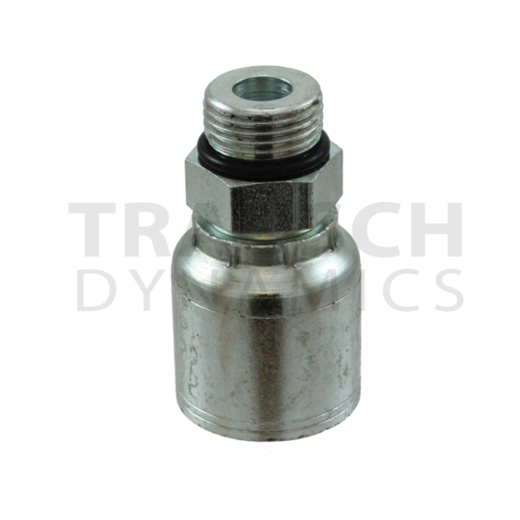

That sure looks like an ORB/SAE fitting, so there should be an o-ring. If there isn't, and you tightened it enough to stop it from leaking, that is the real issue here.
You can see the O-ring squeezed out in the first photo. The fitting had been severely over tightened. I still think that regular jaw vice grips can remove them. Then new hoses need to be purchased and properly installed.

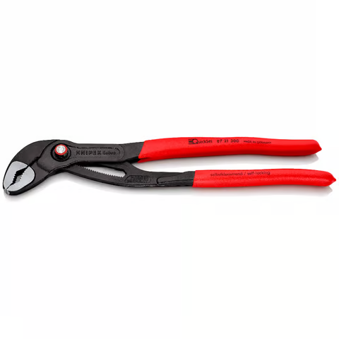

When I have had problems like this I will use the 12 inch Knipex pliers and has worked very time
