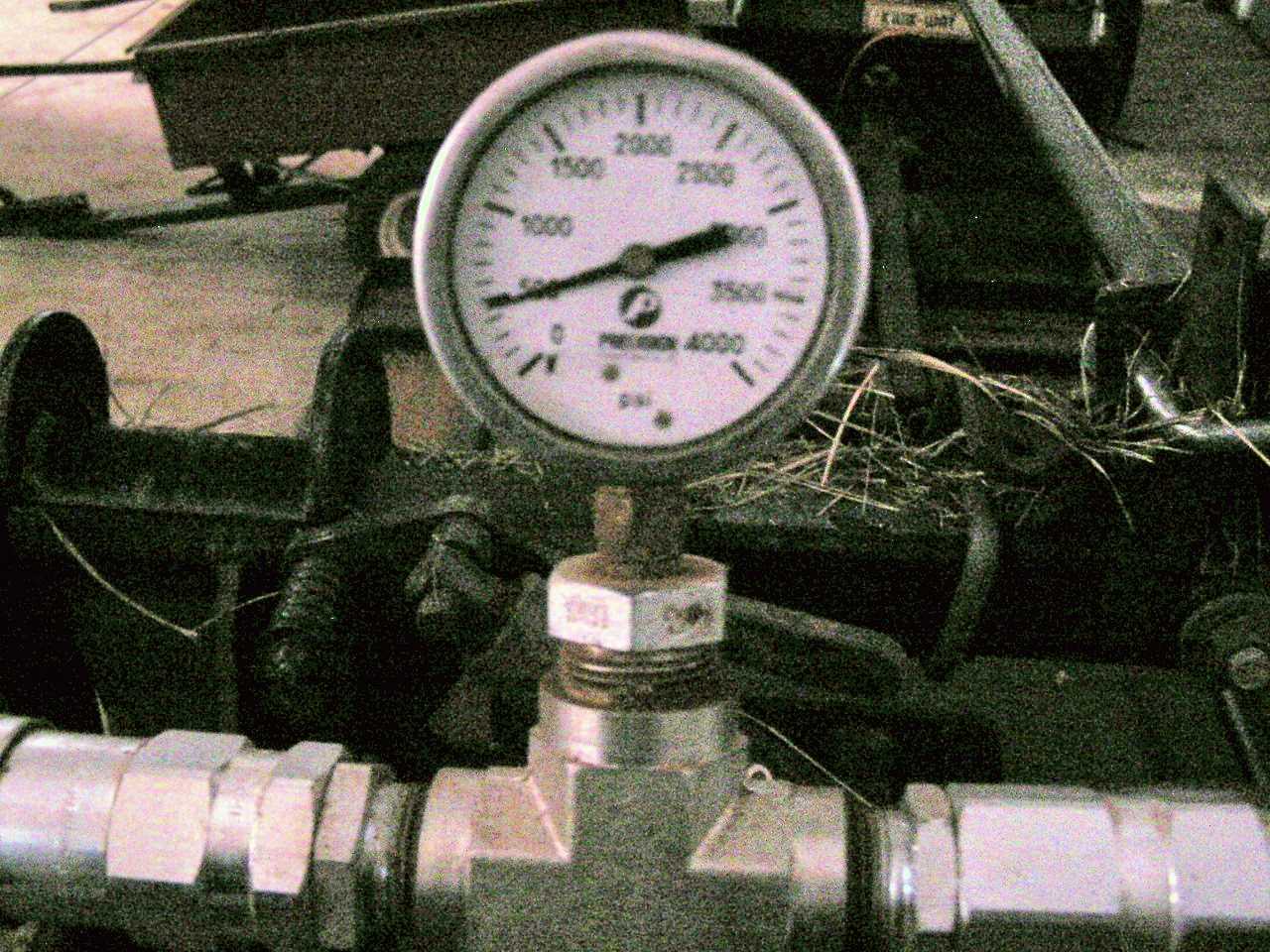

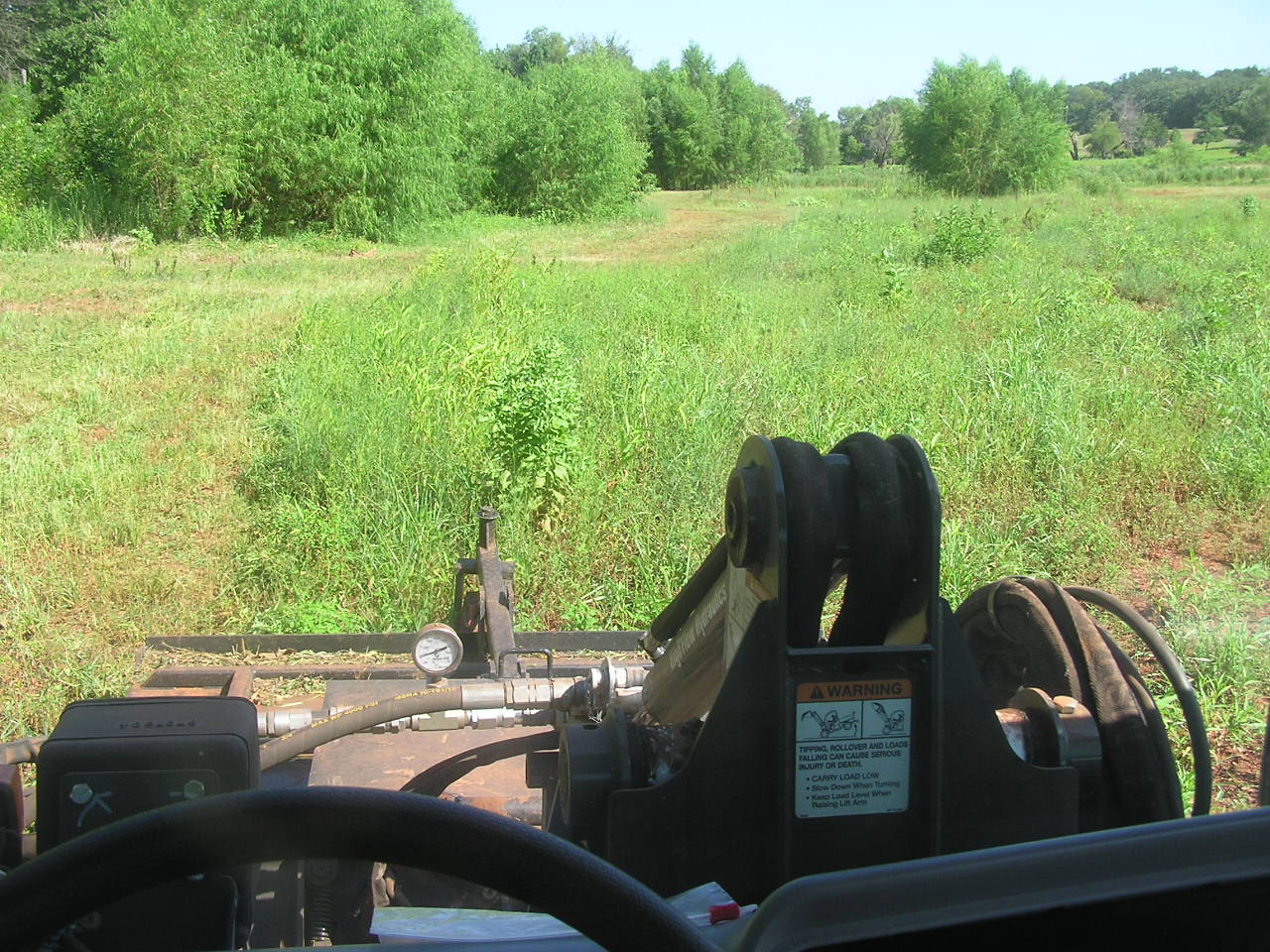

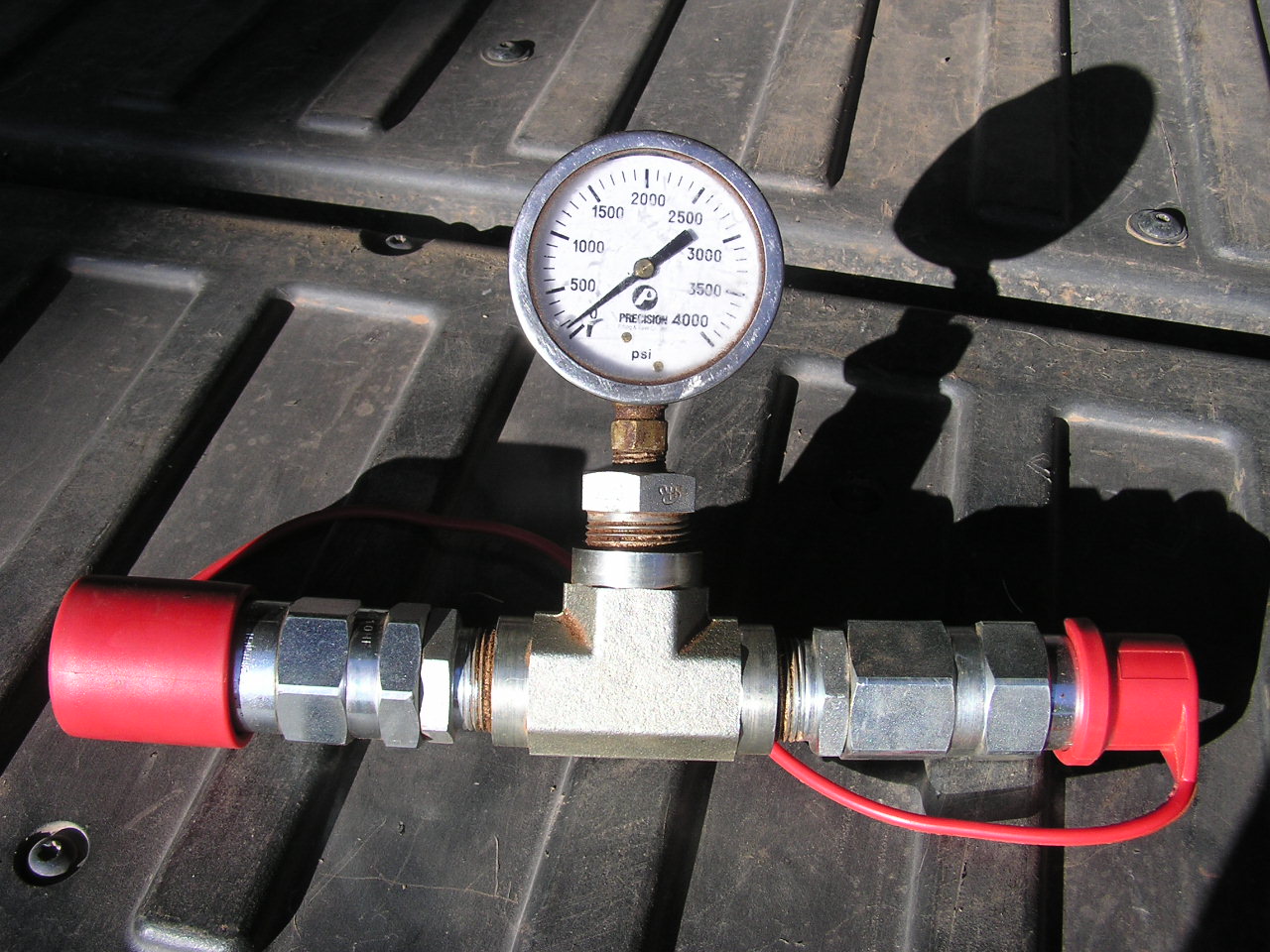

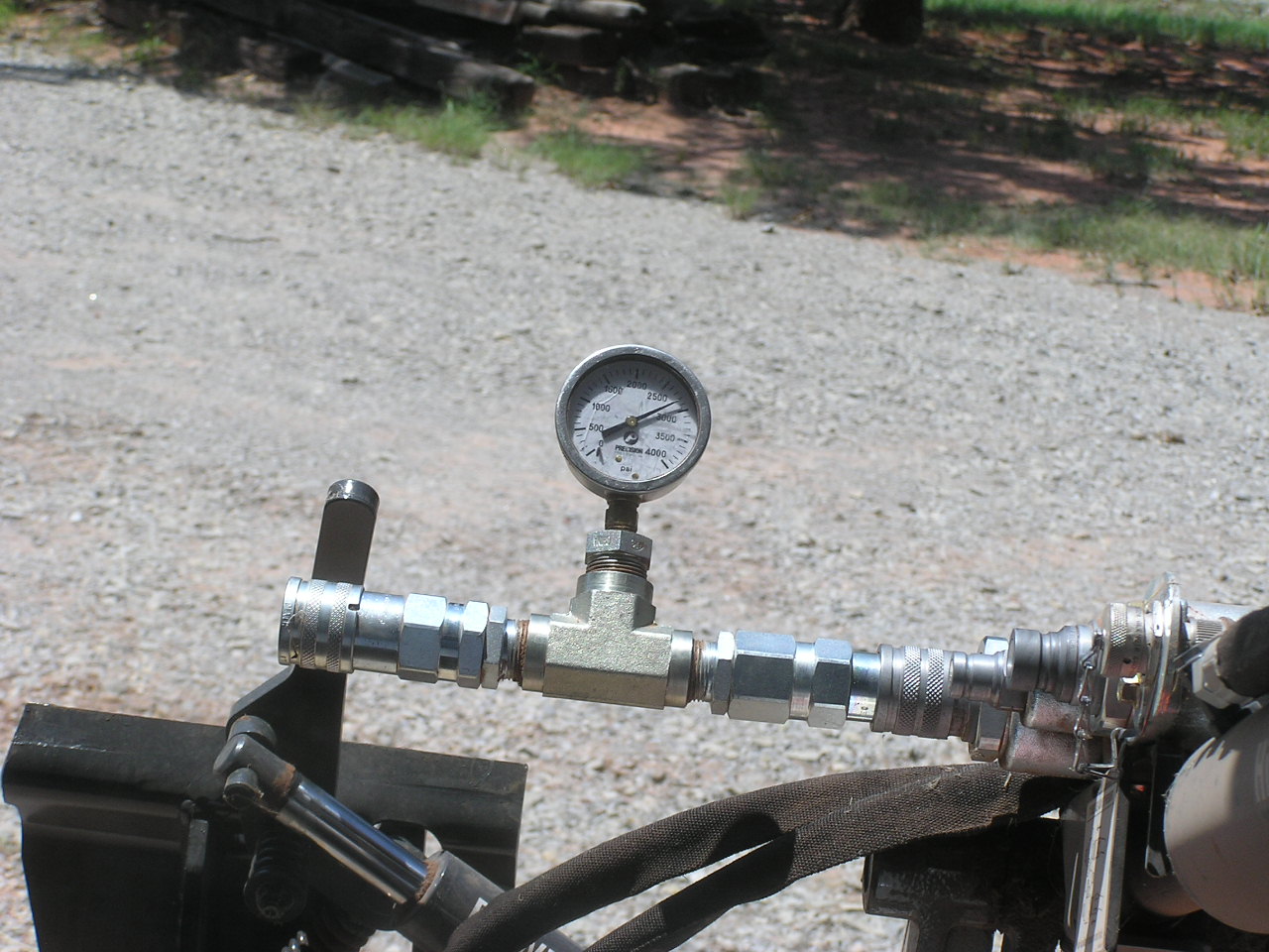

The couplers are different, but this is how I did mine:
Plug it in to read max pressure:
Plug in the hose to monitor operating pressure:
