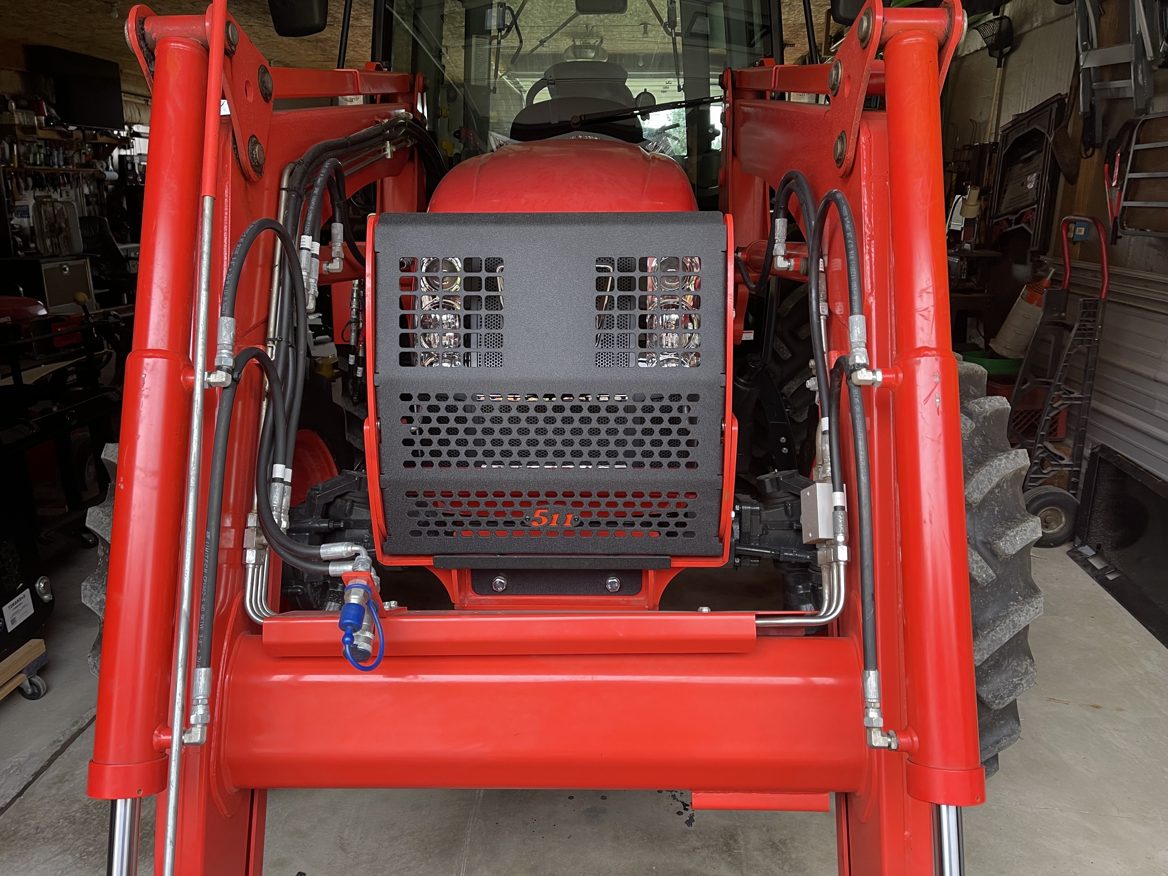

Have a 5Eleven Designz on My Rx and Love it. Great quality and very stout. He has several for the Kioti tractors. Web site 5elevendesignz.com

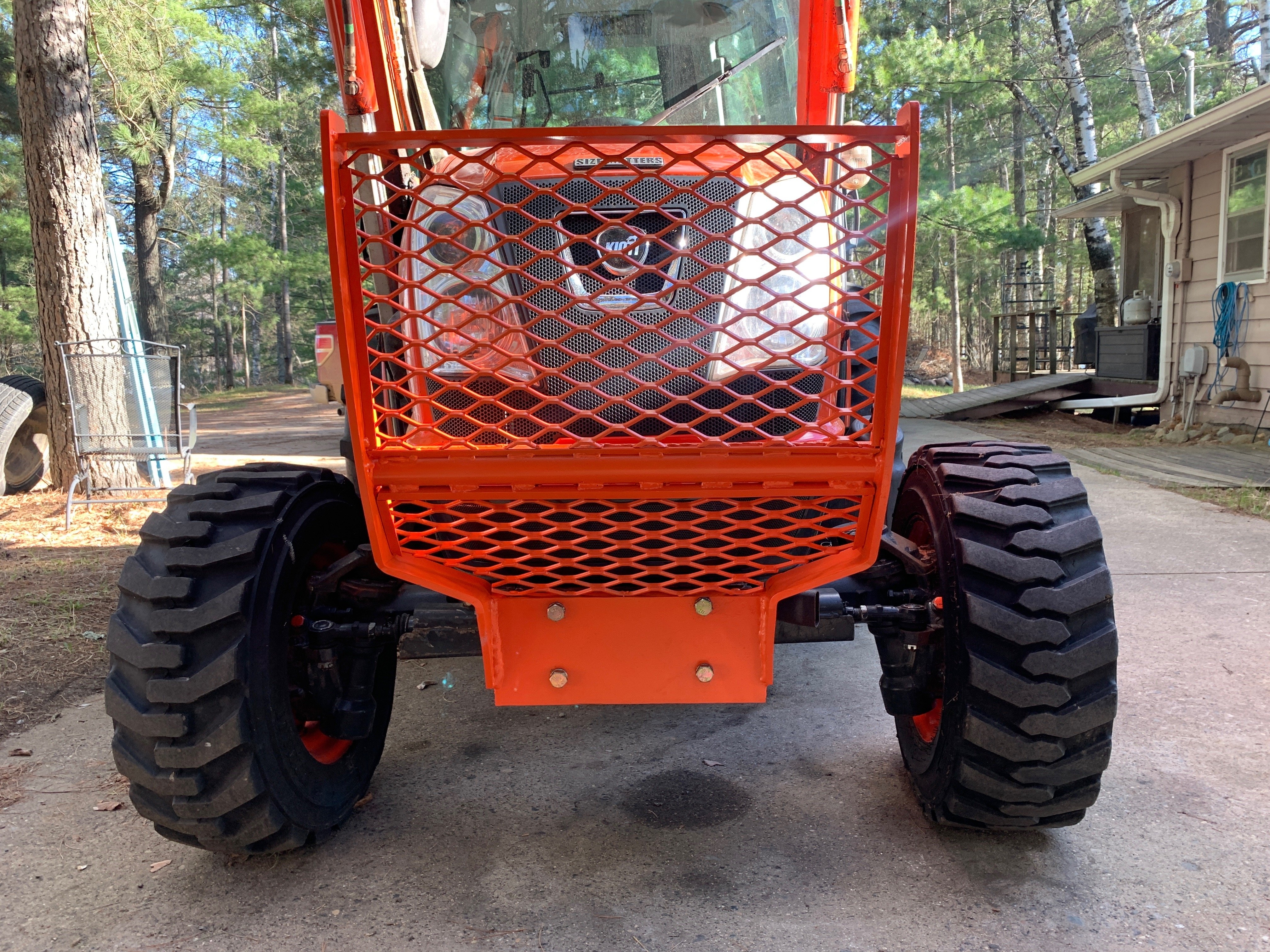

Last fall my buddy, Mark, was eager to pull an oak log from a slash pile to help heat his home over winter. He and I have done piles of work together working on hand signals (installing hi-lift conveyor systems, building red steel sheds, moving containers, et cetra). Anyway, Mark directed me to crush in and wreck the front grill of my tractor.
Whoops. Bad buddy, no dinner! Smile.
So this spring I removed all the broken grill bits and ordered in $400 of new, not-broken grill bits, and pulled out the hood's grill bits cross member support. To avoid future not-paying-attention-episodes, I welded in some heavy expanded steel into my grill guard in the hopes to avoid another $400 in parts repair.
Now I'm waiting on warmer weather to finish rattle-canning my brush guard Chevy engine block orange before putting it back on my tractor.
If you do this tips:
1) Do what I did and get a larger-than-what-you-need-chunk of expanded metal so you can trim it and make it symmetrical.
2) I used 1/2" angle iron around the edges, but if I was to do it again I'd go with 3/4" angle iron as the heavier the expanded steel, the harder it is to work with getting it even so it looks symmetrical.

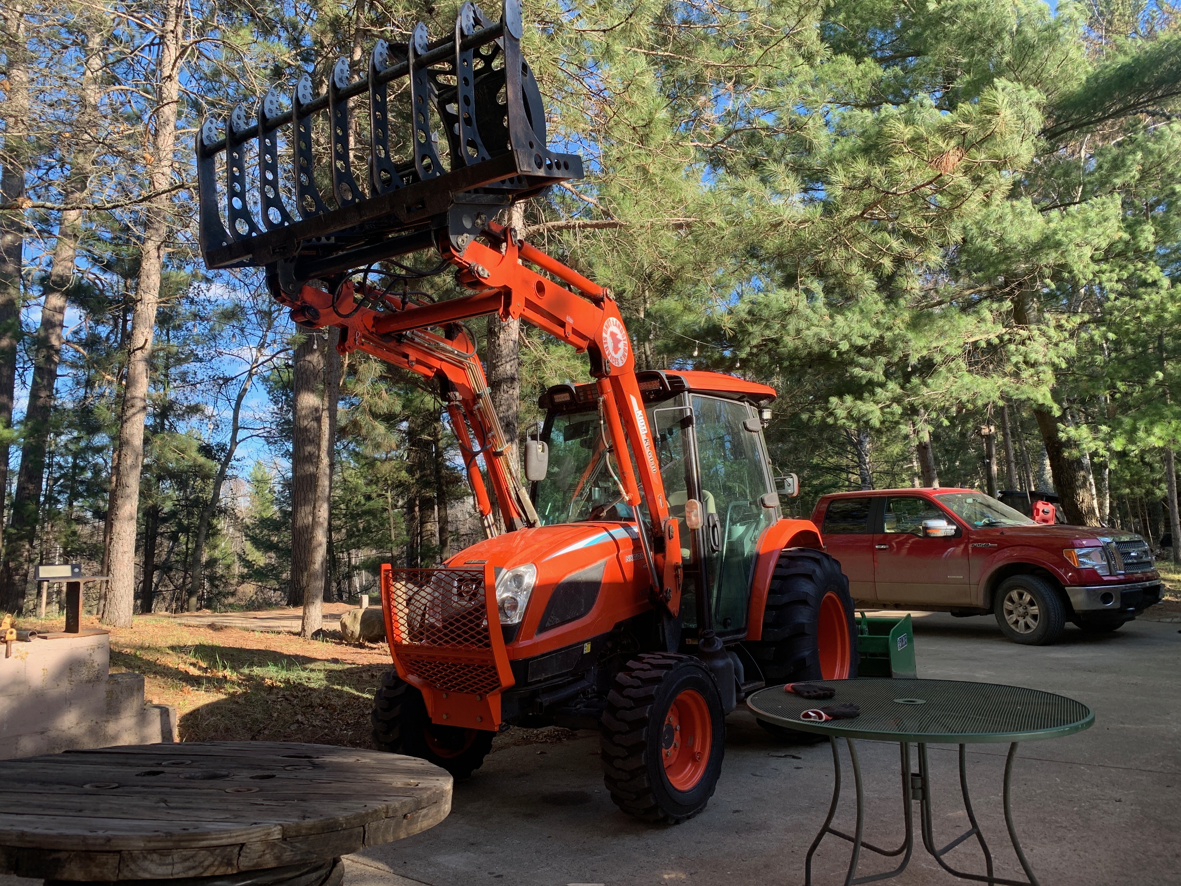

That's a heavy duty grill MinnesotaEric, nice welding job.
I welded a lighter expanded-metal sheet onto the stock frontguard and it's been stopping the brush and branches too.
