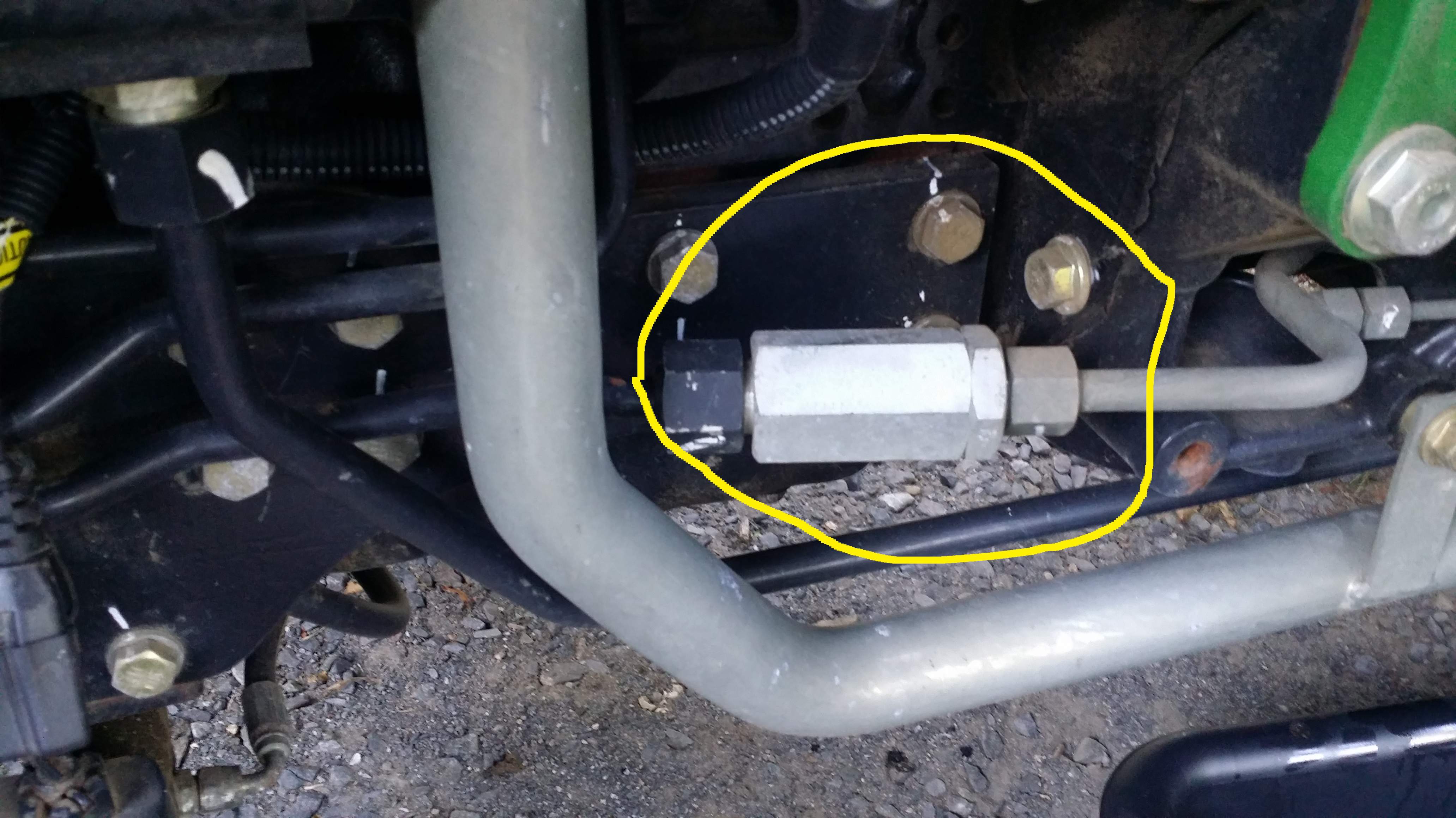

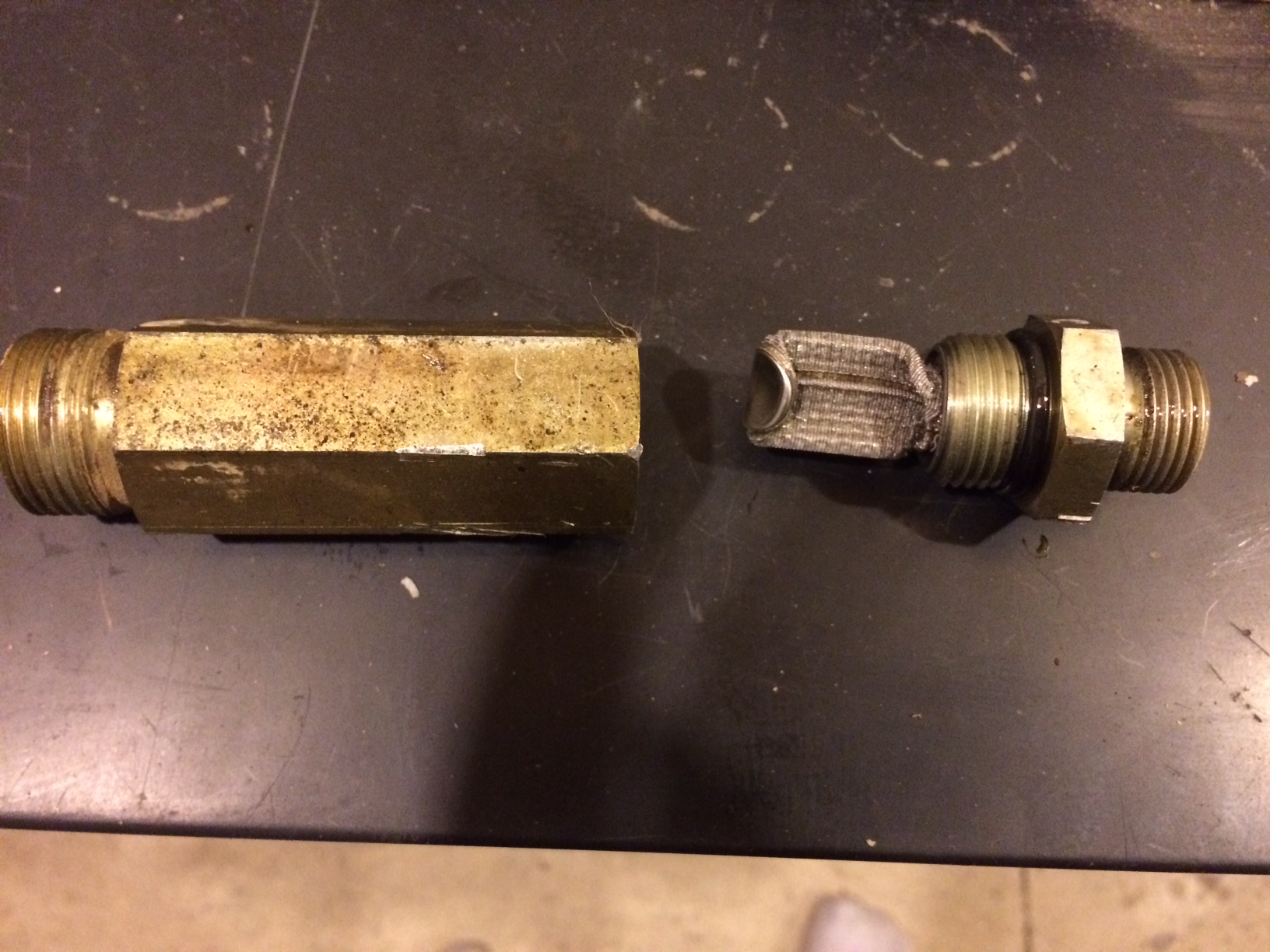

I have a 05 4320 with 1450 hours. My screen in the axle/trans housing was clogged (see photo) 20200930_133653.jpg20200930_133653.jpg. My inline screen was collapsed so i ordered a new one. The new one #LVA12726 is larger than the original (see photo). When removing screen from axle housing put your finger up and feel for debris. Mine had a little but no metal pieces. My machine would still drive but my loader would not go up and the steering would cut in and out. I think most of my problem was the strainer/screen in the axle/trans housing was clogged. Before i removed axle/trans housing strainer i replaced the in line screen LVA12726 and the hydraulics only improved slightly. After cleaning the trans strainer the hydraulics worked fine.20200930_153612.jpg
