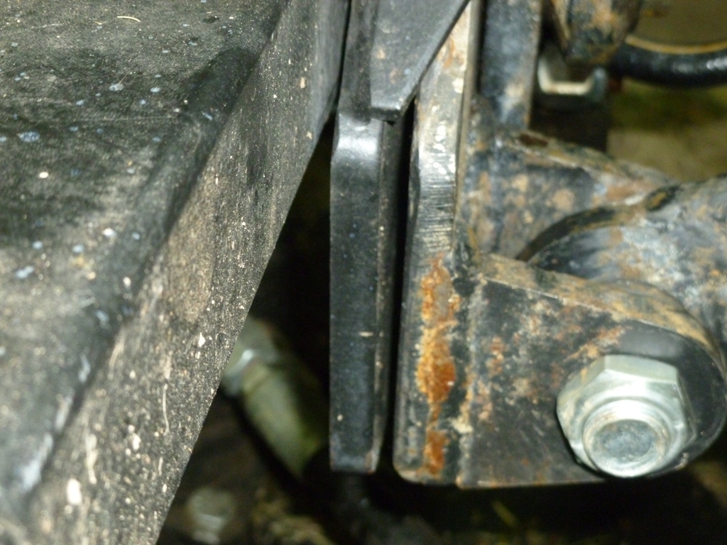

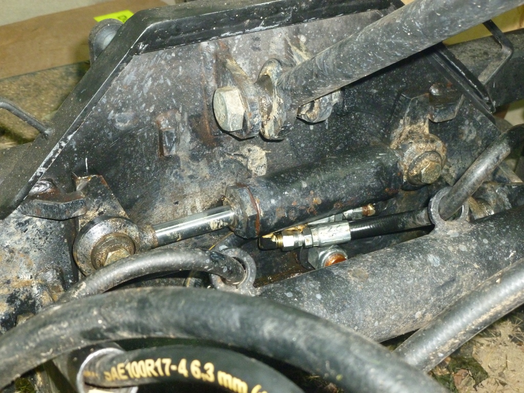

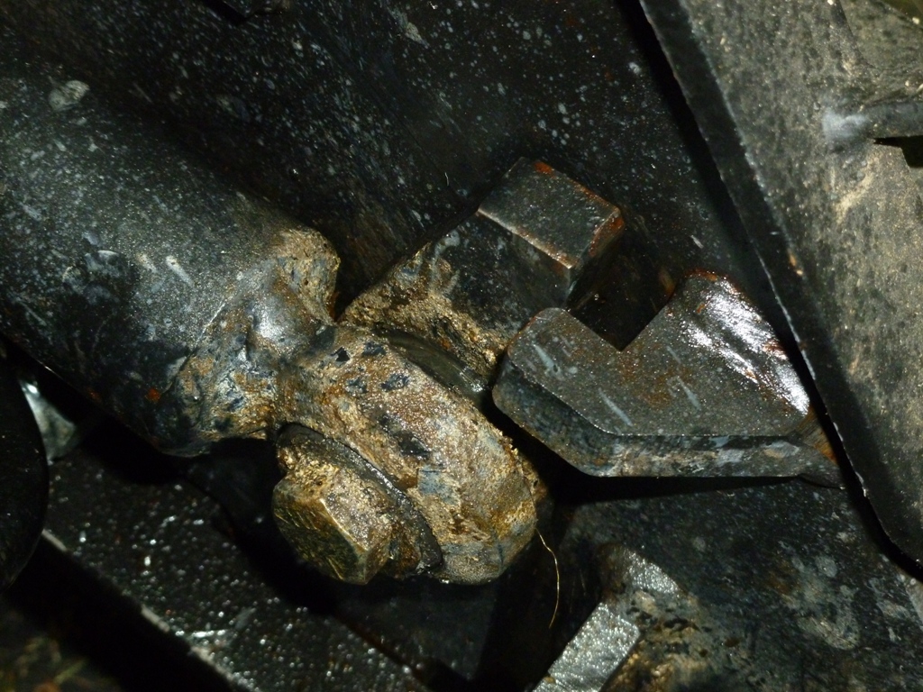

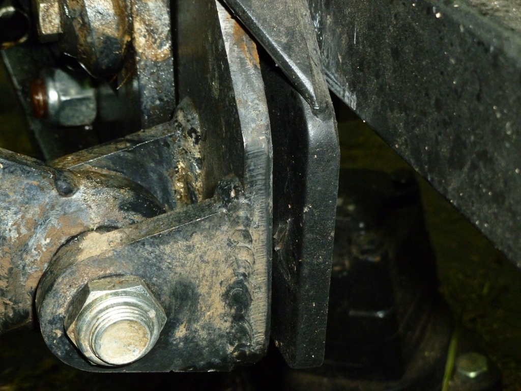

Okay. I tried the lubricant and tapped with a hammer. No luck. It really seems like something is binding, but I sure can't see what. Here are some pictures showing the QA as far open as I can get them. There's also some pics showing a bit of space between the QA plate and the plate on the brush cutter. Is it possible that I bent the QA plate on the tractor and that's what's binding? I don't know what the next step should be....
And thanks for your thoughts.

Update: The slots that to which I am referring are the ones at the bottom. Your photo shows the ones at the top. However, they both have to retract for the plates to disengage. Also, hang in there. There are veterans on this forum with more knowledge. They are probably enjoying seat time now and will be checking in later.
The gap indicates that the pegs did not sit in the slots because the QA was not curled enough to seat the male part on the lift arms with the female half on the attachment. That happens on my PT. I have to disengage and re-engage to seat properly.
Check from the bottom to see if the pegs are actually in the slots. If they are not in the slots then try this: start the tractor, place the joystick in float mode, push the Aux lever down to see if the pegs move up fully. If so pull the joystick out of float and curl right to disengage. You may have to work the Aux lever up and down a few times. You also may have to right curl then raise the mower 6 inches and jiggle it by raising and lowering a few inches to try to snap it free.
If the pegs are in the slots they are probably bent and jammed (there should not be a gap that wide.) You may have to dismantle the QA to fix replace the pegs etc.

Well, the pegs are most definitely in the slots. I guess it's time to try and dismantle the QA. Looks like taking the bolts off the ends of the QA cylinder may be the place to start. It looks like I could then see if the pegs will move freely or if I have to beat on them.

What is really strange is that there are gaps on both sides at the quick attach plate.

It is very strange. I may see if I can get a better picture. It really looks like the QA plate is bent. It looks bowed. For the life of me I can't figure out how the heck it would have gotten like that. It really looks like I'd have to have been moving top speed in reverse and hit something with the mower deck so that it really yanked hard on the ends of the QA plate. All I did was mow the yard and mow some high weeds at the edge of the yard.

Is there anyway that something has gotten between the plate on the attachment and the plat on the machine, or maybe something has gotten in the slot at the bottom of the plate maybe has something in it and blocking the movement of the pins? The rod on the cylinder looks like it is rough, but maybe it is just dirt. If you could get someone to work the lever while you observe the movement up close that way you might be able to see where it is binding. It looks like one side is coming closer to disconnecting than the other maybe that is a clue as to where it is binding.

Or, you could just remove the two bolts that hold the QA cylinder onto the pegs and do the same thing. ;)

Alright guys. Thanks for all the help so far. Here's the update. I took the two bolts off the QA cylinder and the cylinder works just fine (thanks for the tip JJ, but for now, I'm assuming the hyd system is fine). Tried all manner of beating on those pegs and I can move them to the fully locked position but can't get them to budge past the point of releasing the QA plate. I then removed the bolts on the three arms hold on the QA plate (hoping to perhaps relieve some tension) and beat the crap out of those pegs and still can't budge them. Any thoughts on my next move? Bigger hammer?

I would unbolt both the receiving plate from the attachment and the male plate from the lift arms and replace both with new. Once removed you could probably beat on them enough to get them apart, but they are probably weakened enough so they could bend again...
Using the 3pt adapter with the box blade made the distance longer from the QA plate to the edge of the blade causing an awkward angle that caused the plate to bend when force was applied. Just a thought.

Can I suggest trying to put enough clamps on the attachment and QA plat to bring them into better alignment? You might be able to free the QA levers and then release the clamps and the attachment.
It sounds as if your QA plate on the tractor bent somehow.
