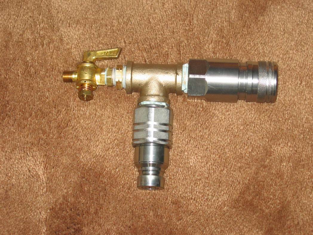

I was hoping to get a tool like the one I Linked above. That tool is designed to Press the connectors together without squirting a shot of fluid every time I reconnect. I already made a simple pressure relief tool. One male and one female Connector attached to a Brass Ball Valve. I works fine but I was looking to keep all the Hydra Fluid where it belongs.

Looks good. Not many available in Ohio though. Question?: Is it your experience that it's always the male coupling that causes the problem? BTW I noticed the Waite Decompression tool is now $65 (11-5-22). I'm leaning towards fabbing one myself that pushes the male into the female like Tony H mentioned previously in #8 above.
