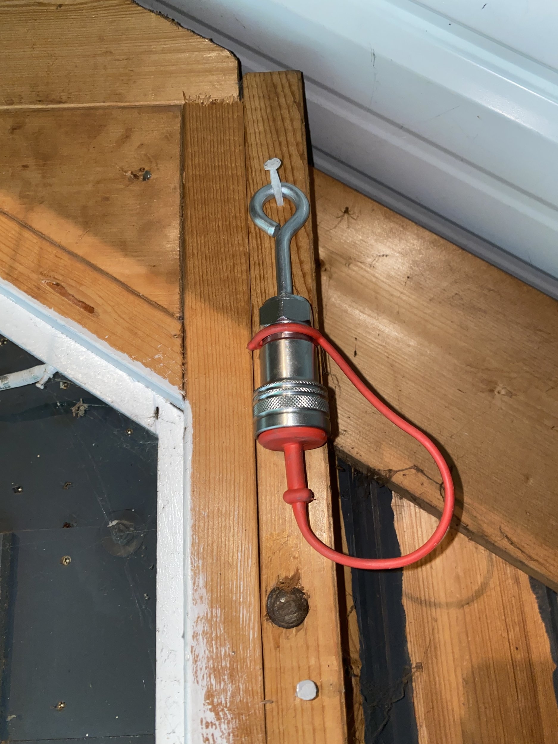

I could do about 5-6 implements for the price of the tool.
Check my post #2, Moss. I built mine using a spare fitting I already had in a drawer, but even if I had to buy a fitting, it'd have cost me less than $20 to build that tool. The BOM is pretty simple:
1. Spare female coupler (mine was 1/2" NPT back end)
2. Plug for back end of coupler (in my case, 1/2" NPT with hex key drive)
3. Eye bolt (in my case 3/8" UNC x 4")
I just drilled and thru-tapped the plug to 3/8", threaded it into the fitting, and then the eyebolt into the plug. Done.

This pressure relief tool is cheaper, easier, and more quickly at-hand than all of that. I keep it hanging from a nail on the door jamb of my shed, where I keep all of my equipment. If you don't ever need one, consider yourself lucky, but it's very handy for those of us who do.

I do all the tricks and still can never get my grapple connected easily. I modified a clamp to be like the one shown before I had heard that such a thing existed (missed THAT market opportunity!) and I have to use the clamp to apply pressure and still do a couple more rounds of jiggling the valves to get the flat faced connectors together.
