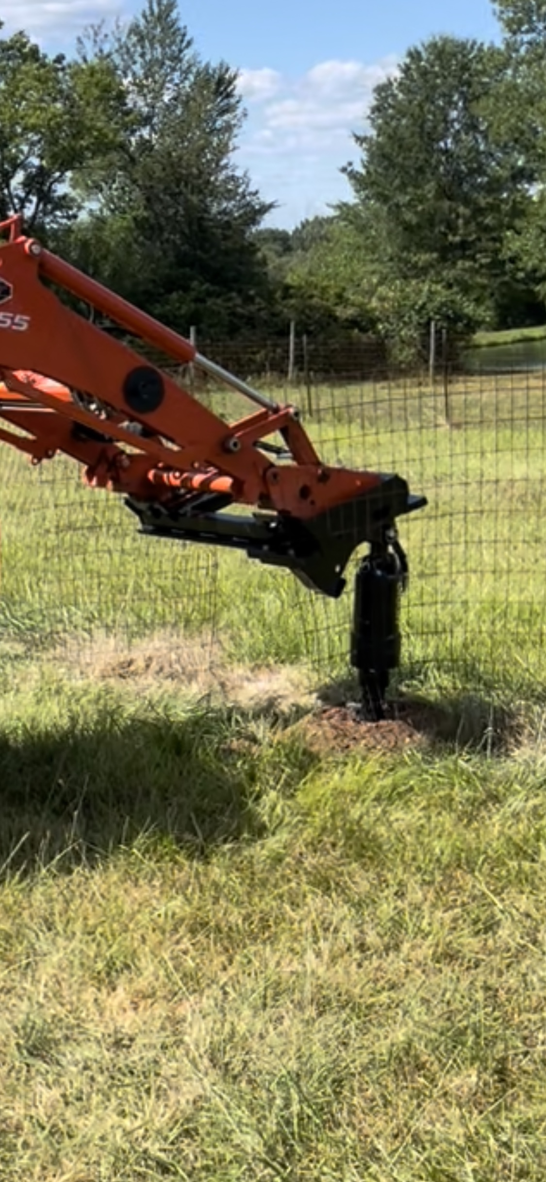

Digga 1DSS ordered. I got the 12 inch tungsten bit and made sure they spec'd the adjustable mount.

Found my LP SA20 auger at a Kubota dealer that also sells construction equipment. Has the medium flow motor, it's slow (way faster than hand digging), never had to drill new hole because of striking tree root. FEL has enough weight to use float for down pressure. When tractor starts to rock sideways, pop it out of float, auger needs time to chew thru tree root. Applying down pressure only raises front axle and tractor will twist right or left. You'll have to pull auger and realign tractor to finish hole.

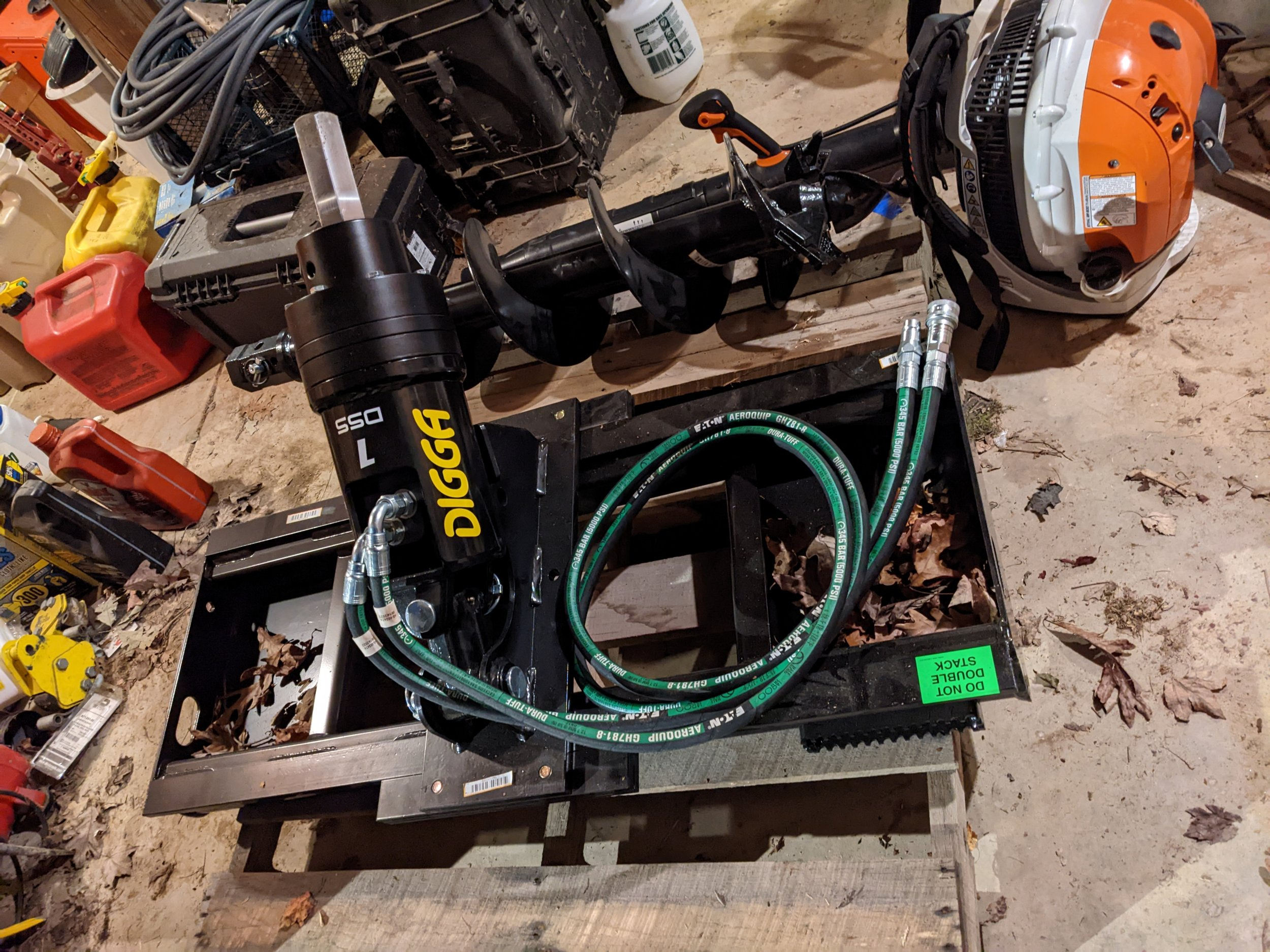

I got my 1DSS last week. Has anyone with a hydraulic auger figured out a good storage solution when not on the tractor?

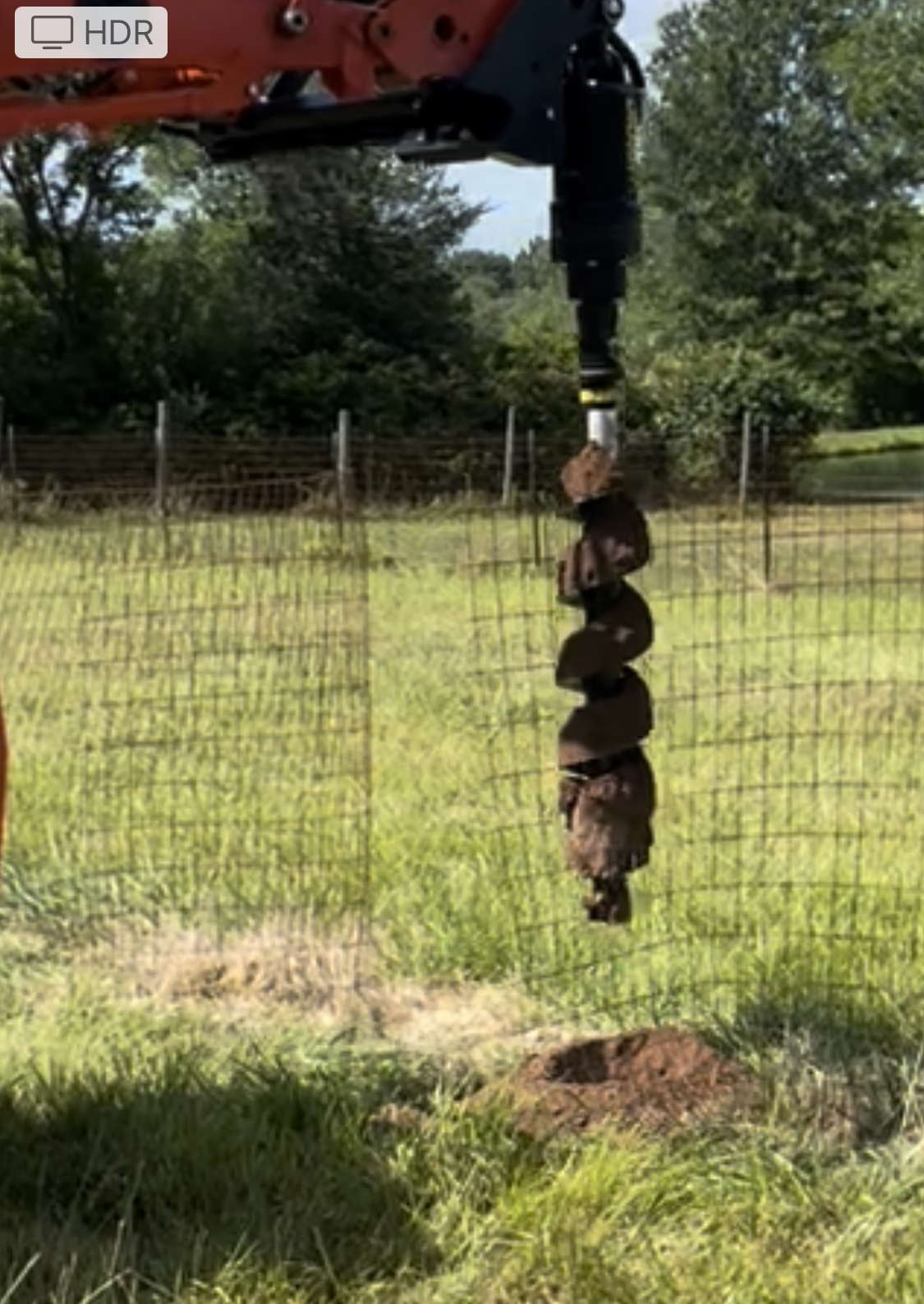

I dont have an auger for my loader but I do have one on a 19hp micro EX. Even with my hard clay/shale and a 12in bit it never really hit anything that you couldn't work it though. It's very hard to stop the auger and you can actual aim the auger. Mine dosnt spin fast enough to throw the dirt out so in a 12x48in hole you may have to remove the auger 3-4x including a clean out pass. Way quicker than a single stuck 3pt auger.

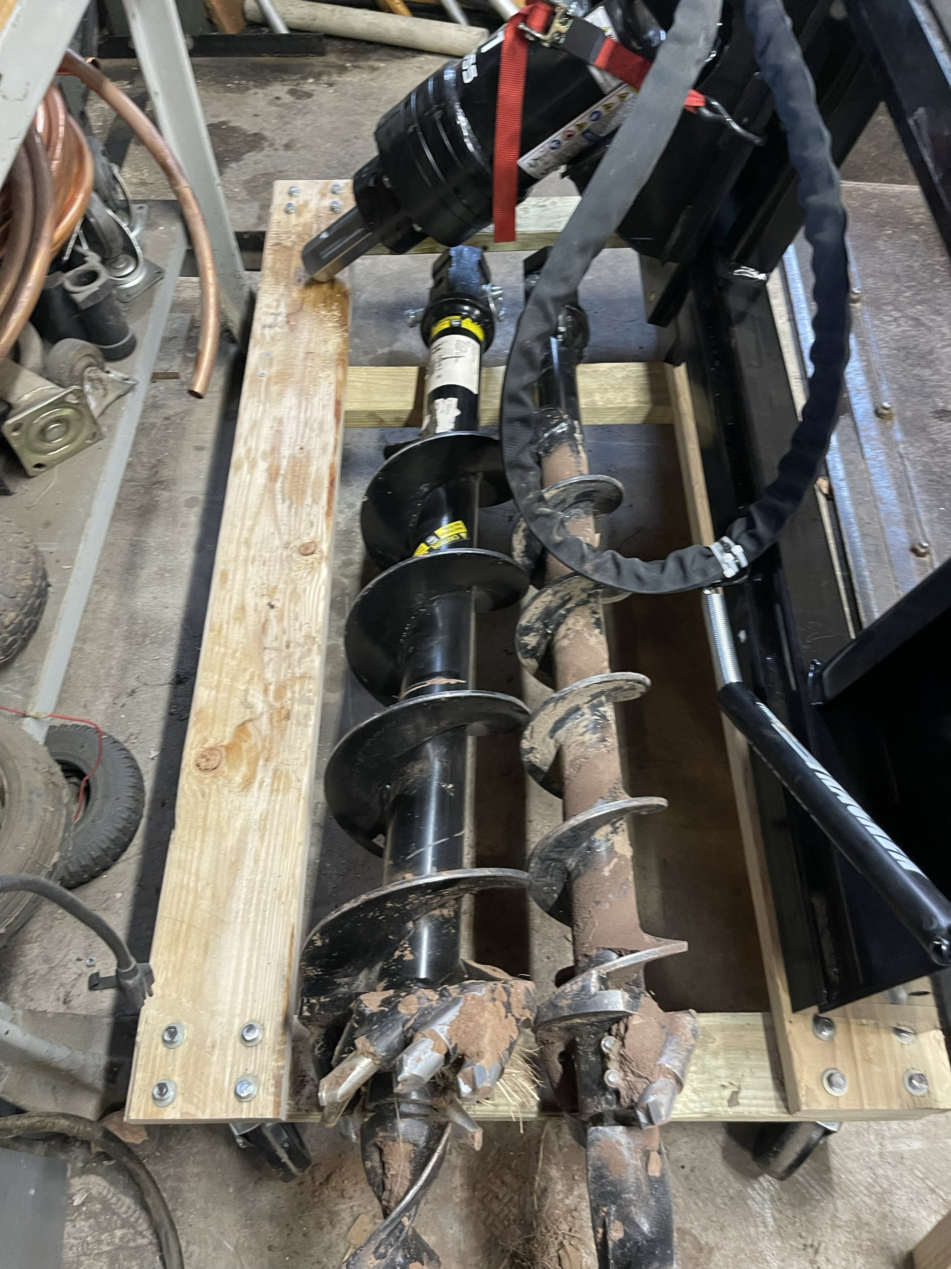

I built a dolly with pressure treated lumber and heavy duty casters from HF.
Nice dolly. Any chance you could post a picture from a little further away? Specifically, showing how the ssqa plate is situated.
I bought an ssqa hydraulic auger last year, and had hoped that it would store easier than my previous 3 point octopus.
At the moment I am doing the brute force, totally disassembled approach.

Here you go. It is incredibly simple, the key is to secure the the gearbox to the saddle with a ratchet strap. I added an additional cross piece for augers to fit on it as shown in the first picture. It is so easy to mount that it isn’t even a consideration for drilling a single hole, unlike the old 3 point one.

Thanks for the additional pictures and info.
I'll give the dolly andratchet strap a try!

I wonder if you bolt some metal to block the forward movement of the power head like... (plz excuse lousy art)
you may be able to drop it down in one go without the strap?
