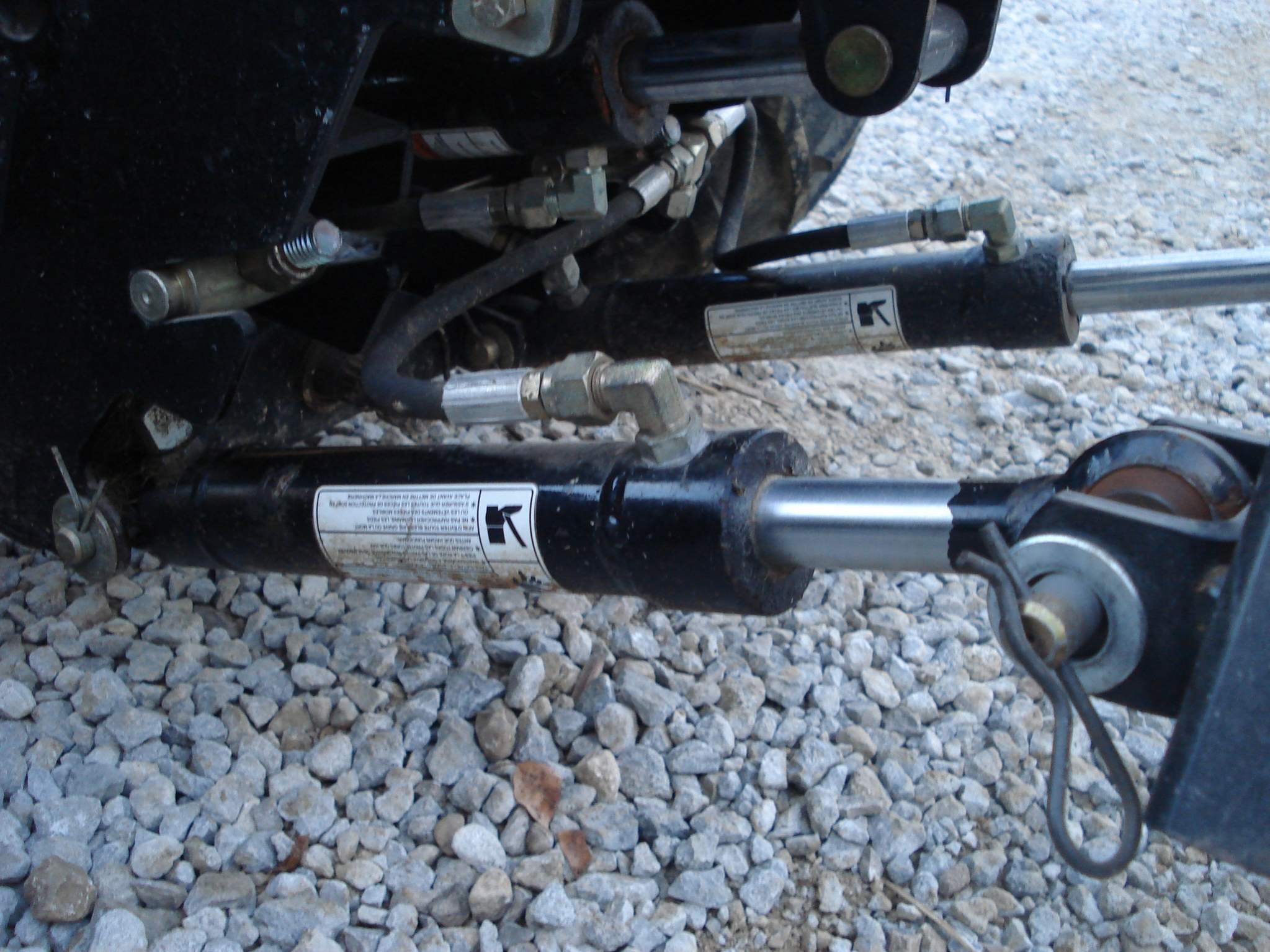

Greetings,
Does anyone have the specs on the hydraulic cylinders for the front mount angle kit (590-623-100) for the 5000 / 6000 / 7000 series Cub? Nothing is available thru the dealers and on the usual Ebay, Craigslist. I tried matching up the fixed link to available cylinders from several suppliers, but nothing is intuitively correct. So if you have diameter x stroke, and any other specs - greatly appreciated. I can work on the rest.

If no one else responds I can get you the measurements in 3 weeks, when I get back home. I've got an angling kit on my 5234. I would think there should be some aftermarket cylinders that would fit?

No problem....I get home on the 8th of October. I will get measurements and pics directly thereafter....
/ Hyd Cyl for front hitch angle kit?? #6
OK....looks like body length is 11".....the piston bore is 3/4".....I will get some more measurements tomorrow.
Just double checking, are you sure on the 3/4" bore? That seems kind of small compared to most cylinders I've seen for this use. Maybe because there's 2 of them instead of 1.

Sorry for the delayed response gents, been up to my ___ in projects.
Yes, the bore is 3/4".
The extended length is ~ 21", and the fully closed length is ~ 14".

Scout, Thanks for the further information. I have been looking at a 1 1/2 x 6" stroke from Surplus Center and the dimension are about 1" shorter. But nothing else is even close. Guess I'll keep looking. I would hate to have a custom one (2) made up. --- Tom

Those measurements were from center eyehole to center eyehole, not total length....hope I didn't confuse anyone.

Yes, Here's what I ordered from surpluscenter.com
I measured the hole to hole length of my lift and its close to 18". These cylinders have a 14" closed length with a 8" rod length. That means that when the cylinder extended halfway it will be right at 18". The diameter of the rod isn't quite what he spec'd but I couldn't find anything closer with swivel ends. This is everything needed for an angle kit. Cost is less than just one hyd cylinder from Cub.

Got my order today and noticed an error right off. This item:
"920-2218 1/4" X 18" JIC 4F X JIC 4F 5000 PSI HYD H 14.98"
should have been a JIC 6F X JIC 6F . When I reordered I also only ordered a 12" length which is plenty. Test fitting looks okay but I won't be able to assemble it until the weekend.

Cub, Keep that info coming!! I return home at end of next week and plan on measuring and ordering up the parts then. We've already had our first snow and I need to be ready. How did you address the 1/2" cylinder swivel holes and 5/8" pins on the mount? -- Tom

I haven't mounted it up to the lift yet so I'll have to see. If the hole is for a 5/8" pin I might have to sleeve a 1/2" pin or worst case would be to weld new plate and drill a new hole to fit 1/2". Either way its not a problem. Right now I'm elbow deep into a 5234 transmission rebuild.
