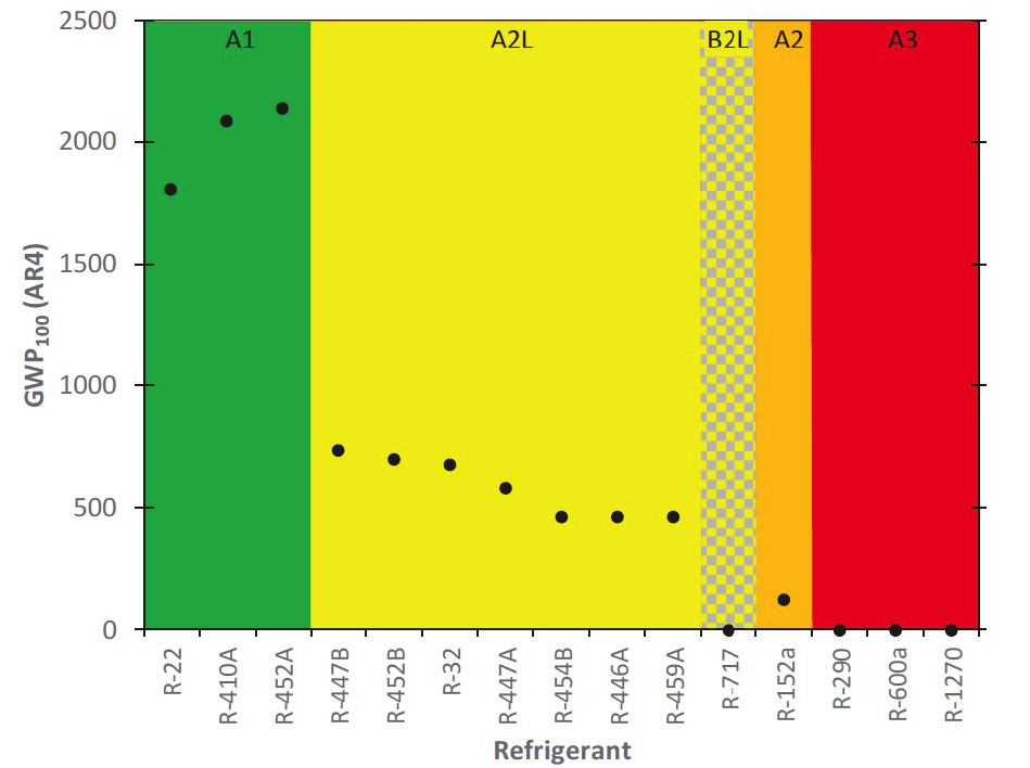

What refrigerant are new units using?
I believe 410a is going away but I see lots of 410a installs.
Anyone have a preference between R32 or R454b?
@Sigarms is more knowledgeable than me, but I don't think it is simple. There are advantages and disadvantages to both. R32 is slightly flammable, but more efficient, higher capacity, with low GWP, R454b is less efficient, but not flammable, and lower GWP. R454b was designed as a drop in replacement for R410, and R32 may work in some R410 systems.
Then there is R-744. More complicated to manage and install, but with lots of advantages.
Cheat sheet;
All the best,
Peter

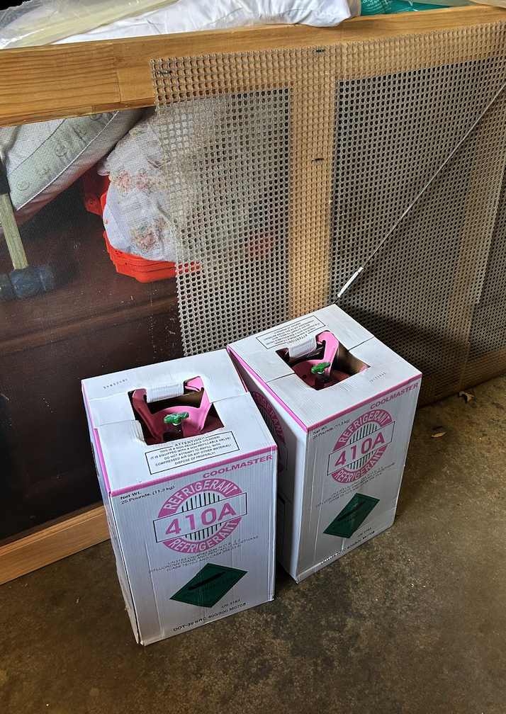

I will replace two systems next year. This is what I stocked up on for my own house for all 3 potential systems LOL
I still have a jug of R22 on one system I replaced around 2003 because I didn't trust the R410A systems when they first came out LOL (now, I have two systems using R410A).
There is no drop in replacement.
It will be illegal to even try to convert a residential or commercial HVAC system from R410A to R454B or R32.
R454B and R32 is considered a A2L refrigerant. R410A is considered a HFC refrigerant.
The new A2L compatible HVAC equipment will have a mitigation device in the indoor air handler or coil as well as "spark proof" electrical connections in the outdoor unit.
People are freaked because the A2L refrigerant contains a higher propensity of flamable materials (thus the mitigation device in the indoor unit and sparkproof connections on the outdoor unit). Thing is, guys doing commercial refrigeration have been using pretty much straight LP for some years now.
It appears that R-744 has it's own issues even though its GPW is 1. May not seem like a big issue, but I can assure you if it works and it's helps keep production costs down, it will be looked at, but the added issue is CO2.
FYI, manufactuers knew in 2009 that R410A was going away, but that wasn't going to happen in another 10 years so even if you freaked out about it, no one cared LOL
The auto industry can't hold a candle to the HVAC industry 😉
Note, thanks for the "like". I keep stating AL2 instead of A2L LOL
HFC is in the A1 catagory, and likewise, numerous refrigerants are in the A2L catagory.
ponytug, for whatever reason, your cheat sheet dosen't include the A2L's, which is what manufacturers will be using to produce equipment. Keep in mind, you can find R454B and R32 equipment in the wild now.
Here is the thing though, if every manufacturer decided to use a different A2L for their equipment, it would be kind of chaotic in the field. It's kind of chaotic now between R32 and R454B, and thats two choices.
