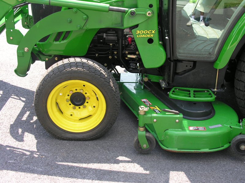

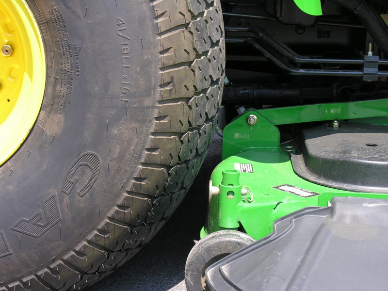

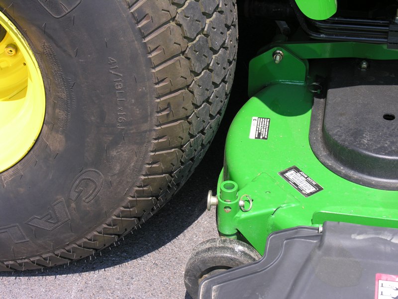

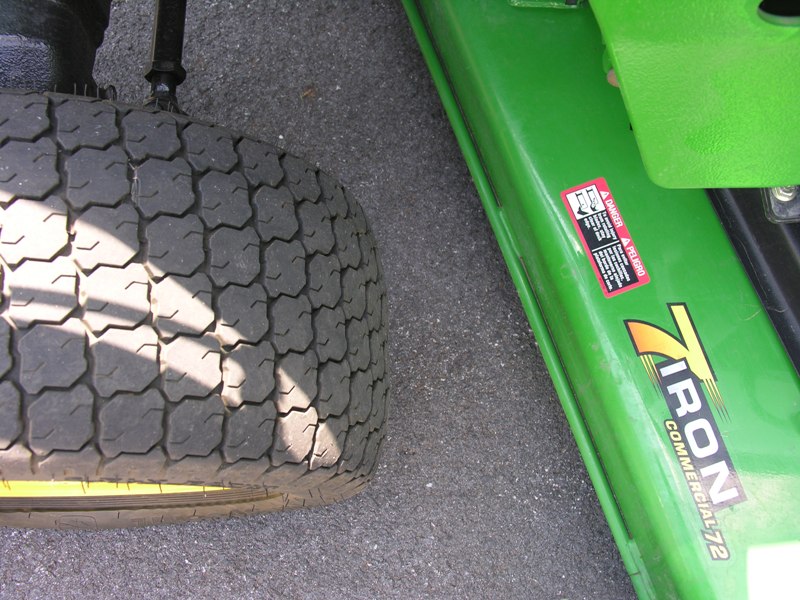

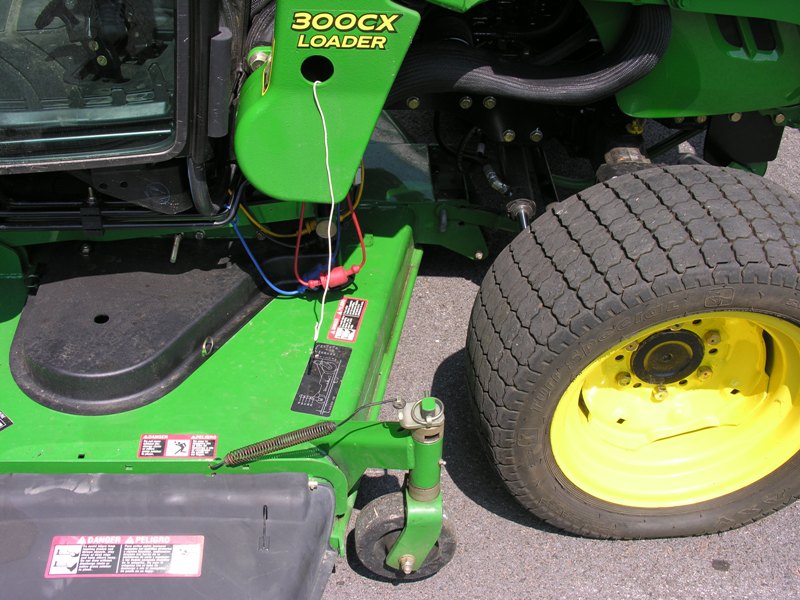

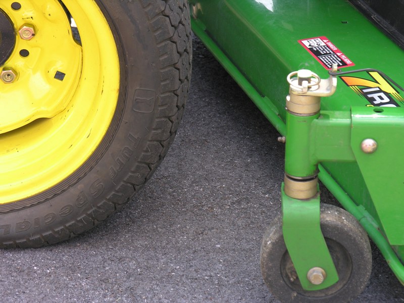

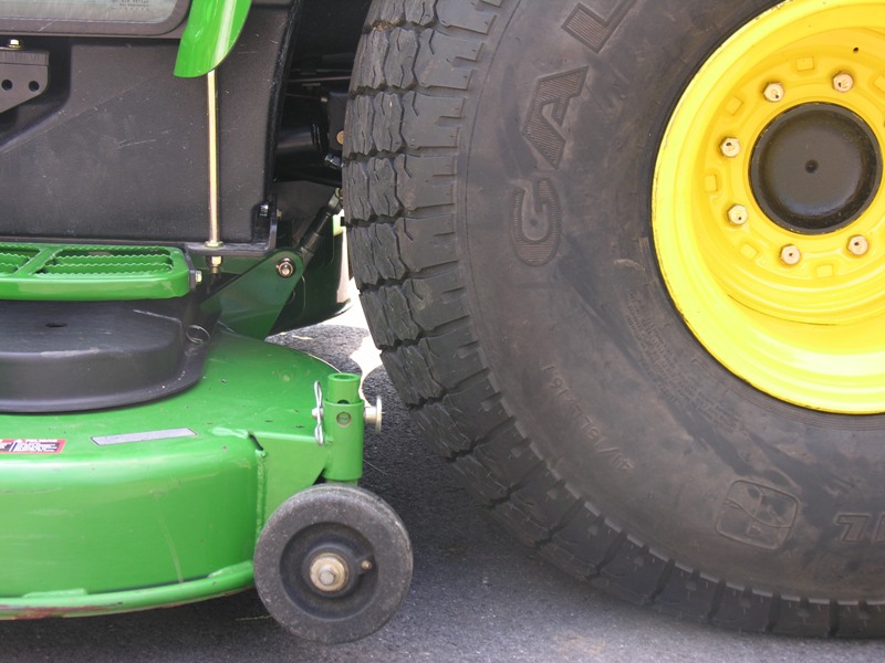

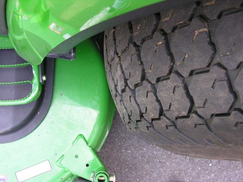

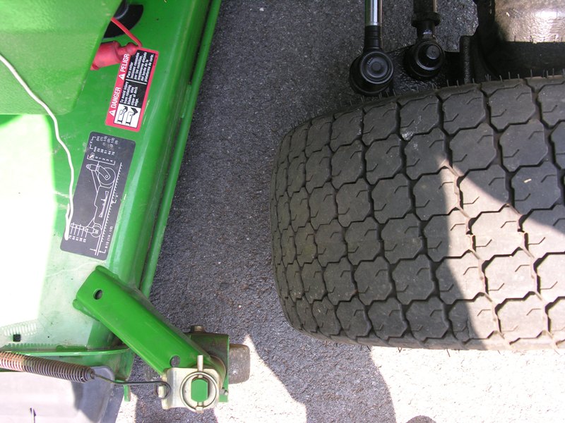

Well, I took the rears over to the local tire shop to get the wheels switched, the current wheels have 6 lug holes vs the 8 I need. So I get the rears back tomorrow. I was gonna try on the fronts today but did not get to it. It will be interesting to see how the rears fit, they are 41" in diameter and the current rear R4s are ~37" in diameter. So since the JD specs indicate that when you install the turf specials, the height of the cab is lower than with the small R-4s., So we shall see by earliy Saturday if the rears will fit and will not increase the height of the cab (which in turn would not allow the unit to enter the 90" opening in the Garage/Shed!:eek:), which would be a problem!:eek: seems the Turfs might have to set on the narrow setting which results only in a few inches more of stance than the R-4s. Those Turf Specials are so soft they most likely flatten out with the weight of the tractor and that is why they should produce less height than the much stiffer R-4s. Once I get the tires on, good or bad, I will upload pics.
/ Hub Spacers?
#44
Well all, they fite and they fit on the wide settings fron t and back. One rear tire is close but does not touch the deck!
Here are the first roujd of pics

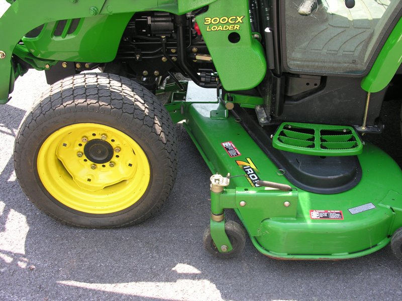

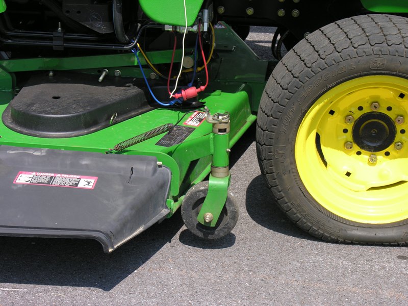

Round 2 pics
any comments?

/ Hub Spacers? #46
That's great. The fronts look to be smaller in diameter than my standard R3 Turfs. That must be what gives the clearance needed on a hard turn.
/ Hub Spacers?
#47
CinderS, Yes they are, they are 25" in diameter, versus 27". So they allow me to run them at the widest seeting. Again Thanks for the help you provided with those pics!
