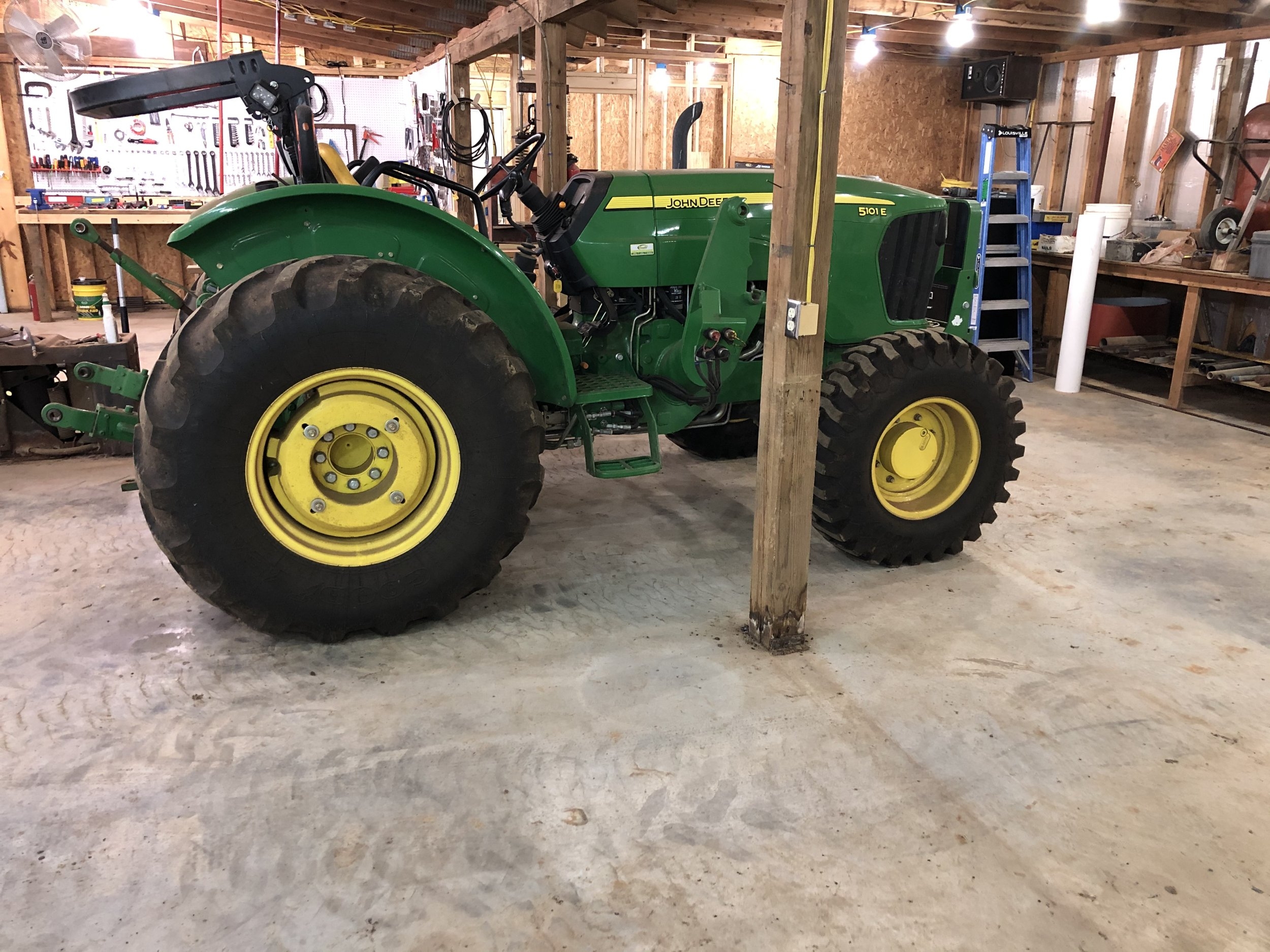

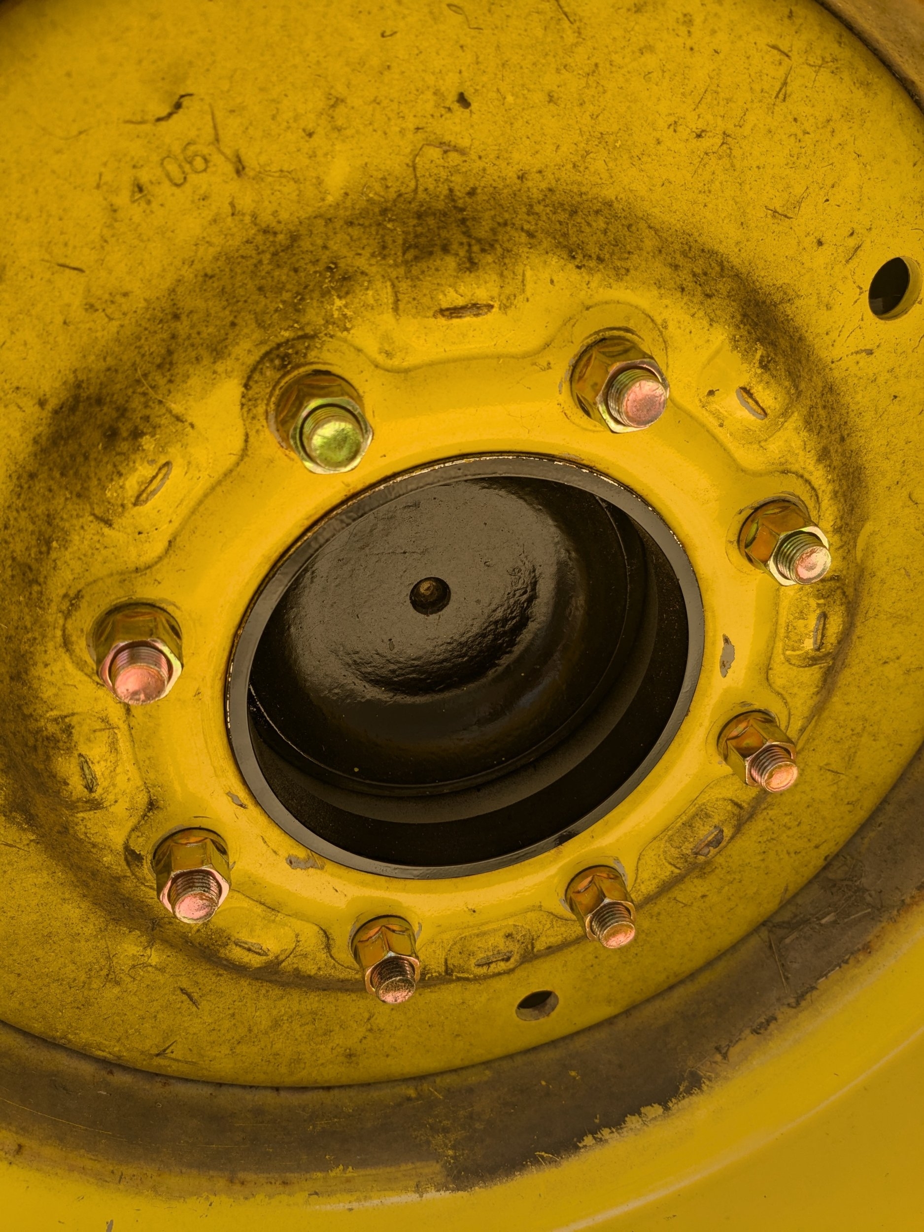

I had some rear 4” steel spacers made for my JD 5101E from Motosports tech in NV a few years ago.
/ 3Series wheel spacers #6
Mine were open centers.
Thru hole i guess you’d say
/ 3Series wheel spacers #7
You can zoom in on side shot thru the 350lb weights & see the open center.
Tires are 90% Fluid Filled too.
I couldn’t get the correct width with the wheel weights only fitting on the Domed out side of the wheel center so I had the spacers made.

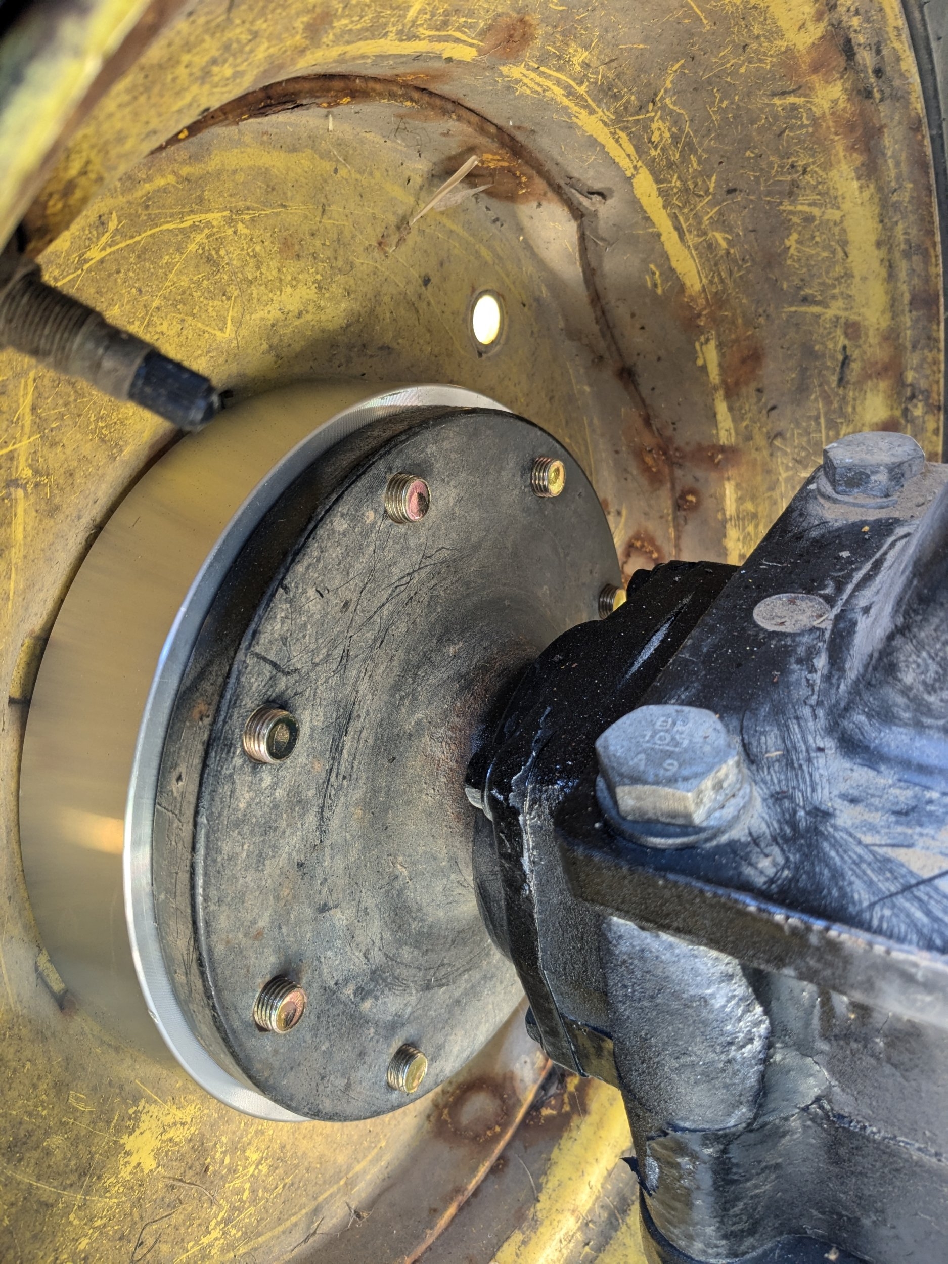

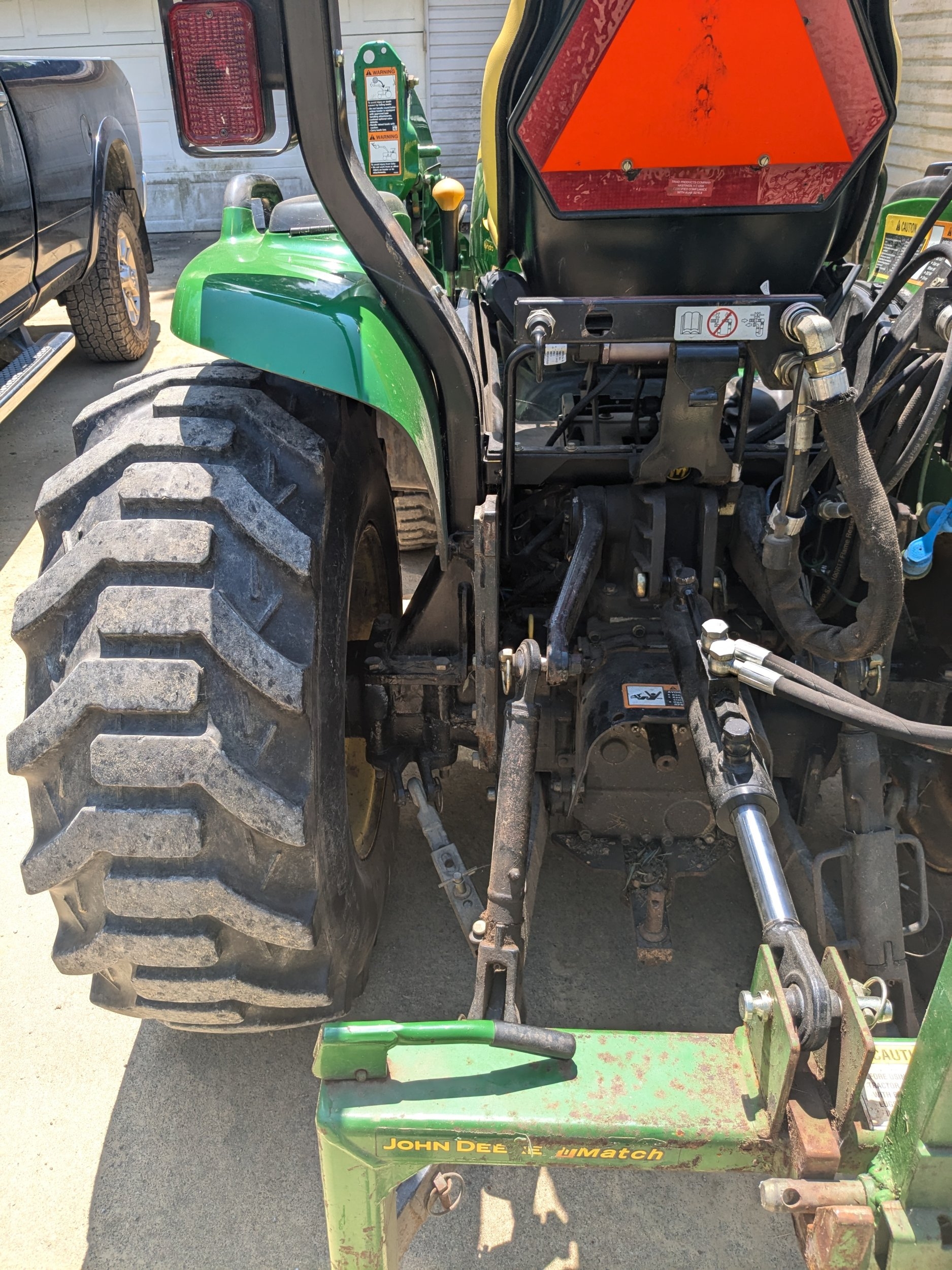

Nice machine. Guess I don't have to worry about weight capabilities of spacers. You having them on a tractor that size. Richard from Bro-Tek said their working on a cover or plug for the center. I was just worried about mud and water sitting in there. That was the reason I was looking for solid centers. My rims are dirty from having the wheel weights off. It does feel more stable even with just 2 inches wider on each side.
