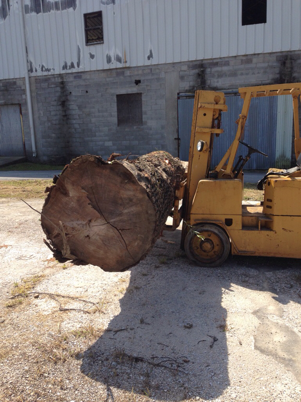

A true 36" diameter hardwood log thats green....figure about 350-400 pounds per foot of length.
Get over 5000# pretty quick. A 16' log of that would be 6000ish pounds.

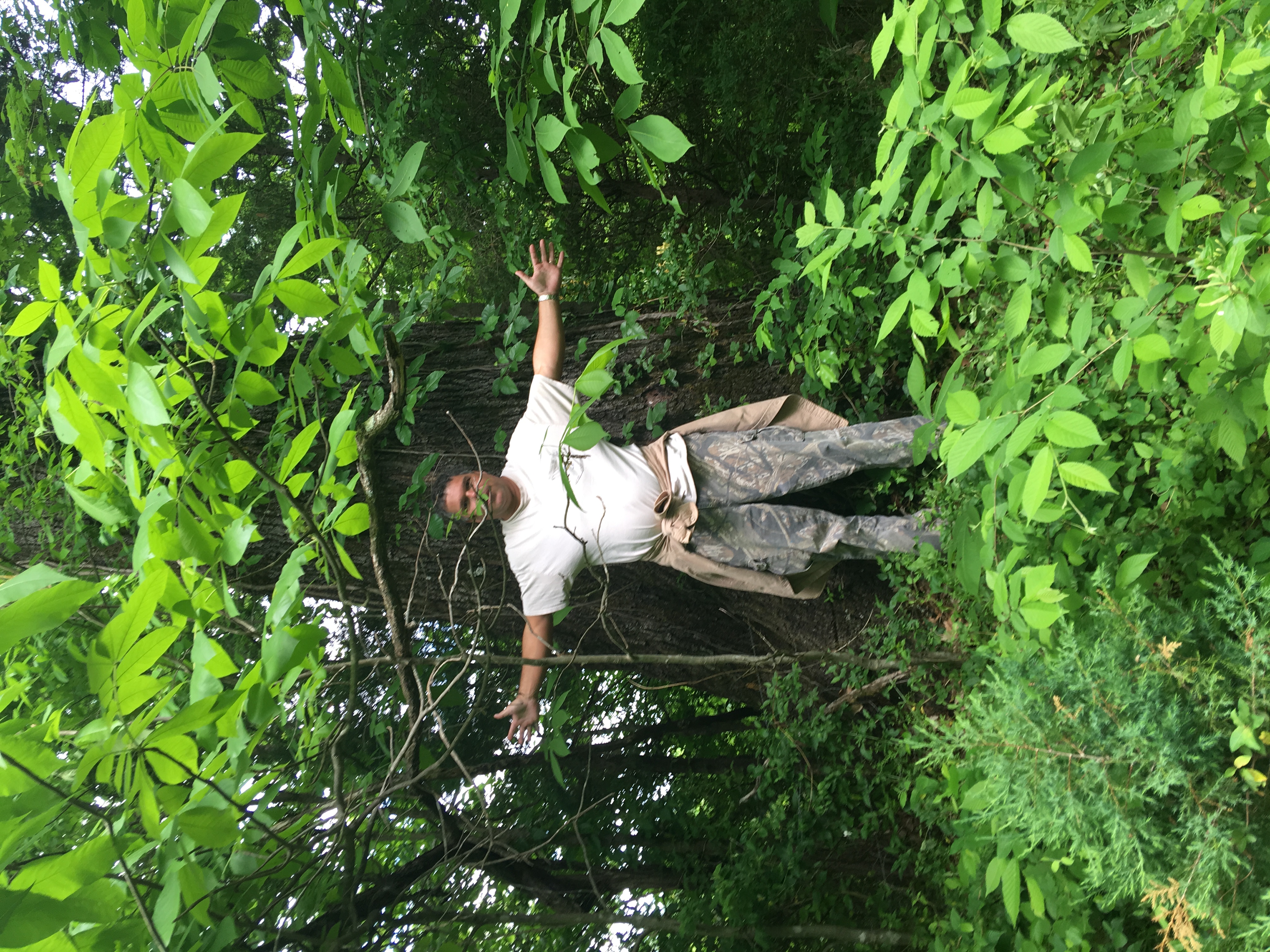

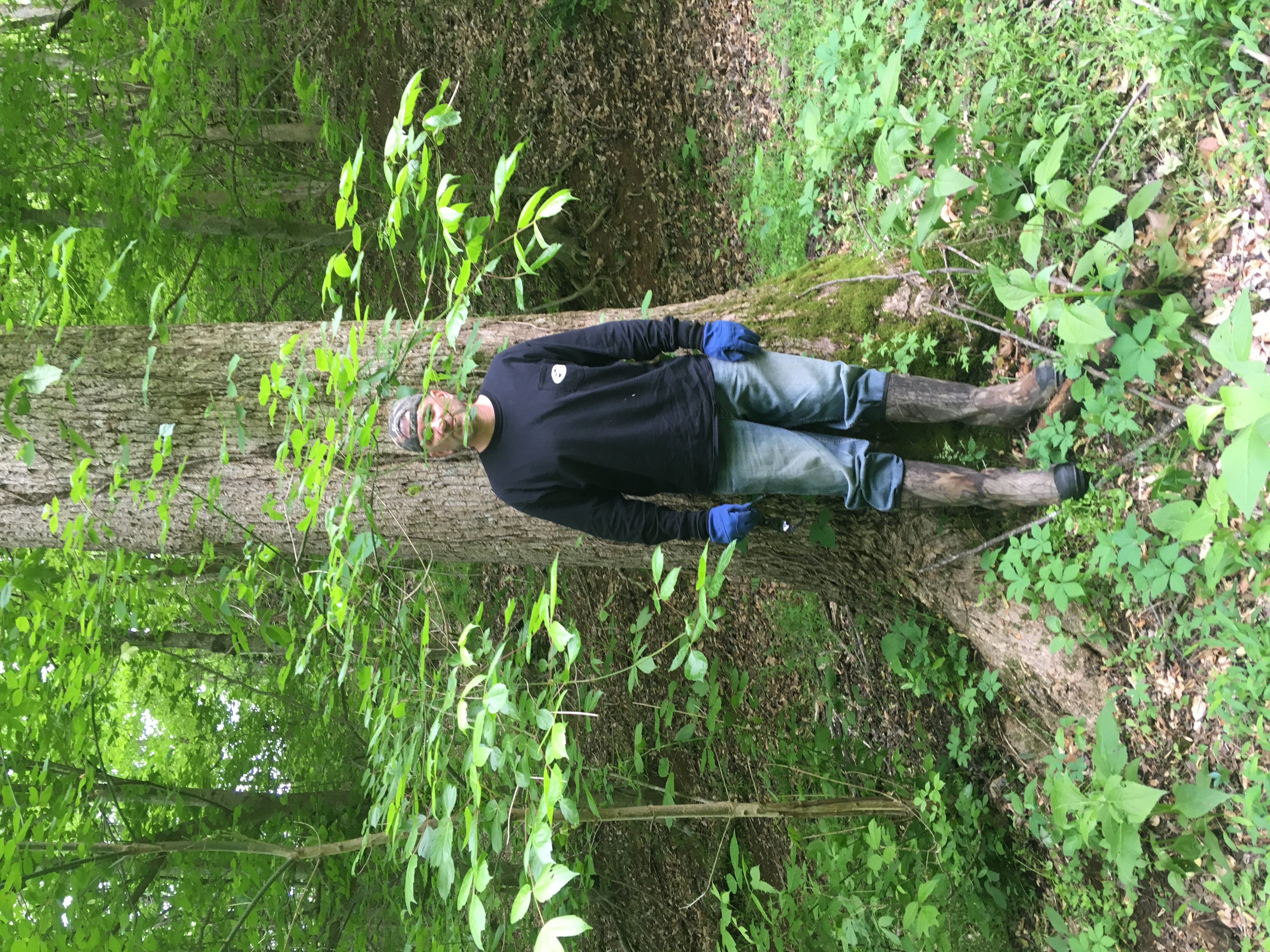

Drove down to TN and did a survey of the property and met our guy who is going to knock in our road. The first pic is broinlaw in front of the ave sized timber we will be handling. Second, with big belly, is me in front of the biggest one we found running the boarder fence....it made it this far and isn't going anywhere.
