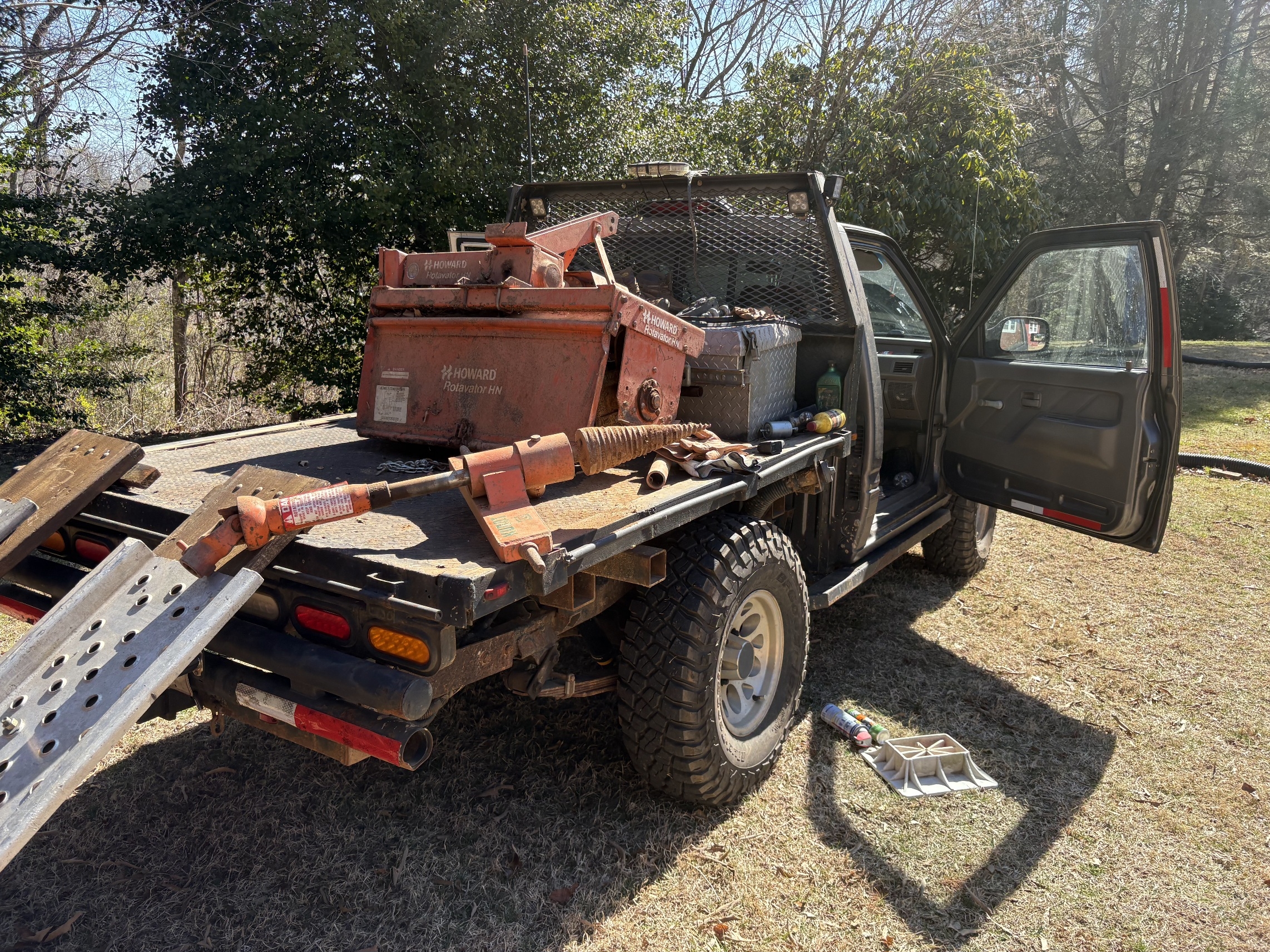

My buddy got this from a old farmer's son who was downsizing...farm stuff.
Since my buddy has one ,he is bringing it to me in a week or two.
Not sure if it works etc.
All I can find is 1979 advertising.
Also getting some kind of pto driven screw?firewood processor?
Any hits or ideas? Downloaded an owners manual.
If it works, should be good as a freebie

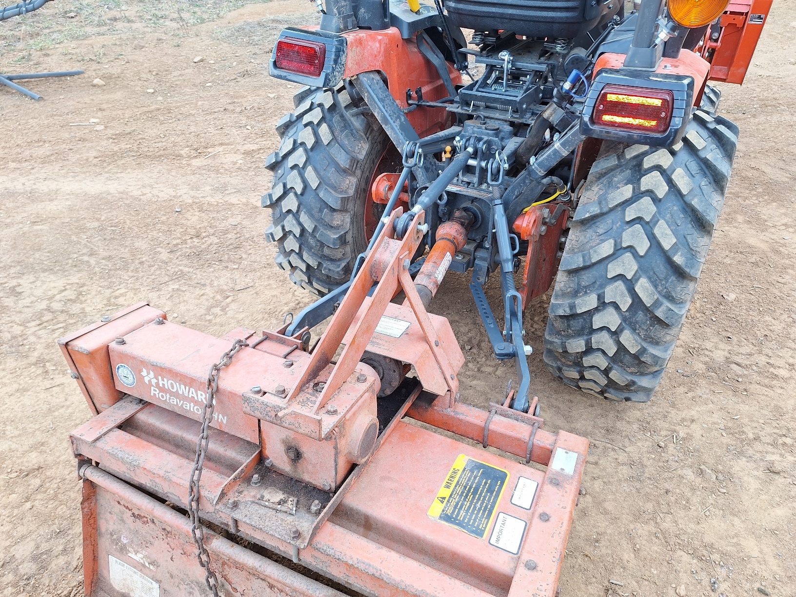

Got it home and hooked up to tractor, no noise or vibrations.
Will try this weekend
Free is bestest equipment :cool:

Free is best. That screw type fire wood splitter, I'm not 100% sure, but I think it might be missing some parts.

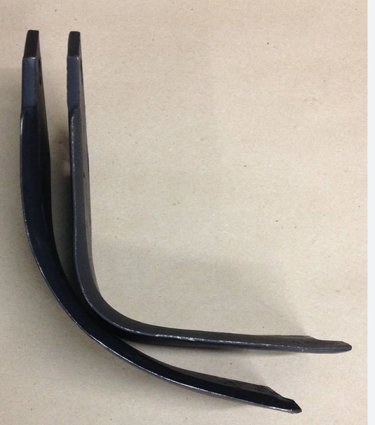

The Howard is not made anymore, but it uses "J-type" blades FYI if you are looking for replacements.

Most Howards were offered with the C type and L type blades. Howard was bought by Kongskilde.
The bottom tine is a C tine, and the top is an L tine. The C Tines use less horsepower, but create an uneven bottom. The L tines take more power but have a even bottom.
The HN is a 40" working width, and can go up to 7" deep. It requires a 15-18 hp tractor.
/ Howard Rotavator HN questions #7
J-blades were used on the HN tiller and the John Deere tiller (647?) produced by Howard. C and L blades were for the bigger tillers

I wouldn't get within 6 feet of that screw splitter - literally!

There should be a top link area, as well as a base of some sort at the screw end. Without something to hold the log, as soon as the screw makes contact, it's going to go spinning.
#11
The screw has an "arm" to hold the unit.
I have no plans for that thing other than selling it to a person across the pond...who will attach it to a Volvo or tractor or?

Just looking through an old Howard book. The Rotocadet, J and HN used J blades
