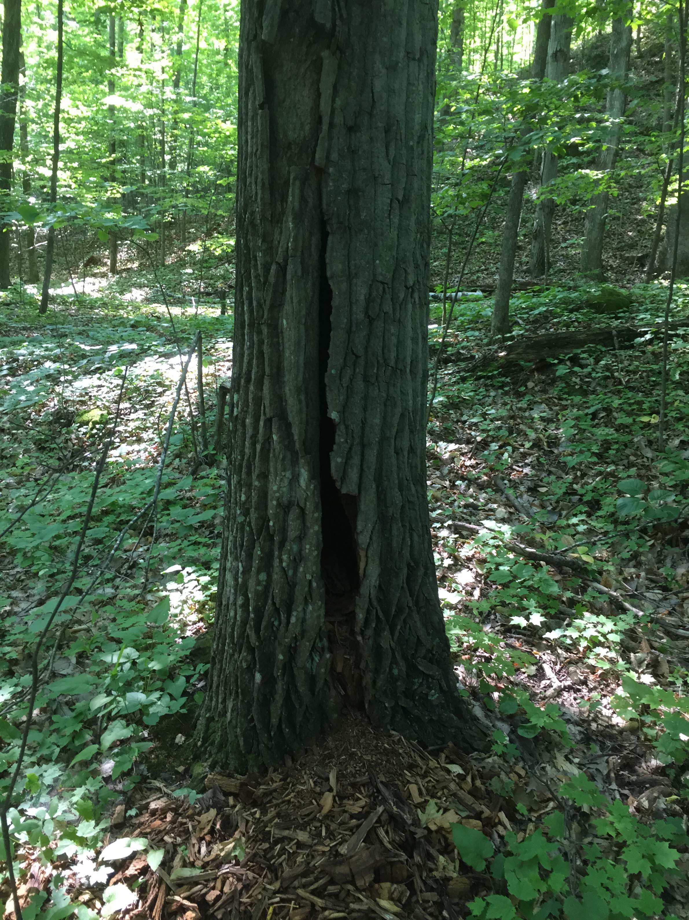

Walking around our property up north and noticed this Poplar tree. Because these trees like to top themselves I generally keep them cleared back from the buildings. This one somehow escaped me. If it fell in just the right direction there is a chance it could reach my garage so I'd like to take it down on my terms. The tree is viable and appears to be otherwise healthy. I've climbed and topped the Pop'ls in the past, but I've learned that the cankers they get are scabs over rotted spots. Because I don't know how solid they are, I no longer climb Poplars.
My concern is how the tree will react with so little material remaining at the base? I figure that only the sap wood is remaining so the walls are probably 2" thick. Tree is about 18" at 4' up and it's 80' high, dead straight. The area is remote so using a dozer or winch to pull it over isn't going to happen. I'm not as concerned with controlling the direction of the tree as I am with the extreme pressure those thin walls are under. With hollow trees, do they try to spin or splinter? Trying to gauge just how dangerous this tree is to fell.

Use a wood auger to check for soundness. Then make a plan.
/ How would you guys drop this tree? #6
You state that you have climbed in the past. Is that like climbing as most folks think; or is that like climbing like a logger/arborist/tree faller thinks?
If the later then you know what a barberchair is and the chance of that tree barberchairing is very high.
If the former type of climber, and you have no idea what a barberchair is, then google it watch and read some accounts.
That tree is potentially very dangerous to your life and limb.
If you have no experience with falling timber and especially hazard trees you might want to find someone to help you that has the experience to keep you safe and alive.
There are some techniques to lower the risk that should be employed on that tree and will still be problematic from the picture you post.

I'm the latter, but I'm not a pro by any means (nor do I pretend to be). My skill set lands somewhere in between. I've cut a couple of hundred trees down, but it's not my profession. I do know what a barberpole is, but I only associated the phenomenon with weak grained leaning trees (Box Elder is notorious for this). This one is dead nuts straight. I've cut hollow trees before, but never one this thin and tall. Maybe I'm over thinking it, but I believe that tree could react the moment it sees a saw. I just can't envision what it's going to do.

Are you throwing it away from the open place, to one side or away from the open place? If I was cutting it away from the crack and not to one side I would cut it and not worry too much. I would pull it over but not until after i had cut it. I would not want any pressure on the tree till I finished cutting.
My face cut would be away from the split and then I'd make a plunge cut towards the split. I'm pretty sure the face cut will penetrate the sides so I'll end up with two short hinges.
The last one I cut was also a dangerous tree and I didn't want to be under it's widow makers when it started to fall. That one I made a plunge cut but left a very small piece at the back edge. Then I pulled on the tree until it snapped and fell. Maybe I can apply that trick again.

It might help to clean that heavy bark off for a couple feet before starting so you have a better view of the wood, or not wood :D. It looks fairly loose.

Problem with a tree like that is that there isn't consistent enough holding wood for a predictable drop -- no way to get a reliable notch or hinge. I guess I'd spend a lot of time trying to determine if there's enough wood for a notch in a falling direction that would work, and go from there. If not, I'd probably put a rope on it as high as you can, take up the slack, and then bore it out carefully so that it goes over in the direction of the rope when tensioned. So instead of creating a notch and then back cut, you're pretty much just doing a back cut to relieve tension fibers. But this is all conjecture -- I'd really want to examine that tree on site to really recommend an approach.
Last time I did a tree that was a little worse than that, I pulled it over mainly with rope/tractor. I used very minimal sawing to nibble away at tension fibers at the back of the tree, gave a pull with tractor, then slackened the rope, nibbled a little more with the saw, then gave a pull, etc, until the tree went over. If I recall right, it took about three "iterations" of this procedure until the tractor could pull it over. I wouldn't have wanted to cut too much since it could have caused the tree to rotate or fall over in an unknown direction by itself. So I basically kept nibbling at the back fibers until just enough had been cut that the tractor could pull it over, but not so much that the tree rotated/fell by itself.
