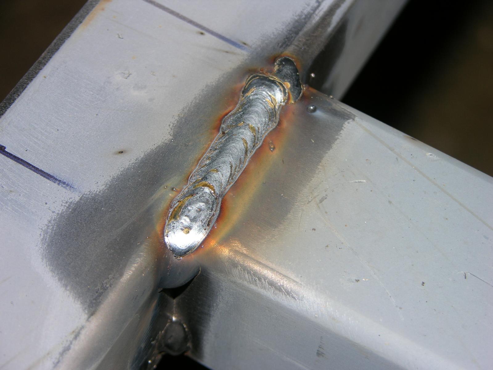

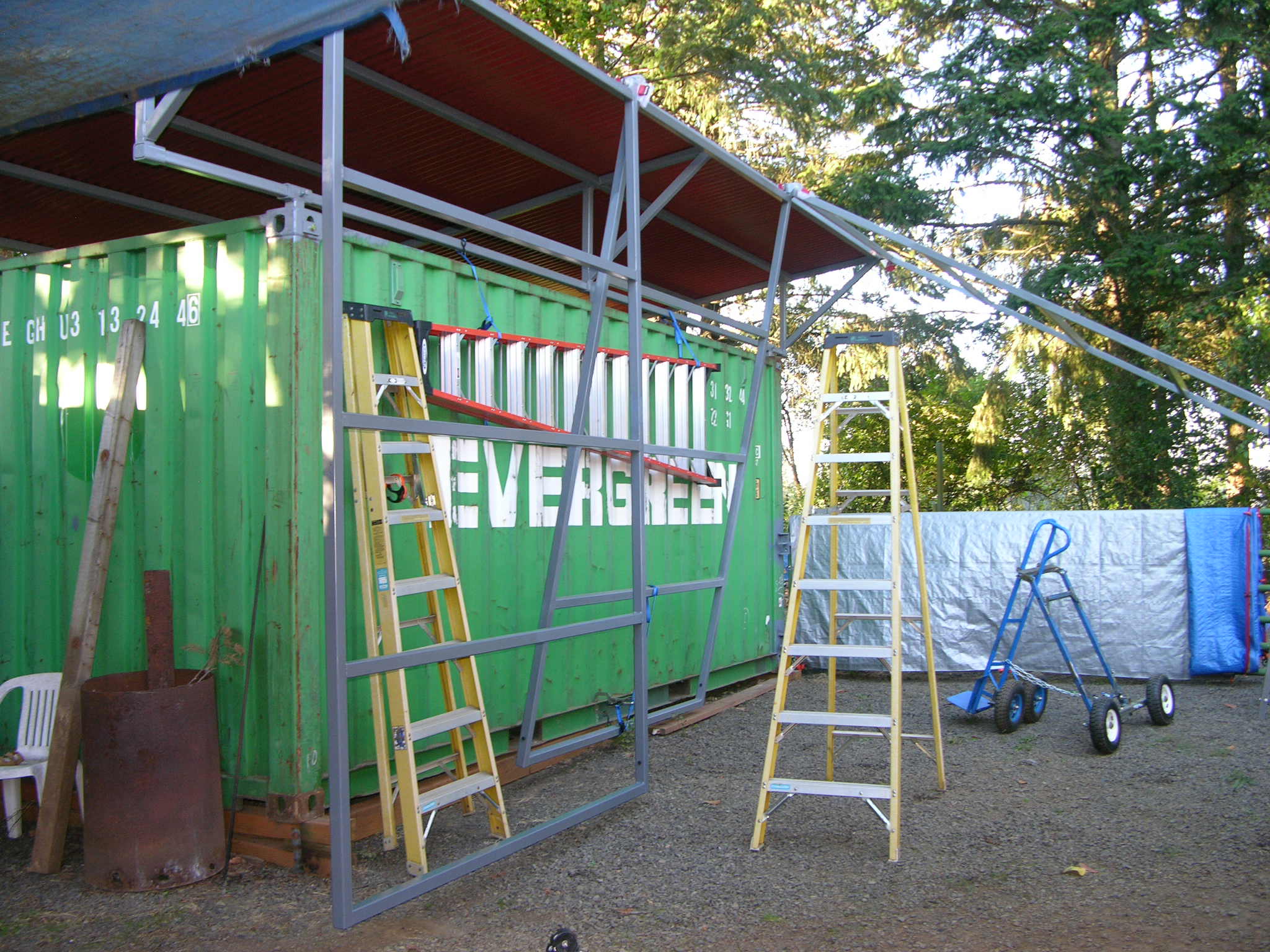

Guys, a couple of things - I've never used flux core, bought a MIG so I could get AWAY from a bunch of cleanup - I have seen others just take the nozzle OFF the gun for flux core, but the factory adapter keeps the threads, etc, from getting messed up.
Helmets - most of 'em let light in, but the auto darks are so much less of a PITA for changing shade it's usually worth the irritation. I keep meaning to take some thin leather and build both a "beard" and a hat to rivet onto at least one of mine, just haven't got to it yet.

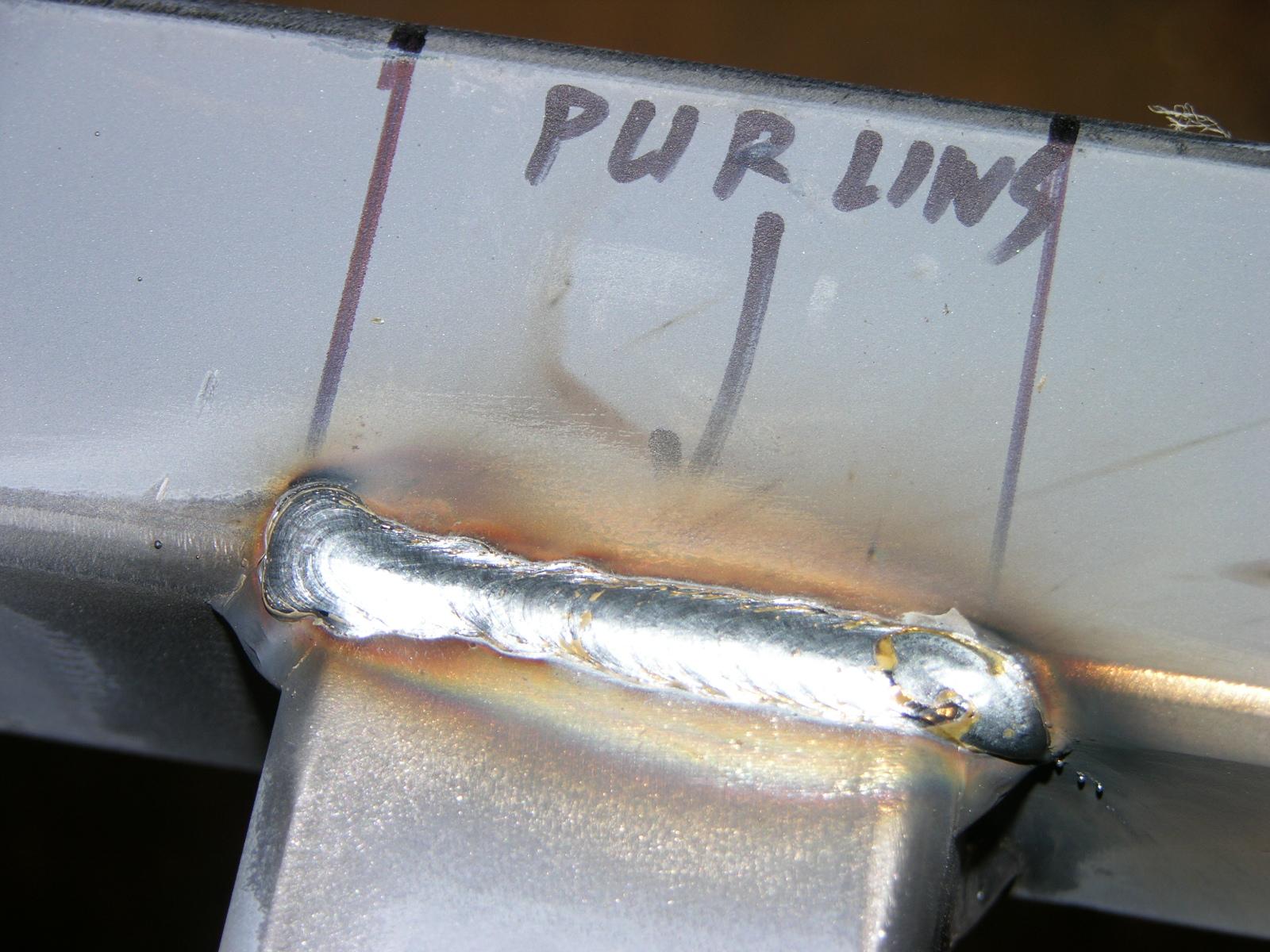

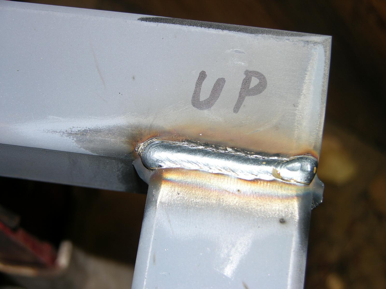

MIG is definitely a different animal than stick for visibility; the only angle I've found that works is to be alongside the weld path, not behind it - from there you can tell if your stickout is right, if your slight rearward tilt of the wire is right, etc - it DOES make it a bit harder to keep the bead STRAIGHT, but not impossible. If you want even MORE "fun", try a full size spool gun 10 feet in the air with a 6-7 mph wind - DSCN2241.JPG the plywood in the background was clamped to the .120 wall 2" tubing to block some wind; I also upped the gas to around 25 scfh instead of the usual 18-20. Can't really blame the vertical on wind, I just suck at vertical up... These others (all untouched after weld) were inside with normal mig gun, MM252/.035 Lincoln L56 wire/C25 gas - DSCN2359.JPG DSCN2361.JPG DSCN2362.JPG
This is the roof frame where they eventually ended up -
I'm now on my second and third MIG, bought the first one (now belongs to a friend) at least 10 years ago and since then I've used stick maybe TWICE - everything else gets done with the same combo mentioned above, from welding 14 ga. fence wire to emt conduit, up to 3/4" flat bar for 20 ton bending jigs. Best advice I ever got was from Jody at weldingtipsandtricks.com - specifically, to stay at the front of the puddle (in direction of travel), and NOT assume you're getting penetration unless you SEE the arc touch the parent metal.
HTH... Steve

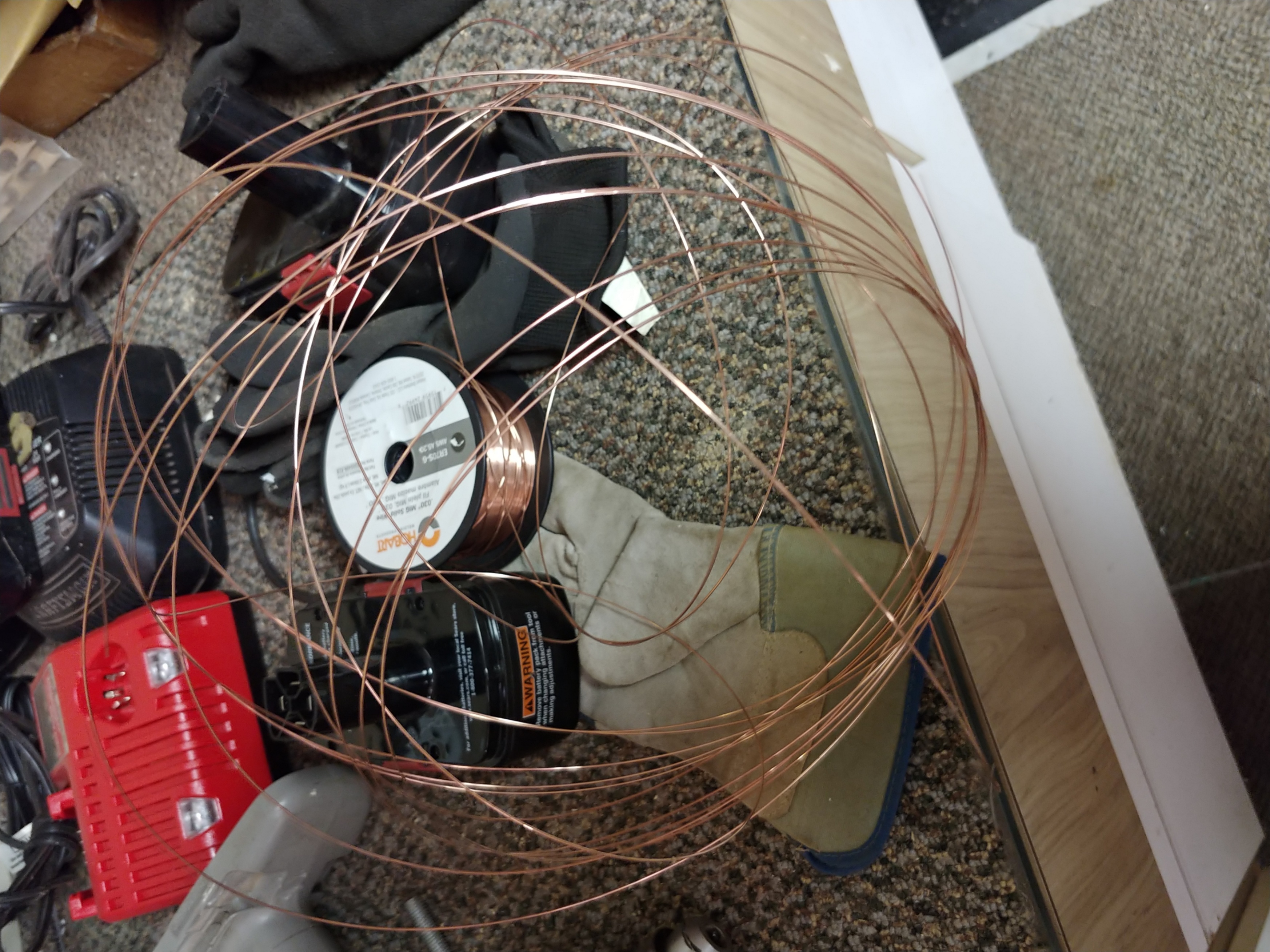

when transitioning to mig like me..............dont do this!!!:mur:
   / How to transition to MIG? #177
That happens whether you are transitioning or not. Happened today. Bigger spools have less cast and helix so they are a little more manageable.
   / How to transition to MIG? #178
im glad im not the only one, i almost said a bad word :eek:
   / How to transition to MIG? #179
You are not the only one, just cut it off and move on.
If it is an older spool then sometimes it is a good thing as the top layers build up corrosion which can cause bad things.
