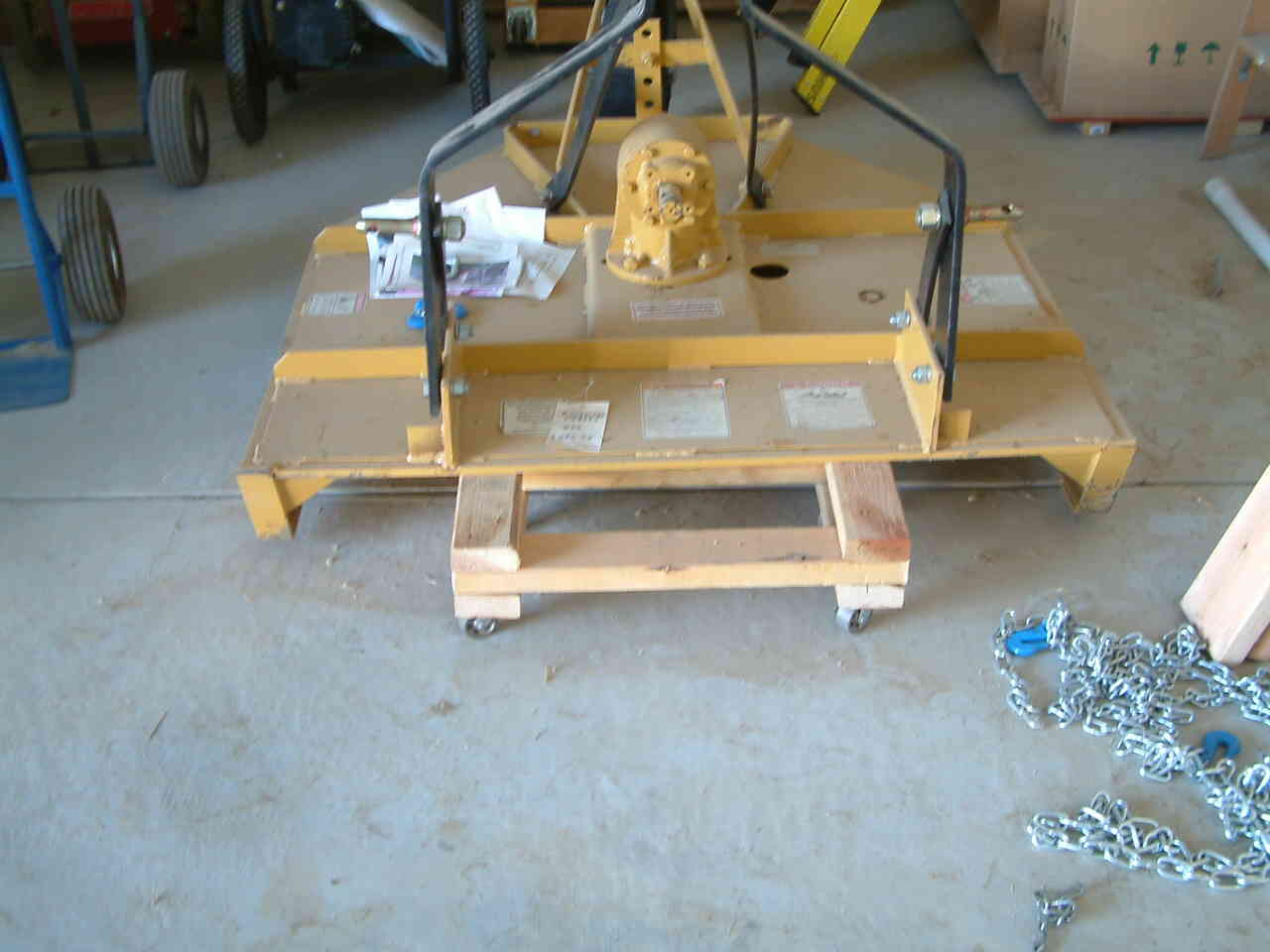

BTW: I made a pair of dollies for the brush hog to make attaching and detaching easier (see attachment).
