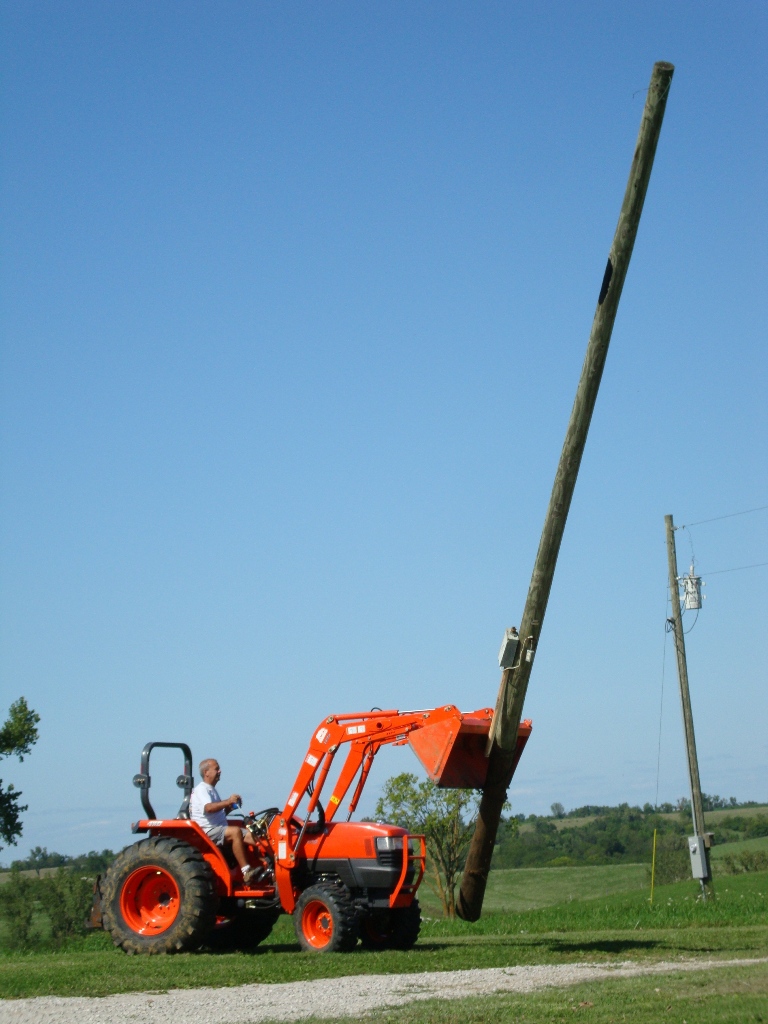

We've removed several using method in post #2. Dig out enough on one side for the tractor to push over with FEL. If it's solid it won't break. Always afraid a pole this long could upset a tractor if it's chained to it. If solid the weight will surprise you.

Thanks for your answer - ovrszd. Leaning into a tree - man, THAT'S using the 'ol noggin. That one picture certainly shows the hazards that you could encounter using a tractor. The tractor in the pic - doesn't seem to be one listed in your profile. What size Kubota is it??
That was my previous L4400. I think I could have laid the pole on the ground with the M9540. Lot more clearance under the front axle.

It never felt awkward or like it was too much for the tractor. I had to "wiggle" it with the 3pt to get it started upward. My M9540 would handle one easily.

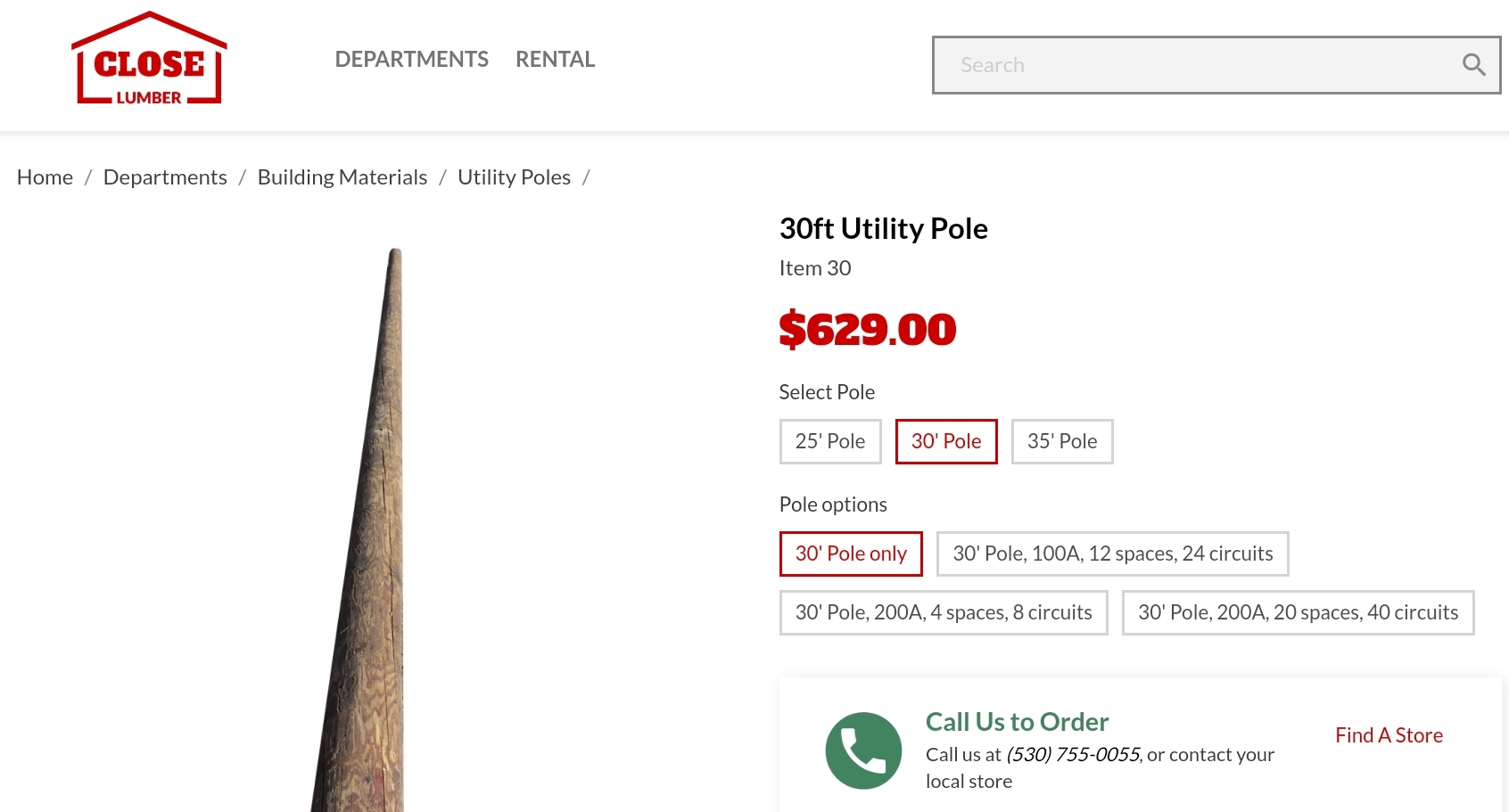

How much is a new pole? If I'm going to all the trouble to set a pole and then attach stuff to it, I don't want to have to redo it in a couple of years do to it rotting off. A lot of times they pull good and do exactly what you want them to do, i.e. lay down with out flipping, but often times a loader on a tractor can not get high enough to control it after it's pulled or it flips unexpectedly.
