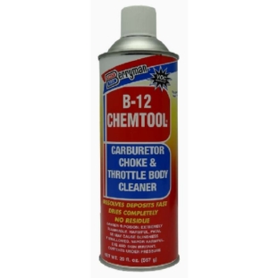

/ How to remove carbon from piston #13
Berrymans Chemtool B12.. soak a day or two. Cleans the combustion chambers too..
