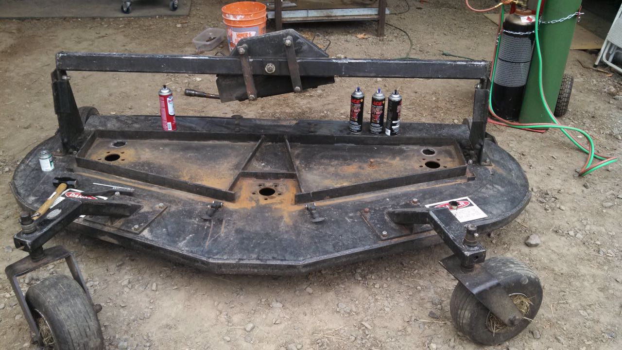

So setup. I am at the point where I just lift the mower up, do my work off the arm and put it down. If I run into trouble I will flip the mower over which is kind a magilla but having the mower upside down makes it so much easier.
Let me work backwards from where I am at now to the start.

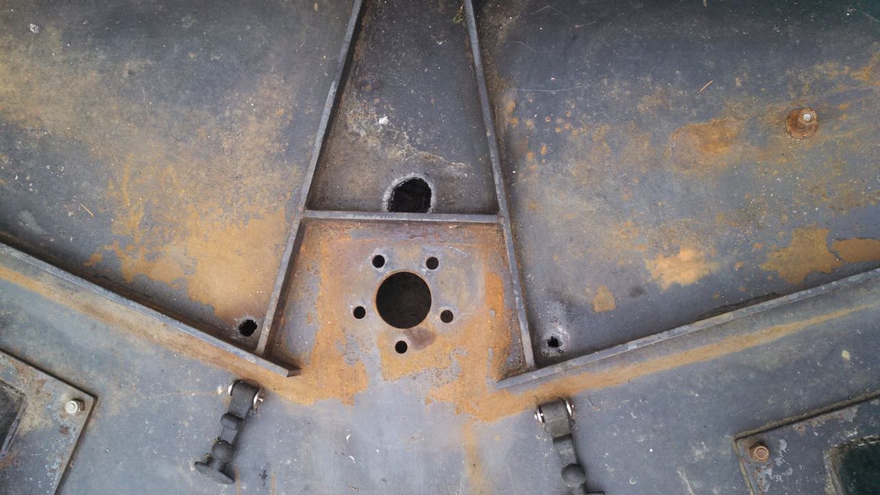

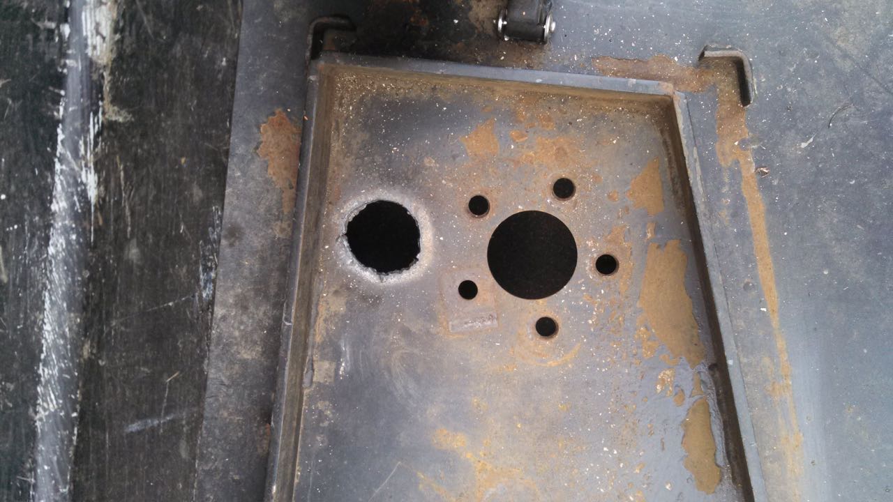

I have gone ahead and cut 3 holes around 3" in size over top of the mower deck where the spindles are. Measure carefully, and consider things that will be in your way. This does allow more water into the mower deck if you let your mower sit out like I do. It also allows debris in.
I then purchase longer 5/8 Bolts to hold my blades on, so they poke through the nut further. I use Grade 5, they have a bit of a shoulder on them so be careful if you go this route. I then made a custom tool, I got a long 5/8 bolt and welded on a nut part way threaded onto the bolt. This is my "Driver". So I break a bolt. Instead of trying to extract it, I thread this bolt onto the broken bolt trought the hole in the mower deck and use my impact driver to drive it down. It won't go very far but at least with a 1/4" hanging out, I can get Vice Grips on the bolt and work it free. now I have had the misfortune of once not getting the driver tool properly threaded onto the broke bolt. I was going to fast trying to get back to mowing. I hit it with the impact wrench, went to the other side with the vice grips and now it is stuck. Stuck in both directions cause the other side was bunged up by my driver, and now the blade side was bunged up by my vise grips. This caused a complete tear down.

Then, last July, I'd had it with dropping the spindle, so I also cut a hole in the deck....
MossRoad said:
After a couple more broken bolts, I, too, gave up and drilled a 1.5" hole through the top of the deck right in front of the hydraulic motor, in-line directly above the arc of the circle that the blade mounting bolts make, and use forceps to place a nut onto the back of the broken bolt and drive it out with the impact wrench.
So I use my forceps and set just one nut onto the back-side of the broken bolt through the hole in the deck. I get it threaded on all the way, then use a deep well socket on my impact wrench and TIGHTEN the nut down, which ends up driving the threaded broken bolt UP and out. Worked good! :thumbsup:

Here are some pix of the holes. Realiing my computer is a mess and I now take too many pictures with my phone that never get categorized.

Thanks! That looks the same as my hub. I only have one. You have three. How long are your blades? Mine cover 48" including the hub.
