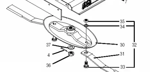

The used brush hog I acquired last year has badly worn blades. I was able to remove the 600 ft-lb blade nuts but I could not get the bolts out of the carrier.
Bolt #33 is stuck in part #30. It's a shouldered bolt with a 1 1/8 threaded portion and about 1 3/8 shoulder that fits in the carrier and holds the blade. I doused it in penetrating fluid and beat on it with a pipe and an engineers hammer and an air hammer but it did not budge. Any ideas how to get it loose? If I do hit it with something heavier I will support part #30 from below so the bearings are not taking the force. I can get at it from below, or from above through about a 3"hole in the deck.

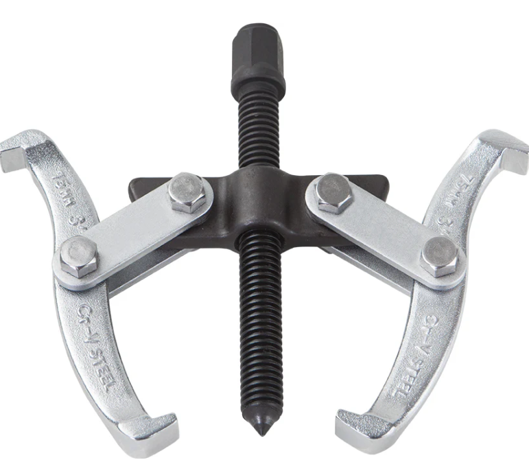

There's no room for a normal gear puller unless I remove the blade carrier entirely. Then I could get at it from above without going through the 3" hole in the deck.

A bearing puller may help. I 've been know to get these as tight as I dare and whack em with a hammer.

It doesn't show on the diagram but bolt #33 doesn't have any flats. It's a thin round head. Also it's got a key that keeps it from turning.
Thanks, that eliminates my suggestion. :cry:
So the big shoulder is in the blade. The spline part of the bolt looks like it presses in the stump jumper. Now how do you get a pressed in bolt out after years of rusting and all kinds of Temputure changes. I think it needs burning out with a cutting torch. If it’s possible to get to it. Only an opinion guys. Good luck
