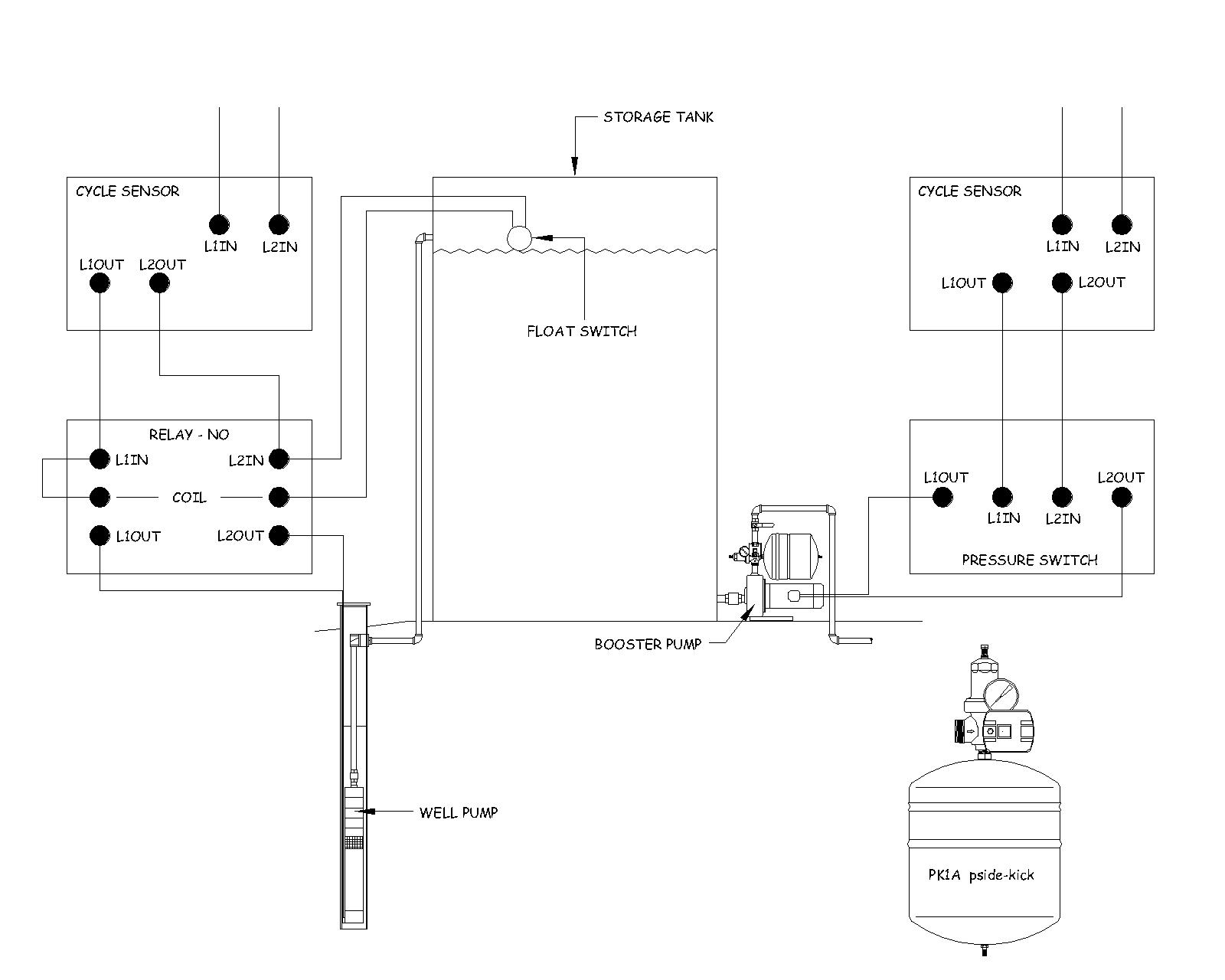

Valveman, you are not wrong, but the context of the post by bhshb26 above is to use several 200–500-gallon tanks (non-pressurized) as reservoirs to draw from.
Yes this is a two pump system but the main well pump runs to fill say 200-300 gallons, then another pump on the tank supports the house demand. This can be a solution for low volume/output wells etc.
Sorry I missed that. It is unusual to have that many storage tanks ganged together, but I can see where it might be much less expensive than one huge tank. No matter if it is one big tank or a gang of small tanks there needs to be enough water in the storage tank(s) as needed. It is not like a well with an unlimited supply of water. When pumping from storage tanks or a well a pressure tanks only purpose is to limit the on/off cycles of the pump. The water comes from the well and/or storage tanks, not the pressure tank. So, the pressure tank can be very small if you have some other way to limit the cycling like a Cycle Stop Valve. Even with multiple pumps of varying sizes the pumps will either cycle off and on no matter how large the pressure tank, or can be made to deliver constant pressure without cycling the same way.
