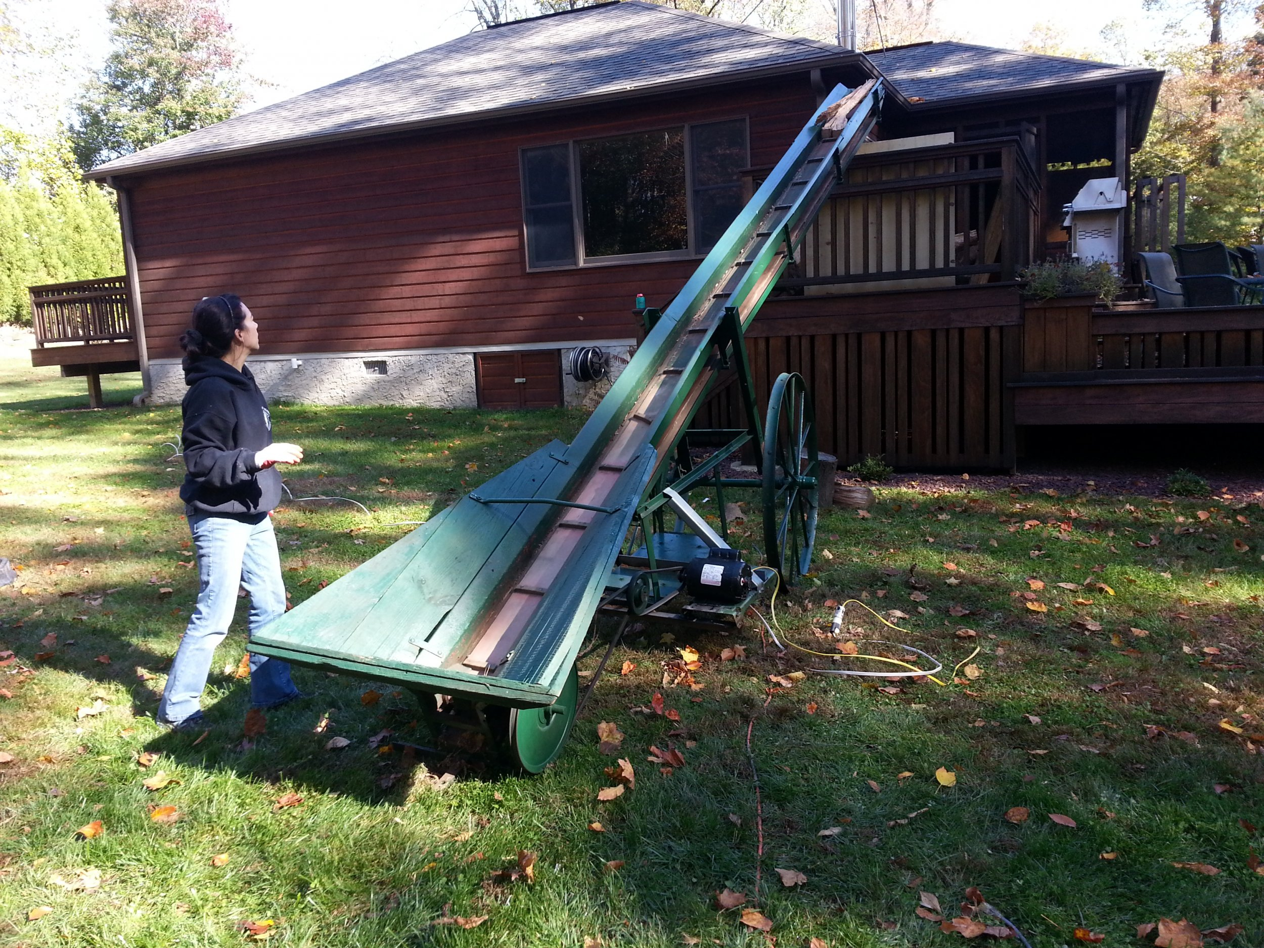

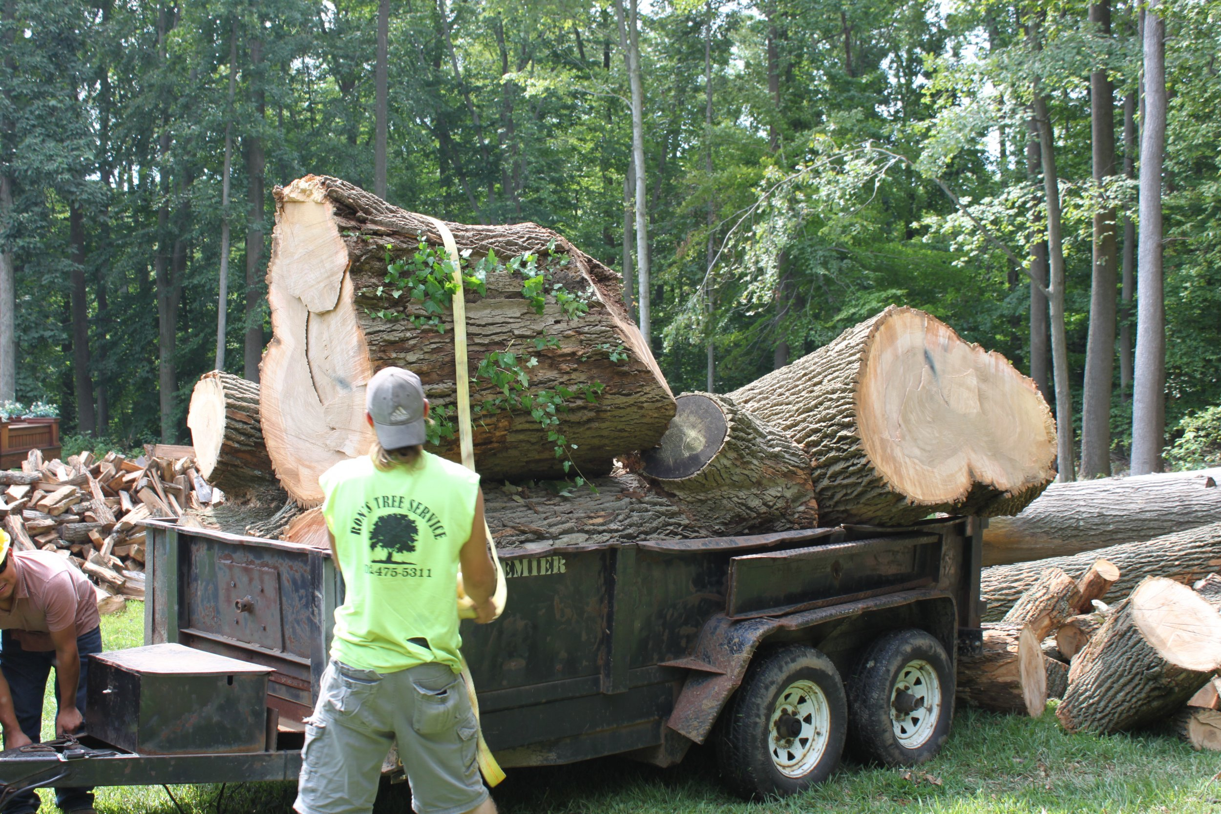

Different parts of the country same thing. But I still burn only wood. Cutting wood early this morning. I burn 15 cords a year. Me and my wife are the workforce. 12 cords done only 3 more to go!
OMG I used to do 8 cord a year mostly by myself. 15 cord is a whole lot of wear and tear on ones back. I'm 63 and now just buy wood cause my back is shot. Bought an antique conveyor to get it up on the deck.
