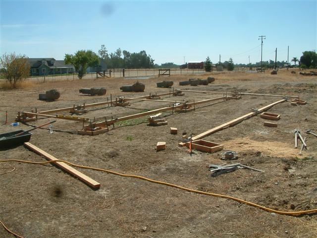

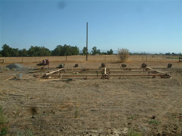

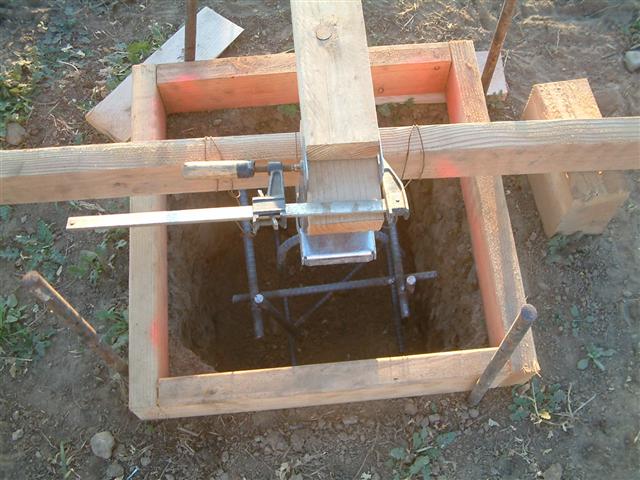

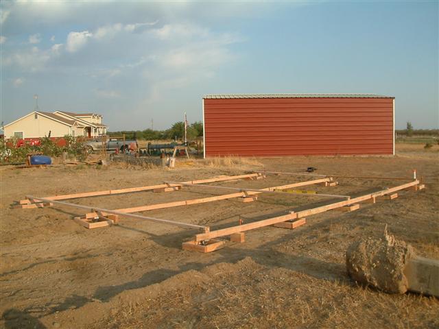

Hey, Dave.
Here's the way I used to set the Simpson post bases (4"x6") and concrete footings (18"x18" x 22" deep) for the 20x28 ft equipment shed I built a few years ago. Got it level using a bunch of 10 ft 2x4s and a 4-foot spirit level
DSCF0122 (Small).JPGDSCF0146 (Small).JPGDSCF0148 (Small).JPGDSCF0165 (Small).JPG
