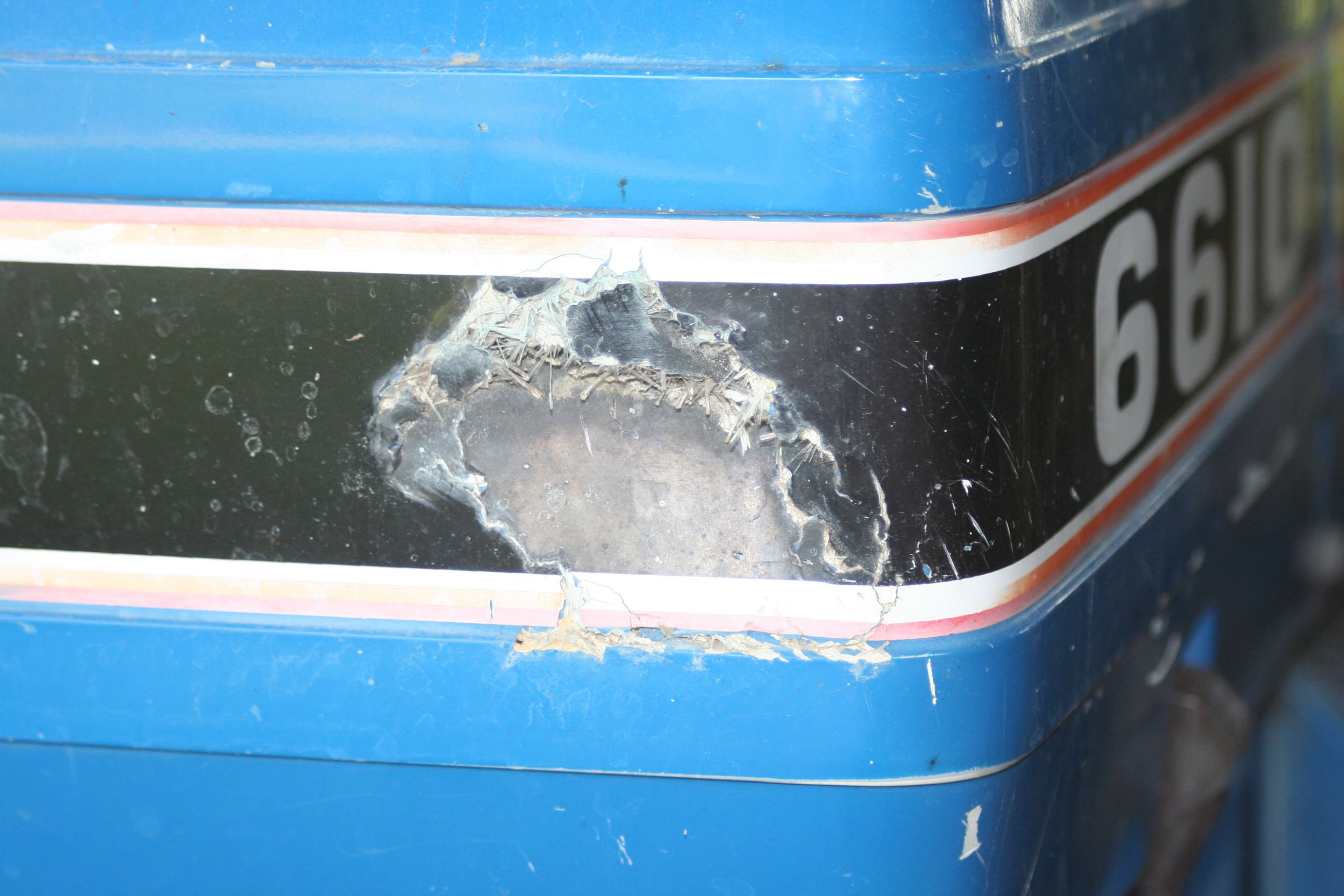

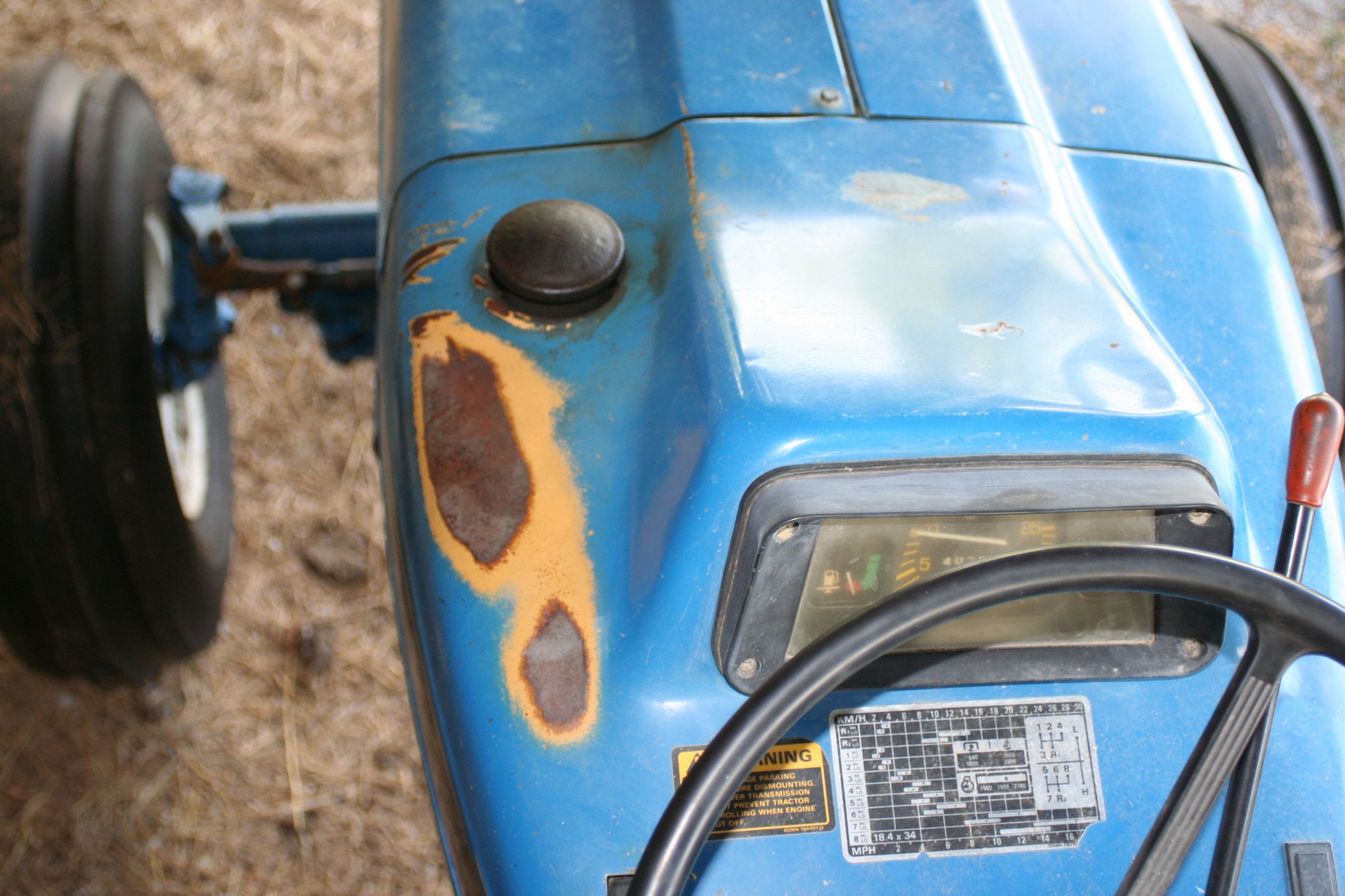

I took a break from working on fixing the doors and ran out to take some better pictures of my tractor. Here's a couple shots showing the whole thing with the completed carry all on the back, and some shots of the areas that I'd really like to do something about, the FG dent, the creased hood, and the places that are rubbed through the paint, primer, and down to the bare metal. It seems that I should do something at least to those spots to keep it from rusting out. Although I do keep it in the barn now, so it's not in the elements all the time.
I can see my wife asking the same question about actually using this thing if I had it back in near perfect shape. For a working tractor there is something liberating about having some "character" because you don't freak everytime something happens to it. The other thing that just kind of dawned on me, I'm getting a FEL mounted next week. You won't hardly be able to see the tractor once that thing is on it! :rolleyes:

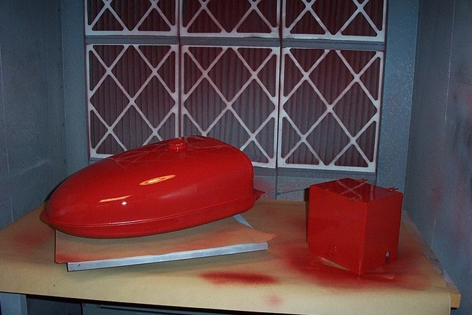

Mornin Tim,
If you could get that big Ford to fit inside a spray booth you wouldnt have to worry about any of those nasty fumes ! ;) :)
