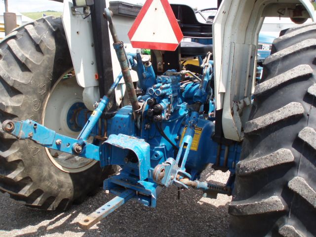

Not sure if this is the right place for this thread, but it's as close as I could find. I just bought my first tractor, Ford 6610. I bought it on the internet, so I don't really have any local contacts tractor-wise. It's generally in pretty good condition for a 1991 with 4,000 hrs, but there are some spots that I'd love to have touched up, or just have the whole thing painted. Problem is, NO ONE seems to paint tractors around here any more.
First: Aany locals (central KY) have a clue who might be willing to do this for me?
Second: If not, anyone have any advice if I decide to do it myself? I don't know much about painting, or have the equipment. I've heard one "tip" so far, cut the paint with gasoline when you spray because it will leave a really good shiny finish, but keep a flame burning on the ground and fan going to control and disipate fumes.
Or, should I just accept the tractor as is with some character because it's going to look like that again in a few years even if I do paint it. :)
Here's the photo's from the internet ad, I haven't taken any of it yet.

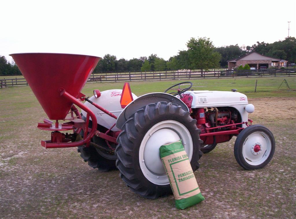

I paint my tractors... costs a fraction of the price to pay someone to do it.
Here's a tip.. -Forget- the tip about thinning with gasolene..
I like to remove all sheet metal that is feasable to remove. Sometimes you just get stuff that's easier to leave on the tractor.
I then sand with a variety of papers.. usually starting with a 350 or 400 and finishing down to 800 or perhaps 1000 if I'm feeling real energetic and the tractor might make it to a show.
Previous to this I wash and degrease the tractor. I wire wheel the cast to remove loose paint.
If possible I put the tractor on cribbing and remove wheels and tires.
Shoot primer on the tractor.. follow cure and re-coat instructions onthe primer / paint. Get a paint system and stick to that manufacture's products.. don't mix. get the primer that is recomended for that paint.. and use their thinners and addatives.. etc.
After priming.. you may want to finish sand.. if so.. do it with 1000, if needed.
Then shoot your finish coat.
Any small parts you have can be hung from a pole and wire and painted hanging all at the same time.
If you buy multi gallons to do this.. intermix part of each gallon to ensure same color.
I paint outside inthe open air, so i can use a little hardner. Hardner can be harmfull to you if you are alergic to it.. or if you are in an area where you are breathing fumes.. like painting indoors without a fresh air hood. The hardner gives the paint a great look and modifies cure time. ( i use the cheaper farm grade alkyd enamils.. like TSC's BPS paints.. along with their primer.. and valspar hardner, and i use naptha as a spray thinner, or mineral spirits as a brush / roller thinner.
Finish product for painting is 80% prep work, and only 10% chemicals.
IE.. you can use 500$ car paint and do a bad sanding job and it will look bad.
OR you can do a perfect sand and prep and paint it with spray cans and take it to a tractor show... etc.
Same with tools. I use a 9$ cheap chinese paint gun.. and a disposable 4$ filter. I used to use a chinese 2hp/4gallon 89$ pancake compressor and an extra 15 gallon walmart air tank to get some more air capacity.. plus a chinese 25$ air regulator.
I finally upgraded to a better 27gallon 5 hp air compressor with built in regulator...
Get an old car hood and test your paint skills on it. I keep an old flat piece of metal and test my mix prior to spraying my tractor.
Don't paint when too hot or too cold.. or when humid or when expecting rain in the next 24 hrs.
I'll post a few pics of some of my tractors i've painted.. again.. all with 24$/gallon paint and hardner, and 8$/pint hardner.. and cheap gun and small compressor.. and lotsa sanding and wire wheeling.

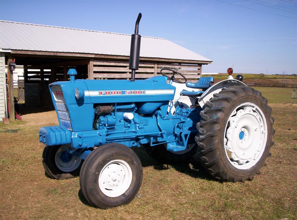

By the way.. that's a real nice 6610II you have there... I wouldn't paint it.. it don't need it yet..

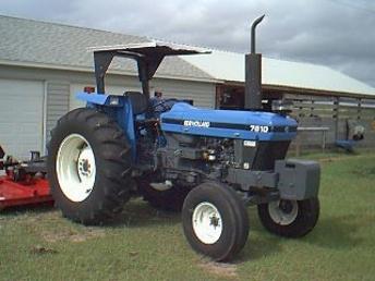

I added a pic of my 7610s.. a close realitive of your 6610II They are real workhorses.. you should love yours..

Unless you plan on restoring that tractor for show, leave it alone. It looks good!
Get some touch-up paint and cover the bad spots.
That tractor looks like a workhorse not a poodle.

Next - if you repaint that beautiful tractor you must be either nuts or very very particular about how your tractors look. It looks good to me.

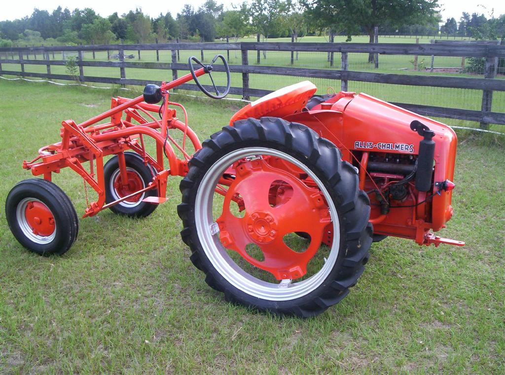

Thanks for the replies so far. First of all, perhaps I was a bit too subtle with my sarcasm on the "tip" to use gasoline and an open flame. I wasn't making that up, someone actually told me that. However, I am a chemical engineer and am smart enough not to get myself blown up. :D That's why I used the quotation marks around the word "tip."
Second, this is my first tractor. I'm just getting in to farming. Yes, I am rather meticulous about my stuff and would like for it to look as good as possible, but I'm not psycho about it. That's why I was open to you all telling me that I'm nuts for wanting to paint this thing. As much as I would love to do this job myself for the cost of it and the joy of doing it myself, I can already tell that this isn't something that I want to mess with. An example of my nature, I bought a carry all frame, bale spear, and boom pole from TSC. They came in that standard construction yellow color and that just killed me, so I bought the TSC Ford Blue paint and painted each of them. They are blue now, but I can't say that they look all that great. They don't look horrible for what they are, but I'm glad I didn't try that on my tractor. Here's pics of the carry all fram and bale spear. Even though I'm meticulous about how my stuff looks, that doesn't mean I have the skill or patience to do it myself and be satisfied with how it turns out. :)
For the time it would take, the health risks, and the potential that I would mess it up, I think I will try to find someone to paint the thing. So, thanks again for the advice and I'll steer the thread towards the "know anyone who would do this for me?" direction. I'll follow up with the Shelby Supply place.

Your Ford looks like it's been well cared for, so I don't think it needs painting yet. What you've done on the Carryall and bale spear looks pretty good to me paint wise.

The tractor is in decent shape, there's a place where the fiberglass front hood is busted, and a crease in the top cover over the engine, and normal wear spots in the tractor like where you put your hand behind the gas cap to get off the tractor. I just like to take care of my stuff, I certainly worked hard enough to be able to afford it, so I want it to reflect my "work ethic" and taking care of my stuff. Thanks!

That 2nd coat of paint you put on will help delay the rust of those 2 implements.
The finish didn't turn out perfect due to the metal surface and old paint imperfections. Same would be true on the tractor.. Like I said.. most of the 'finish' look comes not fromt he paint.. but from the labor involved during surface prep.
As i said at the bottom of my 1st post.. your 6610II work clothes are fine.. My 7610s has very similar ( oem ) paint..
