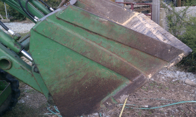

sdkubota said:
Explain the overall bucket width in feet and inches. Then describe with as much detail a cross section of the end of the bucket like depth, height, and if the top also has a small width or it comes to a point in inches. You do that and I will tell you what it holds.
Better yet, draw a diagram of the side of the bucket, and write down the measurements of every edge. Scan and post it here. We know your width.
If you don't have a scanner,take a picture then post the measurements here starting at the top and going clockwise around the end of the bucket.
Either way, having a visual reference with accurate measurements will give us the info needed to provide you with an exact calculation.

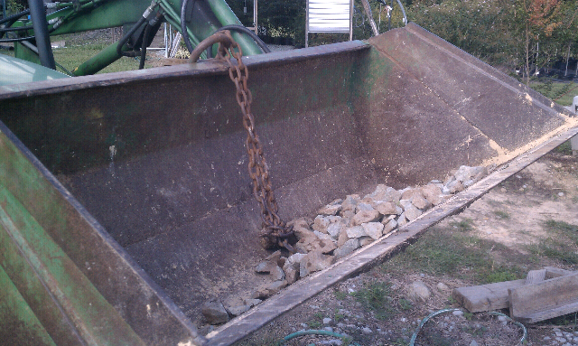

The bucket width is 4' 6 1/2" left to right. The depth 22 inches. The height (from cutting edge to top is 30 inches. The cross section has six different angles with a total measurement of 85 inches all around if that helps any. I also attached two pics. Thanks for your help.
I threw the picture on an estimating program I have. Based on what I have to go on, a struck bucket is 2/3 cubic yard (.66) (18 cubic feet)
A heaping bucket (again - this is a guess), but based on my program - 22.5 CF or .83 cubic yards.
Hope this helps.

Depmandog, somehow or another with my assbackwards math I got .83 as well so I'll just call it 3/4 of a yard. I liked the idea of dumping into the wheelbarrow also. Thanks to everyone for your help on this.
