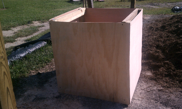

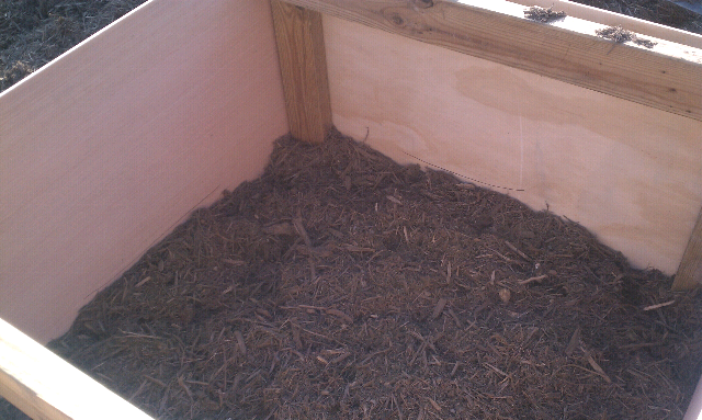

Built a one cubic yard box (no jokes on the lack of my building skills, please). Add one scoop of mulch and it comes to...

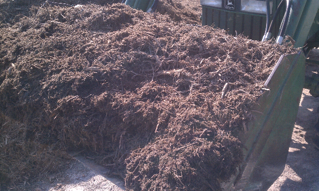

Just a bit over half a cubic yard. Only 17 inches from the top after leveling it out but not packing it down. Call it a half yard I guess.

Carl_nh got it right at half a yard. You're the next contestant on the price is right. Come on down.

My Stoll FC 350 FEL has a 54" bucket that is not as deep as yours...
Stoll classifies it at 1/3 cubic yard...
The extra depth of your bucket has increased your capacity to 1/2 cubic yard...
Good job on getting the exact amount...
